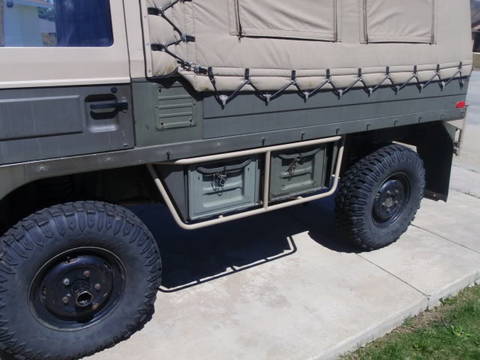

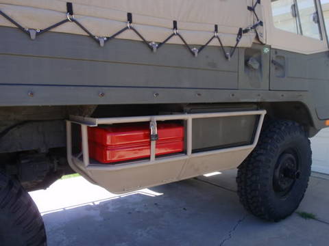

Just for reference to show his work here is the other side
Battery/Toolbox guard (not my truck): Gas tank guard with extra storage (closed): Link to original posters thread (Bruce Berger) with some comments: viewtopic.php?p=30536#p30536

The tan guard with the extra storage below the jerry can was designed for use with 710 and 712 pinzgauers. I charge $780 with semigloss black powder coating. They mount on the existing truck hangers and have an access hole for the drain plug on the stock tank.
Custom colors such as RAL 6014,7013 etc. will cost extra. I can build them while I am on tour or when I return home. Current return date is Feb.14

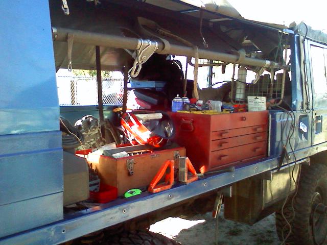

got my phone to act right. here are a few pics of what has been going on here.
Re: West coast fab tour 2014

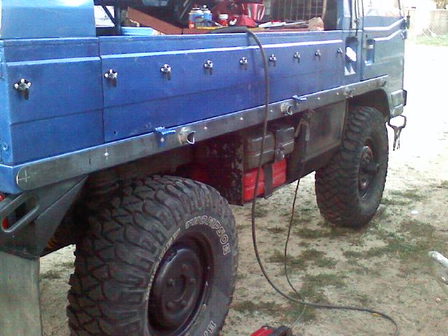

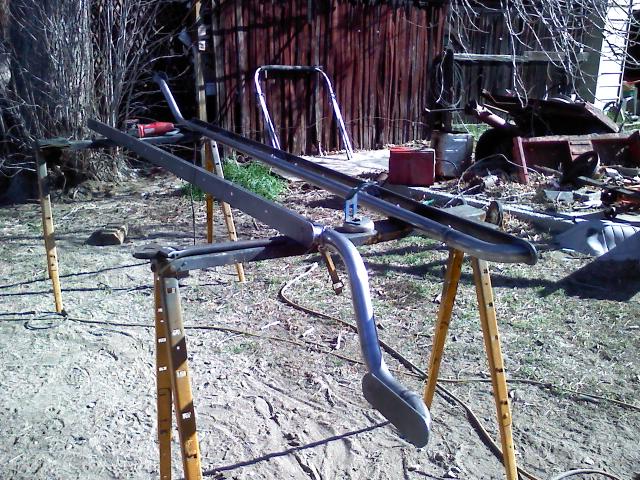

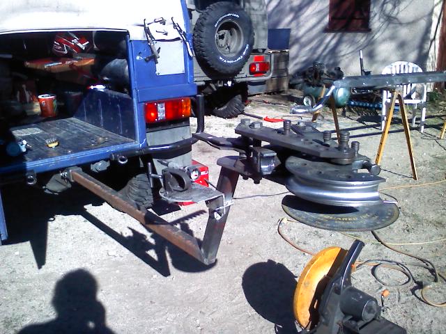

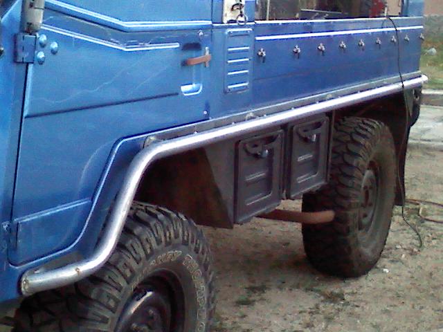

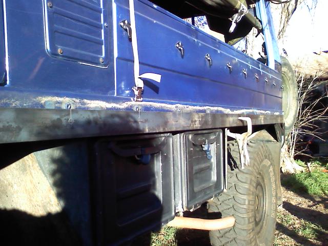

finally getting some work done.

Andre you most likely already know of these hole finders and they may not work for your applications, however in case you've never seen them.. i frequently had use for them when I worked on aircraft structures. They make it fast and easy to insure mounting holes like on those side rails are in the correct place, they eliminate the educated guess work.
