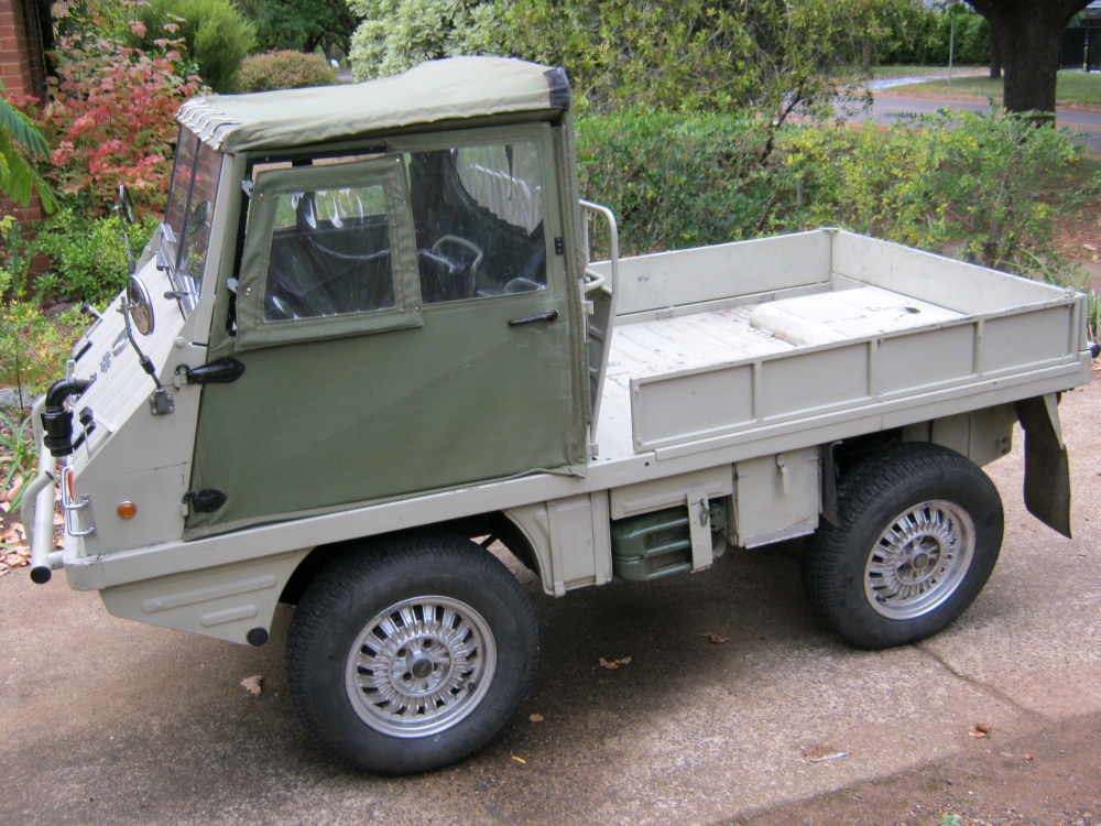

I am trying to order some new rims for the Haffy which could open up tire selections. Here are the questions OEM had:
Thank you for visiting our website. We do not have anything like that sitting on the shelf, but we can certainly build a 14" wheel with a 4/98 bolt pattern and 10mm offset. How much does your Haflinger weigh? What width of wheel do you need? We'll also need some information regarding the hubs and brakes if we are to build a wheel. Let me know what you're looking for and we will work out the details.

What would I reply with for the wheel width?

14" steel fiat wheels fit vs building custom (or alloys)
But I would say 5-6" for width depending on what tire your thinking of

There are plenty of 14" Lancia, Fiat or Alfa alloy rims around that work well on the Haffie without modification. Most of these are 5" wide.
You can fit Maxxis road legal mud tyres on these plus there are plenty of M&S tyres as well.
Garry

TechMOGogy wrote:Just remember that if you go with alloys you will need to get new nuts - lug-centric.
It depends on the alloy wheel - the Fiat ones I have on mine take the standard Haffie wheel nuts but other wheels as you say may need different wheel nuts.
You can get suitable nuts from http://www.brandsport.com/gorilla-lug-n ... AuvD8P8HAQ
My Haffie with the Fiat 14" rims

I mean this with the most respect possible - I'm not a huge fan of those wheels. They seem a little too fancy for the vehicle, and draw my attention away from the cool stuff - The awesome doors, pristine top, the color of the Hafie. Its a to each his own type of scenario.
I wonder what they would look like sprayed black?
