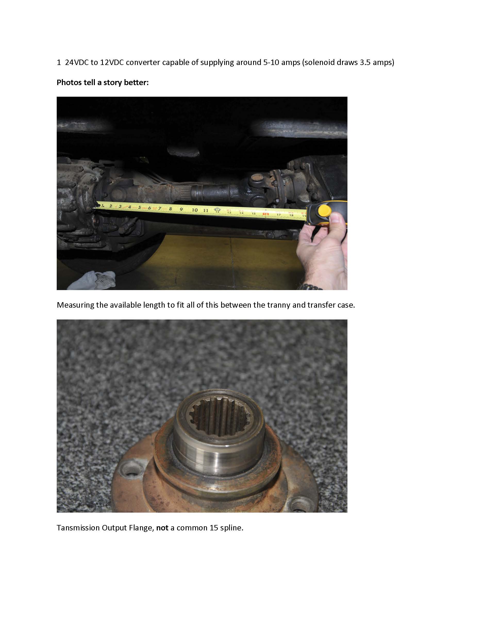

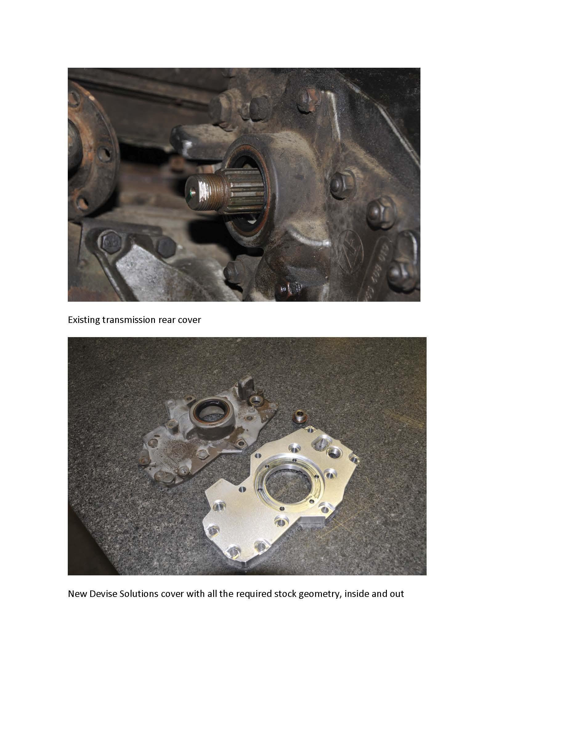

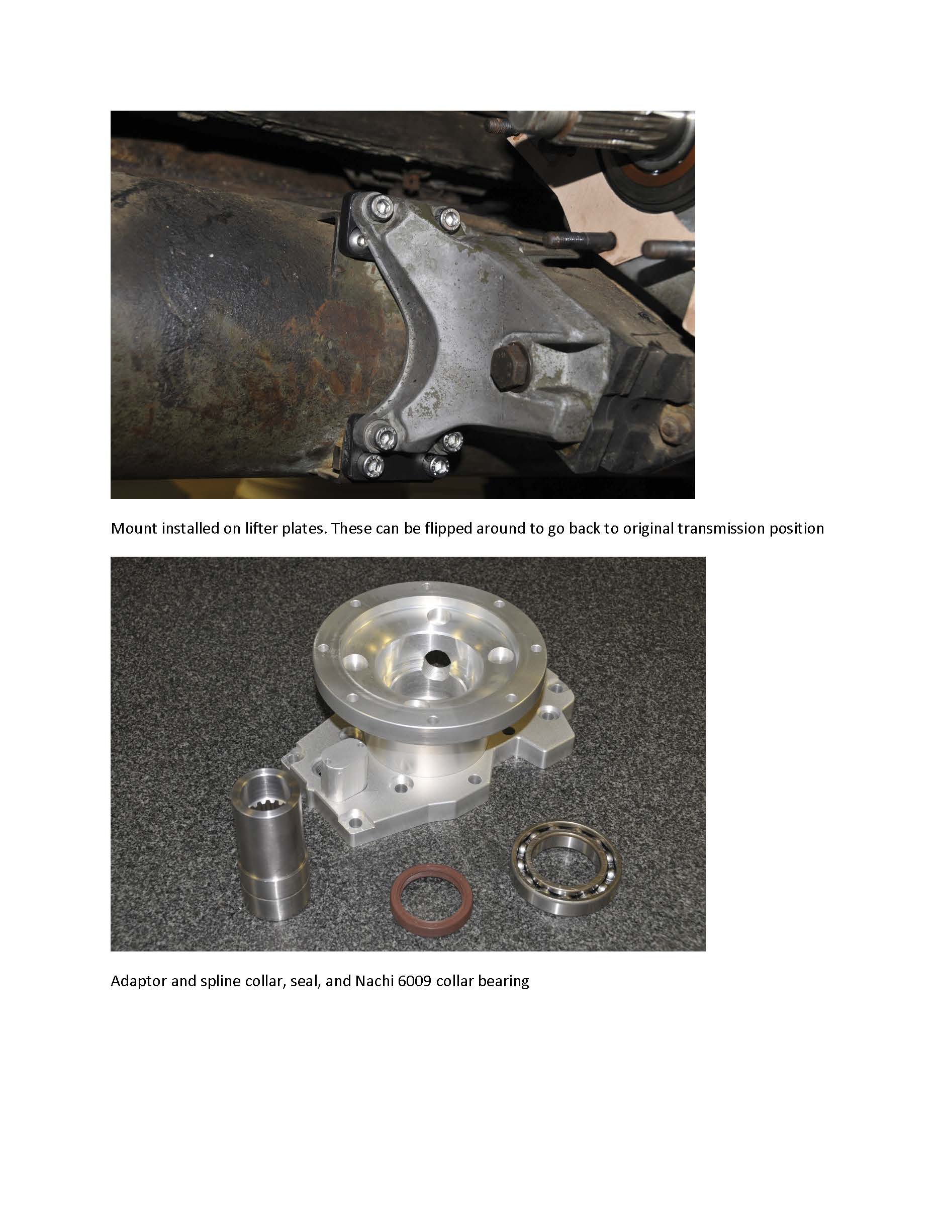

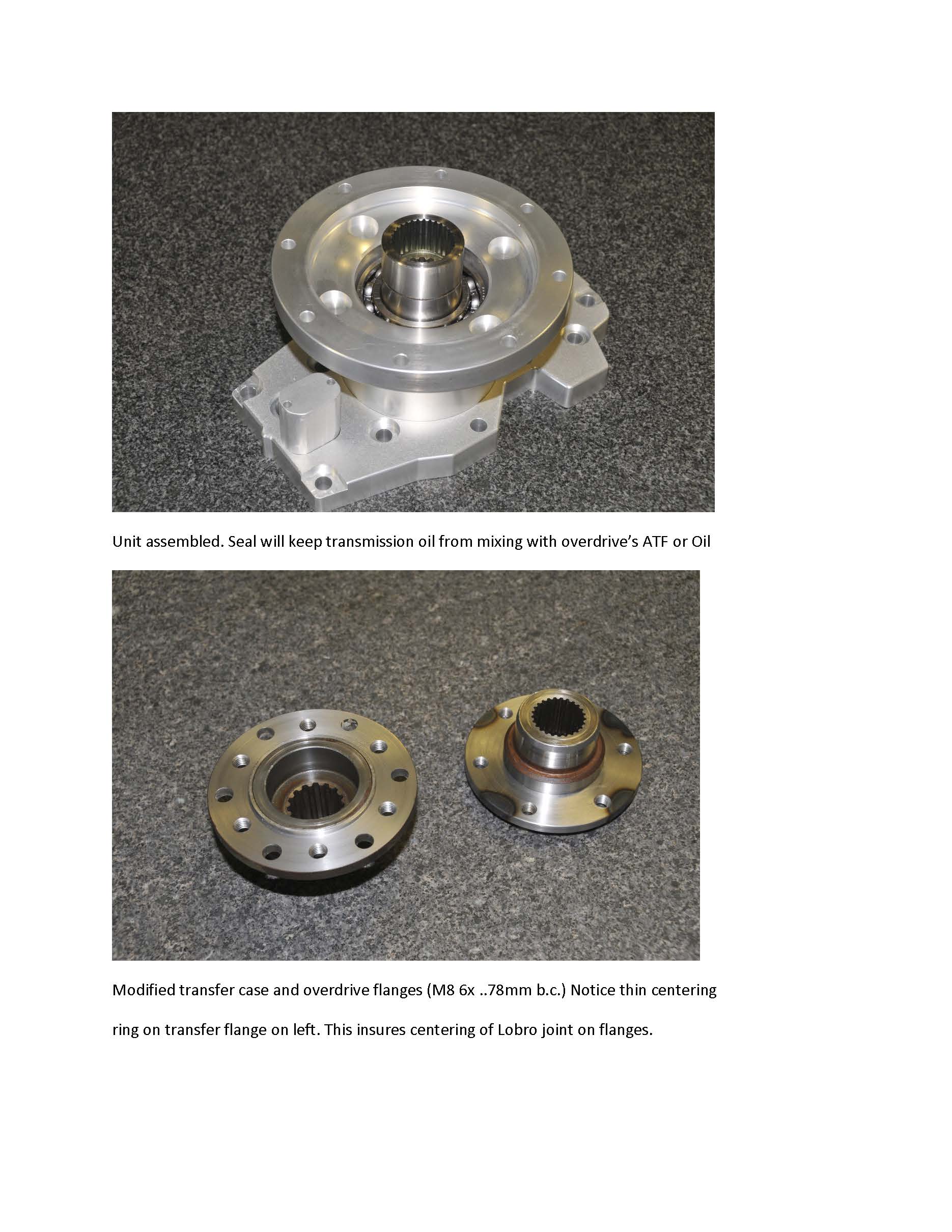

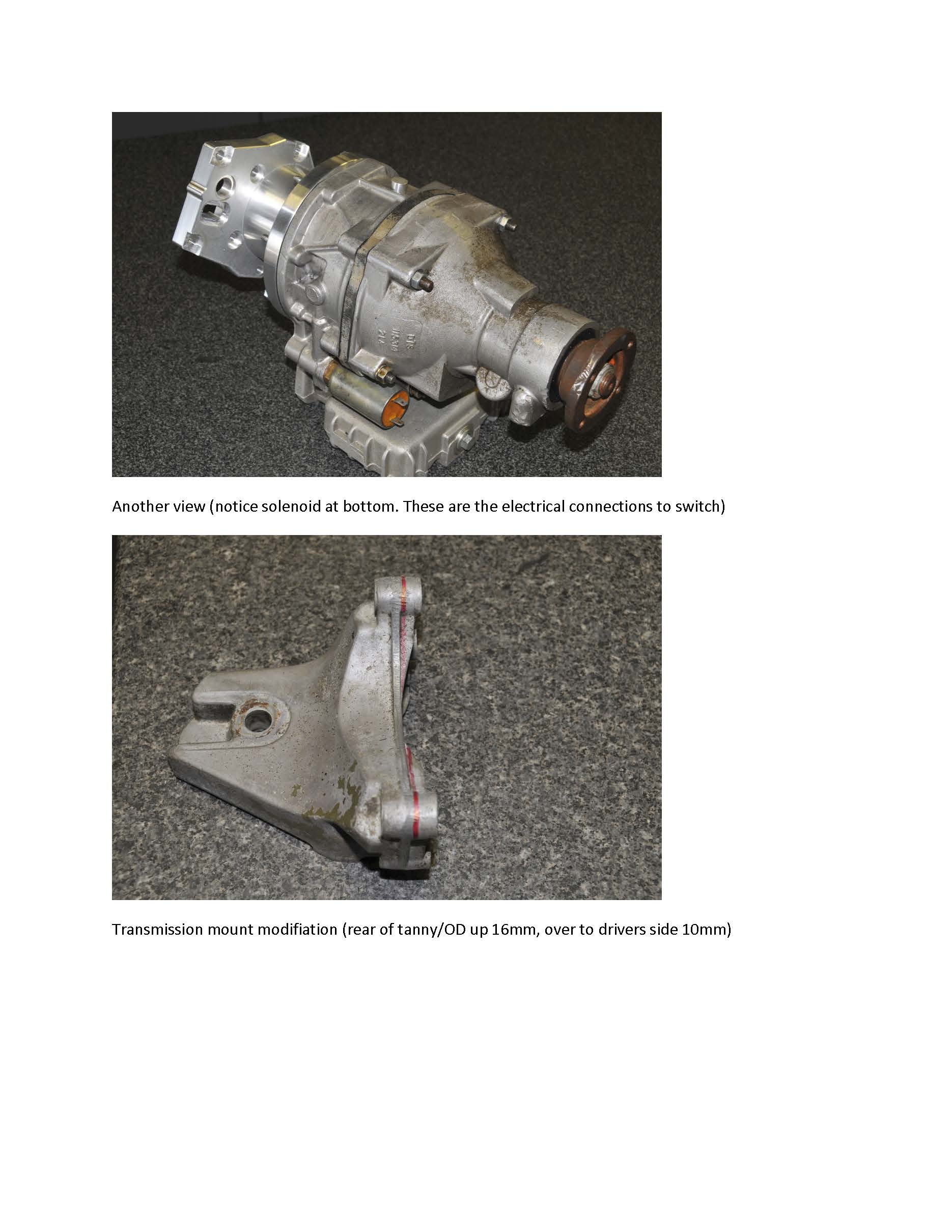

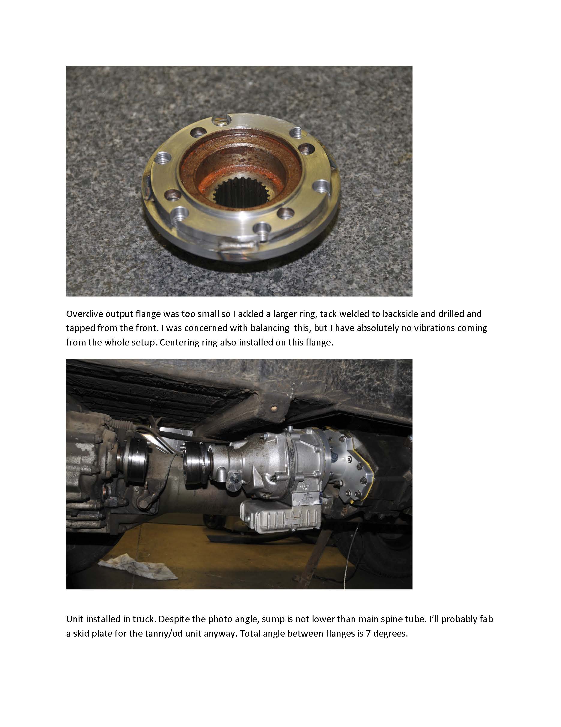

Pinzgauer 710 or 712 over_Page_01.jpg (223.86 KiB) Viewed 10610 times

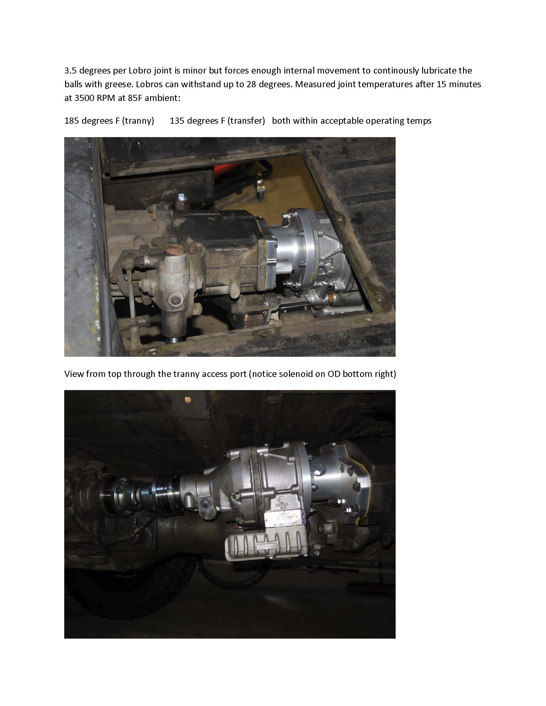

Pinzgauer 710 or 712 over_Page_02.jpg (182 KiB) Viewed 10610 times

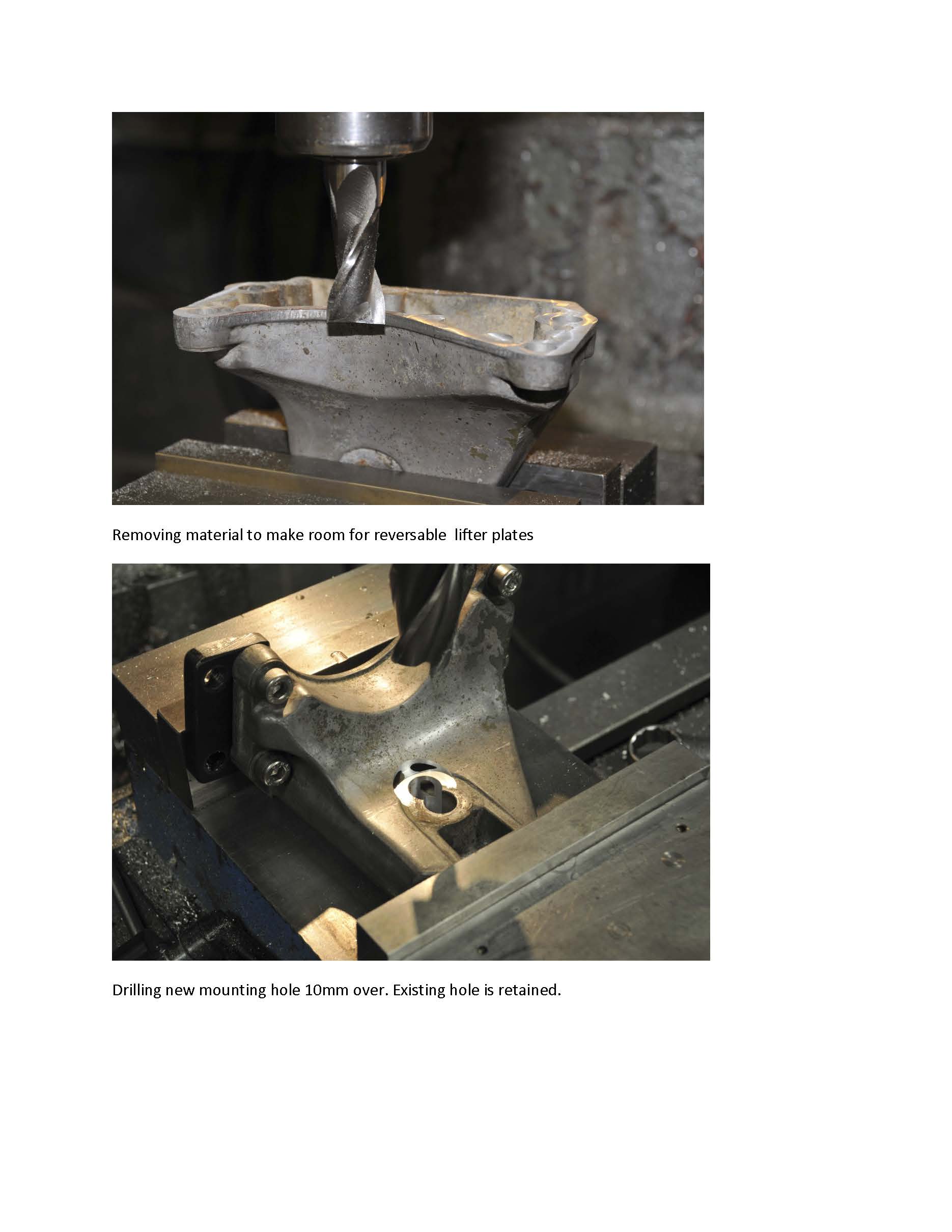

Pinzgauer 710 or 712 over_Page_03.jpg (222.14 KiB) Viewed 10610 times

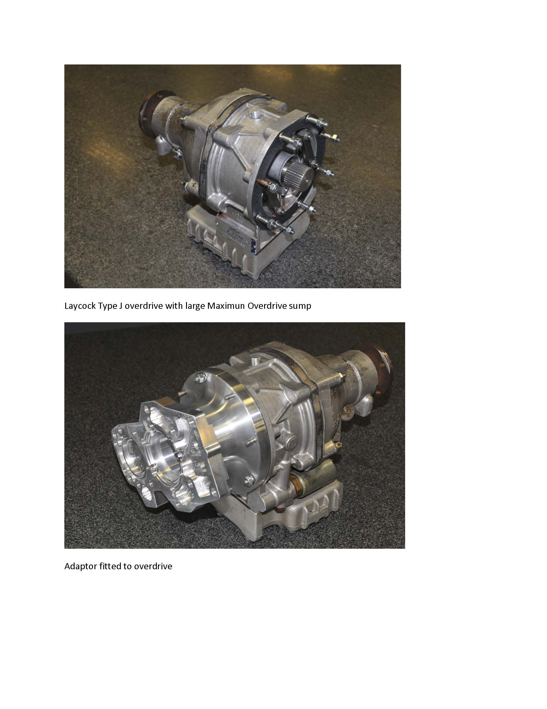

Pinzgauer 710 or 712 over_Page_04.jpg (239.71 KiB) Viewed 10610 times

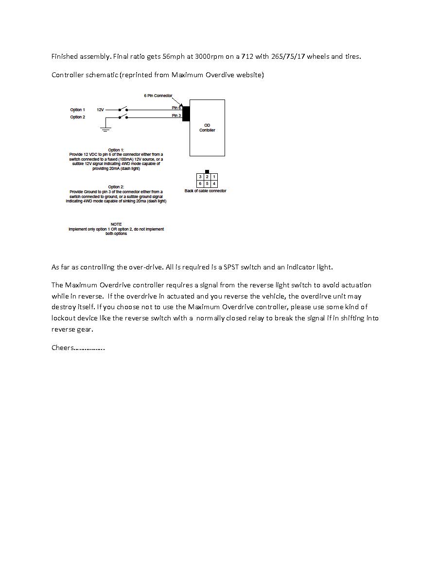

Pinzgauer 710 or 712 over_Page_05.jpg (208.42 KiB) Viewed 10610 times
Maybe this will work....next posting will have the rest

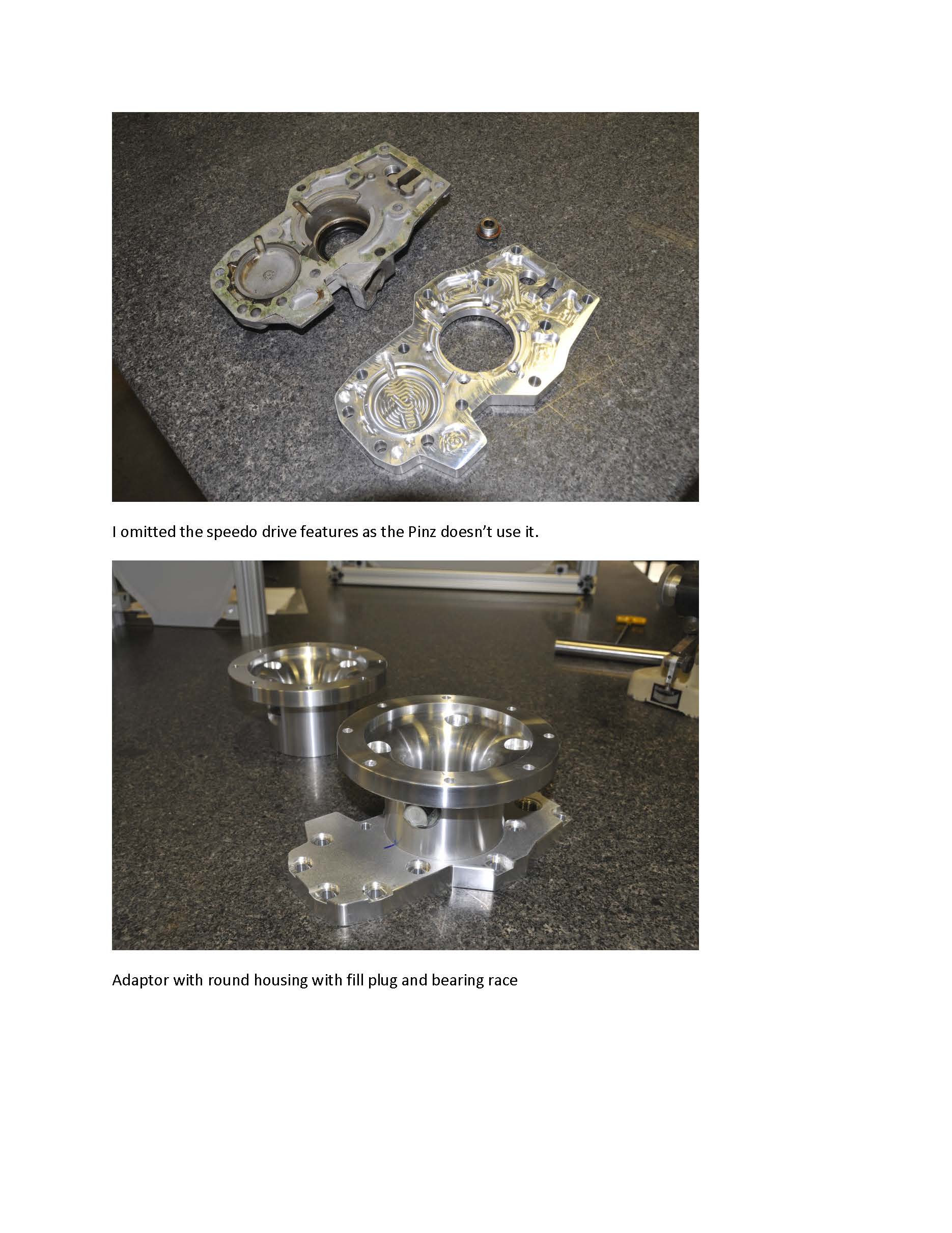

Pinzgauer 710 or 712 over_Page_06.jpg (221.33 KiB) Viewed 10609 times
Pinzgauer 710 or 712 over_Page_07.jpg (165.19 KiB) Viewed 10609 times
Pinzgauer 710 or 712 over_Page_08.jpg (237.45 KiB) Viewed 10609 times
Pinzgauer 710 or 712 over_Page_09.jpg (259.53 KiB) Viewed 10609 times
Pinzgauer 710 or 712 over_Page_10.jpg (243.46 KiB) Viewed 10609 times

Impressive work!

This is so impressive and professionally presented. If it was not for the cost I'm sure many owners including myself would add this modification.

The execution of this seems top notch. Definitely a bit more to it than just the adaptor plate. Someones got some nice fabrication and design skills. Looks well thought out which shows in the quality of the diagram and instructional writeup.

This could become a great Pinz upgrade once it has more test miles on it.
Great design, machining and engineering skills!

Thank you all for the kind words. These are the projects I love to develop on my off ours. As to the ability of the Pinz to utilize this OD unit, I had the hand throttle set and maintained 60 mph for over 15 minutes. Dead flat, no headwind. I'll continue to test and report. I'll workup some costs for the adapter in small runs. These are not money makers in the grand scheme of our business, but if I can payback in a small way for all the assistance I've received from these forums, that would be great.

On the last page it states not to engage the overdrive in reverse. I also read this in the owner's manual for my MGB back in the 70s. What would happen if overdrive was engaged in reverse? I never could get an answer to that question, and have always wondered.
