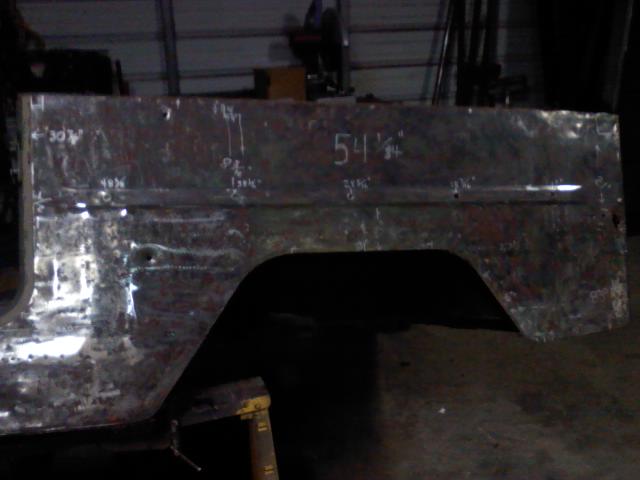

taking hard measurements.

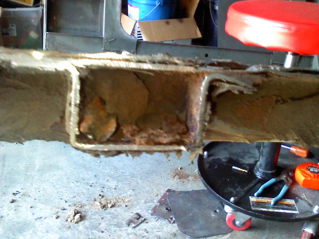

Been making progress if you count uncovering more rust to repair.
After closer inspection, I found other repairs that were done with thicker material than original. The original will continue to deteriorate due to it's salt air exposure. So to stop the problem from continuing, the owner and I opted to re-skin the bed with 18ga. Galvanized steel.

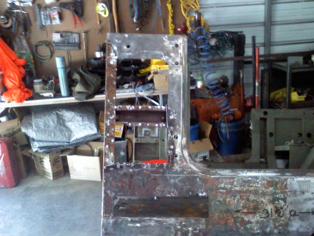

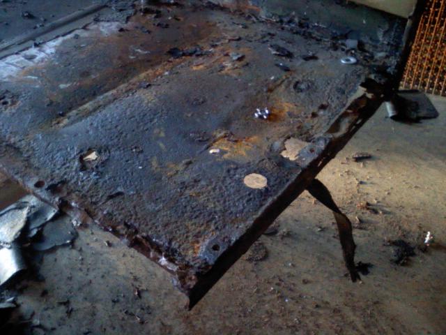

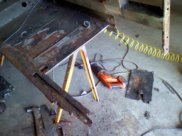

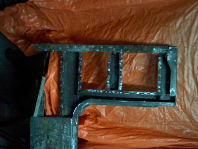

cut out floor rust.  many channels were FULL of debris.

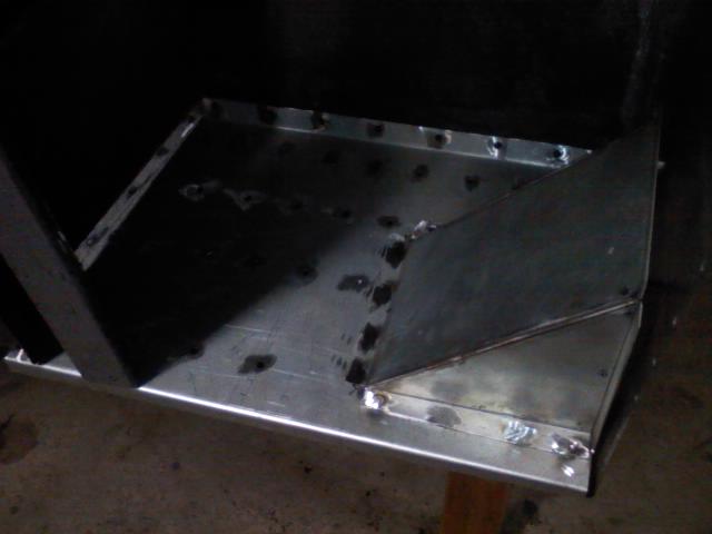

new mating surface made with thicker material.

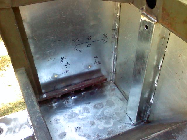

After dissecting the old skin from the support channels, they get ground flush and treated with Por-15.
prepped for new skin

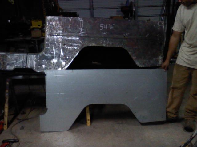

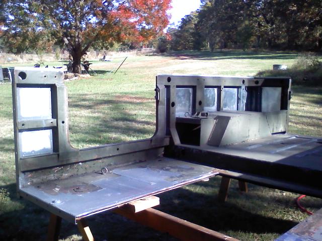

I am replacing the skins one section at a time to ensure the lines stay true to each other.
new metal is layed out and tested for fit prior to cutting out the old metal.

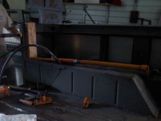

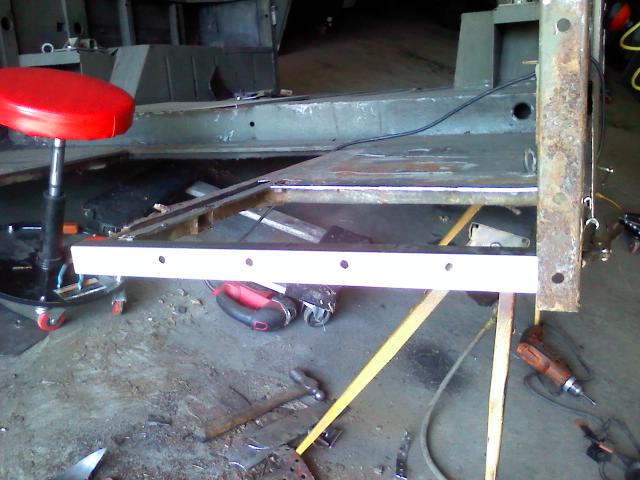

Had to press the rear door pillar back to square first

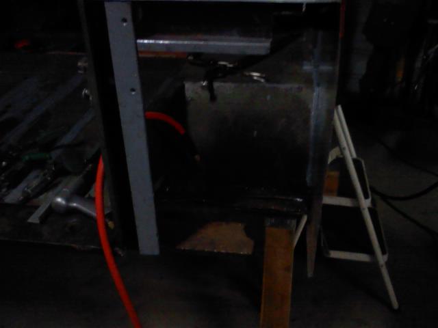

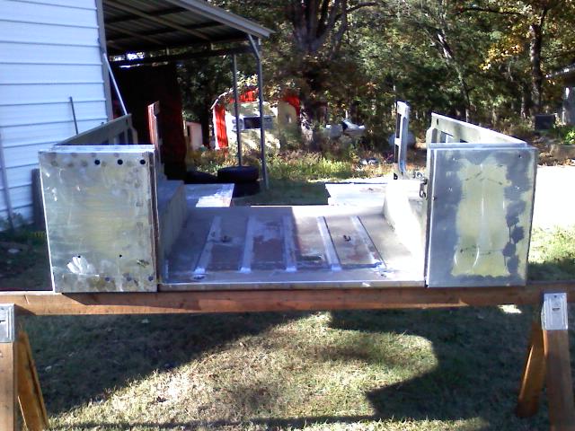

I removed the rear panel to make it easier to replace the floor.
I also made sure to modify the rear for a proper filler neck and cap.

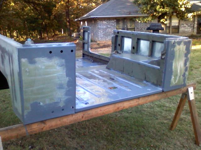

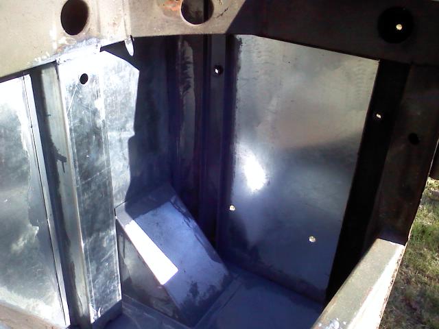

here's the cab, re skinned and sealed with POR-15 to preserve it until it goes to paint.

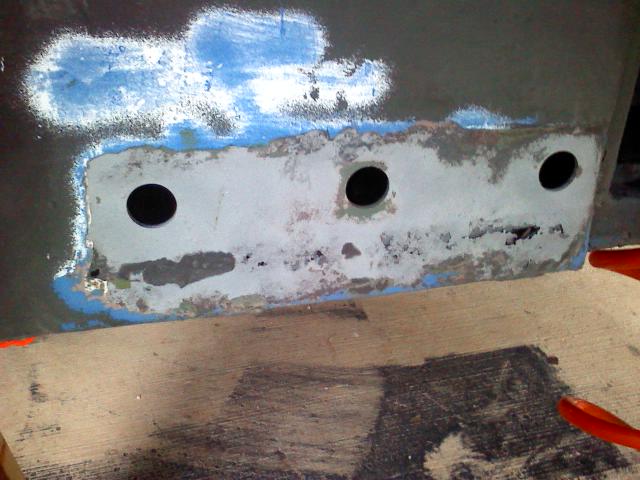

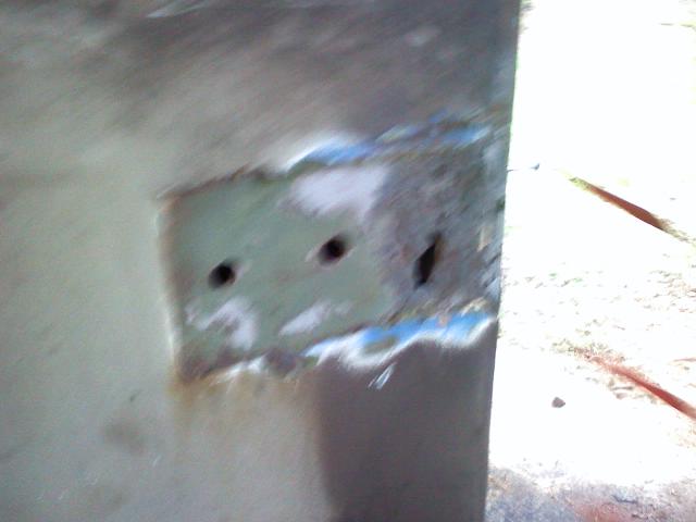

Thats really interesting how you mounted the cage using the existing rub rail spots. I hadn't considered that. Is it strong enough to survive a flop onto the side?

The points that weren't supported by channels, were reinforced from the inside with thicker metal that was supported vertically. I built the cage to be self supporting and I mounted it to the front and rear bumpers(frame supported). Where it mounts to the body just helps minimize flex lengthwise.
