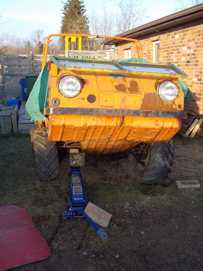

This is as bad as trying to lift a Pinz!
pain to lift.jpg (360.11 KiB) Viewed 10152 times
Working a Haflinger is a great way to avoid boxing day shopping and enjoy the 11 degree (52 F) weather!

So you've started the long task of dismantling, hope you got a suitable shed to put all the pieces in whilst you fix things.
Depending on where you cut the wires, you could put in a multi-way plug and socket and just plug it together when you put the poor thing back together.
Start making a list of things you need to buy / fix / swap / paint as you take it apart, that way you won't be waiting for some part to arrive when you start putting things back together and find you had forgotten there was another bit involved. It will also help you plan which things to tackle first and might even give you a time scale for getting things done,
John

If the Haflinger is going to stay where it is whilst you dismantle it, I would suggest you buy a 8 foot by 4 foot sheet of shuttering (weatherproof) plywood to stick underneath it and so allow you to jack it up without sinking into the ground and to have a nice surface to lie on and put things down on without risk of losing them into the grass!
If you could manage two bits then you can get the whole wheel base off the grass. Then a smaller piece which you could use as "lie on" board along which ever side you are working on.
I have spent too many hours lying in damp grass under vehicles - not nice! You could also put a "pop-up" gazebo over it if you don't suffer from high winds, horrible having water drop in your face as you come out from under the vehicle. :wink:
John
