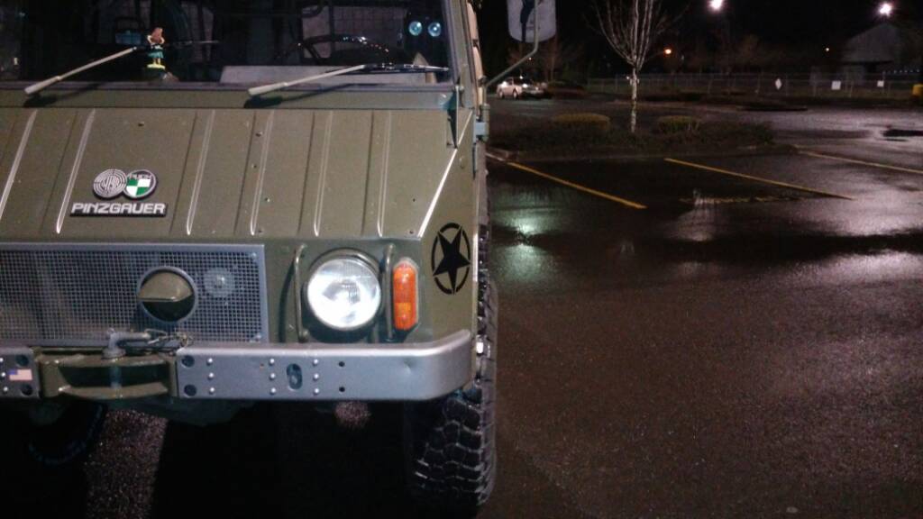

Looks great - You'll probably get some spray on the sides...
Re: Disc brake conversion
The Washington motor vehicle code WAC 204-10-022 says:
"Fenders: All wheels of a motor vehicle must be equipped with fenders designed to cover the entire tire tread width that comes in contact with the road surface. Coverage of the tire tread circumference must be from at least fifteen degrees in front and to at least seventy-five degrees to the rear of the vertical centerline at each wheel measured from the center of the wheel rotation. At no time can the tire come in contact with the body, fender, chassis, or suspension of the vehicle. Street rods and kit vehicles which are more than forty years old and are owned and operated primarily as a collector's item need not be equipped with fenders when the vehicle is used and driven during fair weather on well-maintained, hard-surfaced roads."
Having lived in Everett for almost two decades, you will very likely be violating this statute at least part of the time since it is relatively rare that you will be driving "during fair weather" and not all the tread width is covered by the body. It depends on how hard-core the police can be; I have heard of people getting tickets for insufficient fender coverage (not necessarily Pinz, or in Washington). Just be forewarned.
But it looks great!

We have a similar law in the UK. The vehicle as presented in the photo there would (should!) fail the MOT (annual vehicle test). Widening the stance would require fenders/mud guards to cover the protruding wheel. In the UK this could be as simple as plastic mouldings.

Same sort of law here in Wis. too. I got nicked by it long ago with a CJ5. 'Course, it's easy to find flares for Jeeps. But they're often just plastic as well. It works.

The law Jim was referring to is actually a federal DOT law, and are usually used verbatim in most state vehicle code laws so they are enforceable by local LEOs.
Even when Steyr introduced the TDs with their wider track, the rub rails were widen to meet the same laws in Europe.

I'm running 285's on 8" wheels, I think I am just at the edge of being OK, but just barely.
By the looks of the disk brake conversion -- rotor position vs drum position, eyeballing it,
looks like it is adding up to 1" to 2" of additional mounting/track width per side.

All good feedback. The Disc Brakes definitely add to the width, the additional back spacing added to the rims to afford a little more clearance for the brakes exacerbated that..
I am working on a set of revised rub rails that will incorporate some additional wheel coverage, which will help. Additionally I will primarily be using it for Search & Rescue on active missions so am unlikely to get much grief for minor infractions. We'll see... :wink:

The plus of wider track is it reduces the risk of your Pinz going to sleep (on it's side) :D
The negatives are mud in your face, a citation, but also reduced body clearance as your
springs will be more compressed due to a longer moment arm :( Even with 285's with
8" wheels, I see a difference on mine. Next set of tires I'm going skinnier :wink:
