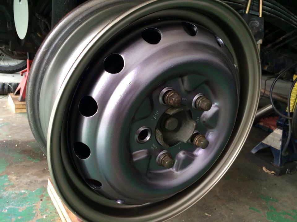

Its worth noting that Sprinters in Europe come typically with 15 inch wheels - so that isn't probably a good option in Europe then. G-wagen steel wheels or the real TD Pinz steel wheels would be the best option there - they have a bulge in the outer section of the wheel center to give extra clearance for the caliper. But, since they are 5x130, they would require a wheel adapter to be used.
TD 16 steel wheel 2.jpg (78.14 KiB) Viewed 7911 times
