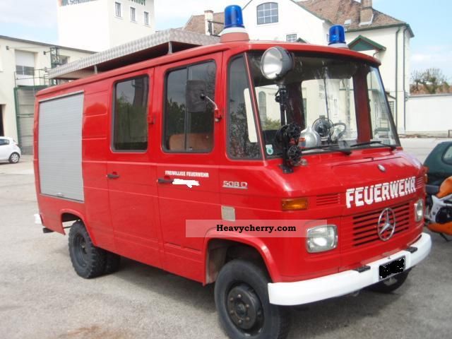

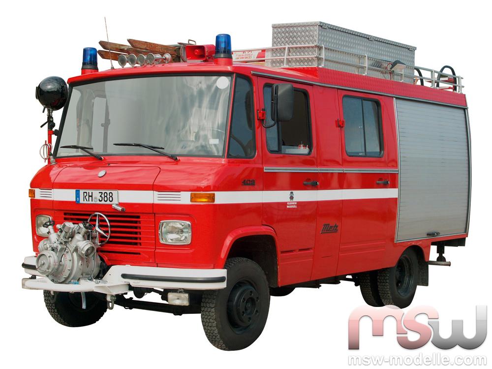

Haf-e wrote:Mercedes 408?
If it was .. this is what it would look like...but naah! mine is different..:mrgreen:
408 / 508 or even 608 looks cool though..

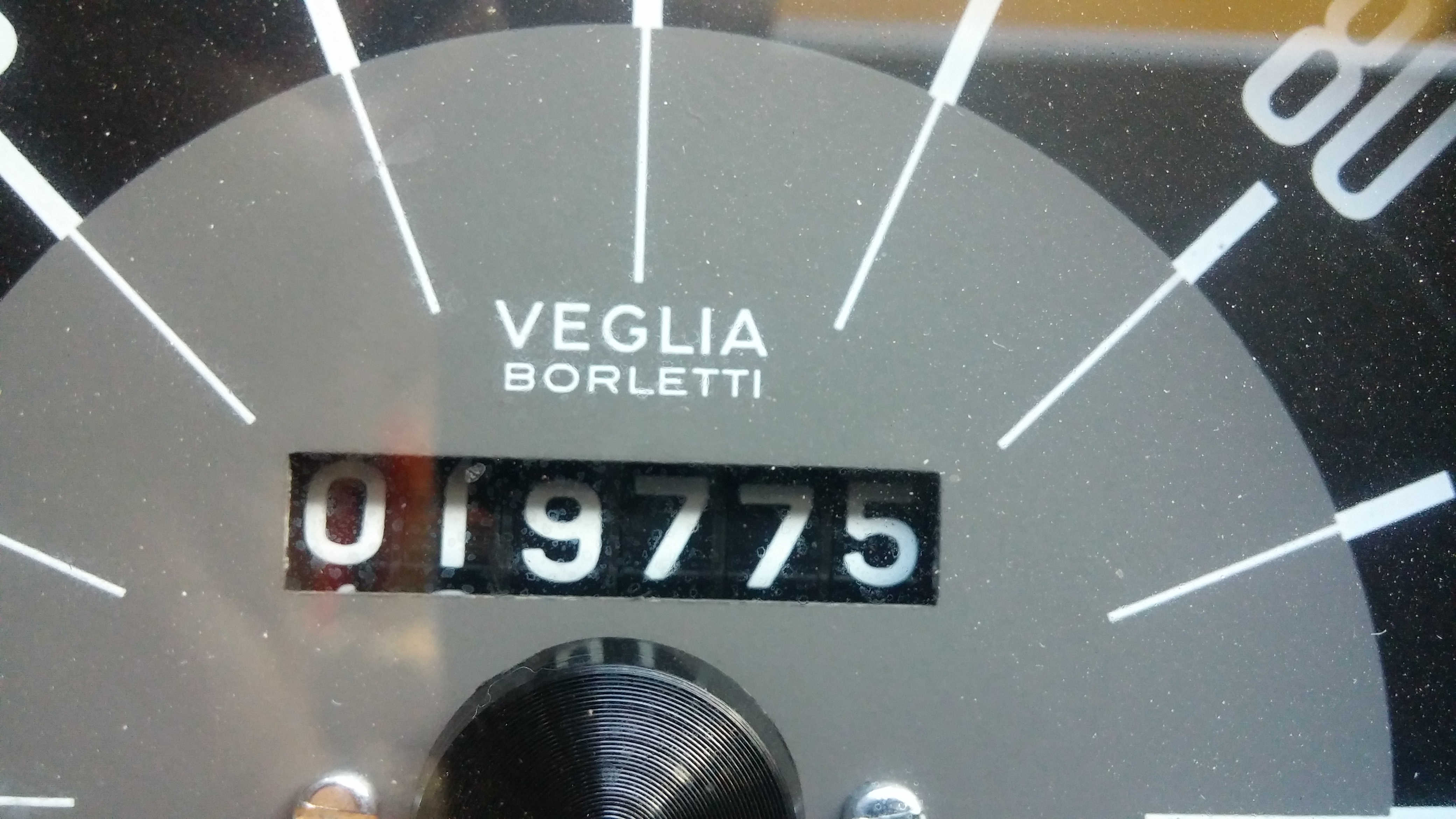

It is Saturday morning .. I have a right & duty to be on this forum..time for another clue..
Clue #15 Vehicle is European..so this is how the speedometer looks..sorry should spit cleaned the glass..
Shall post pictures of it when taken in dark at nights absolutely stunning & ghostly..
Veglia Borletti made some of the most beautiful gauges..as a casual search would show.. mainly for Italian cars & trucks..wink wink
Disclaimer : the gear box [it is a ZF] was used by Rolls Royce & Maserati [ too complex to be considered a hint..]
Re: Inappropriate posting ?
Must be an Magirus-Duetz post merger into Iveco?
Probably more like this...
I really like the big windshield and extra small windows above the doors on these vans - they are also like that on the later Mercedes Vario vans...

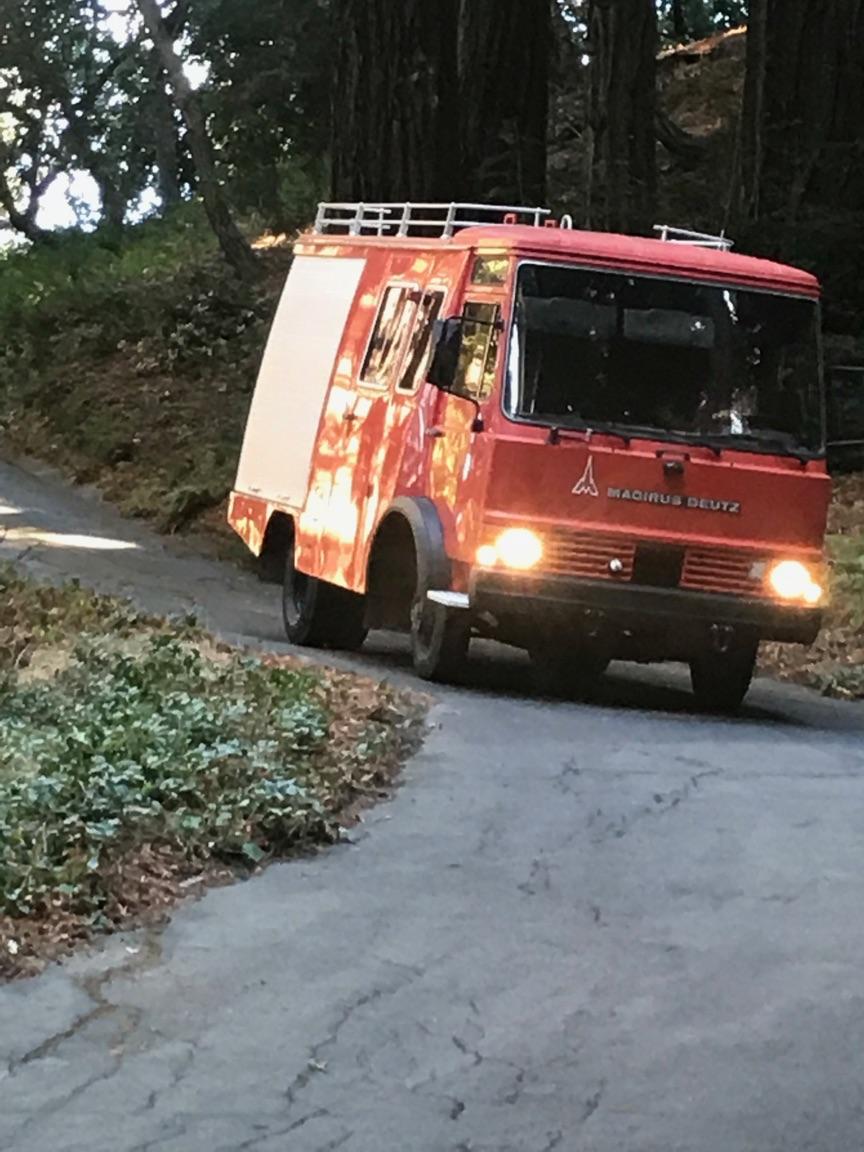

Post by acebee »
Quite close ...actually difficult to guess model anyway..
But you are so correct...
Magirus Duetz.. :oops:
Will update with pictures later tonight..

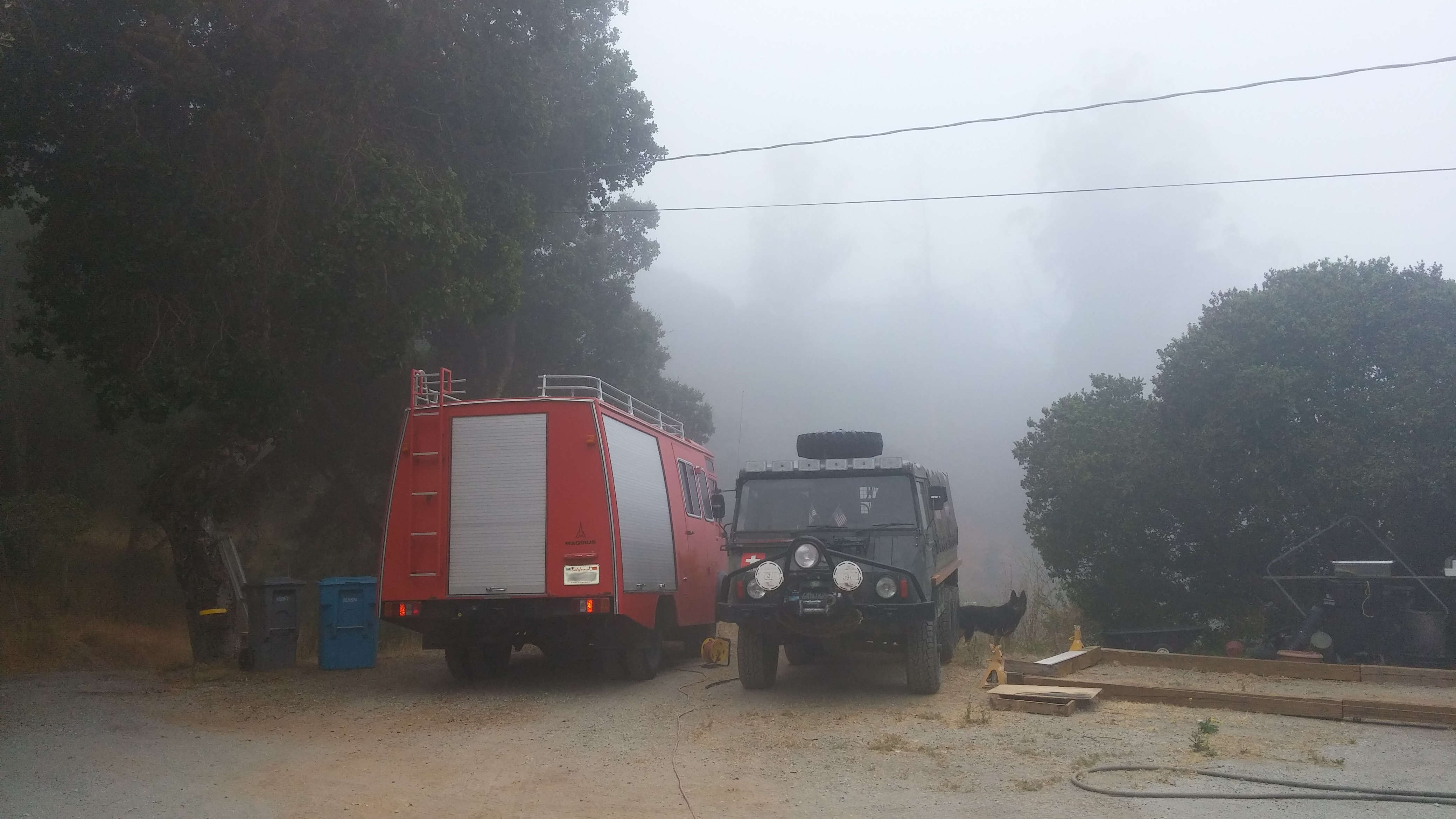

That's acebee coming down my driveway, darn I have to get that repaved.
Puts the 712 in perspective Eh !
