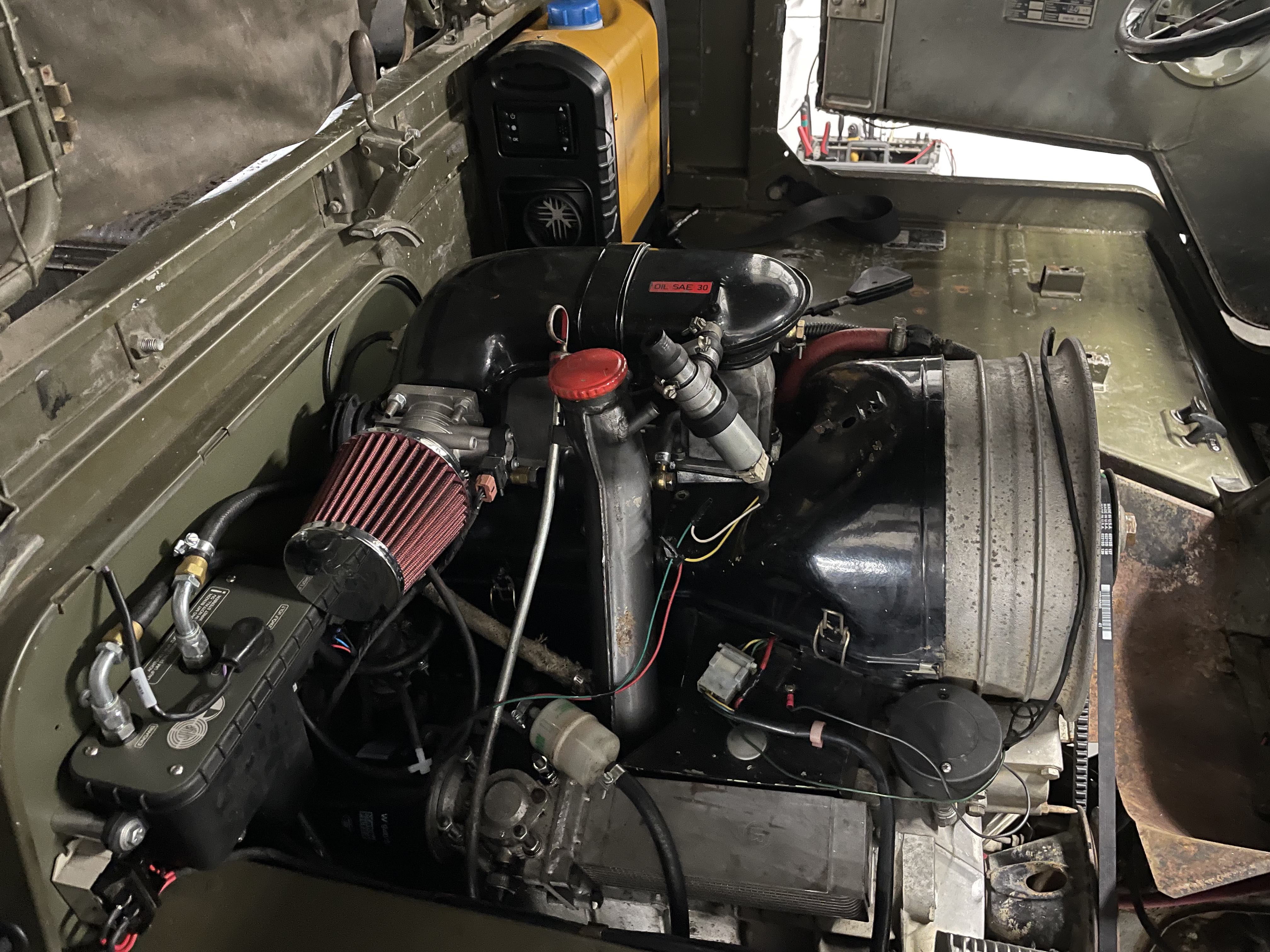

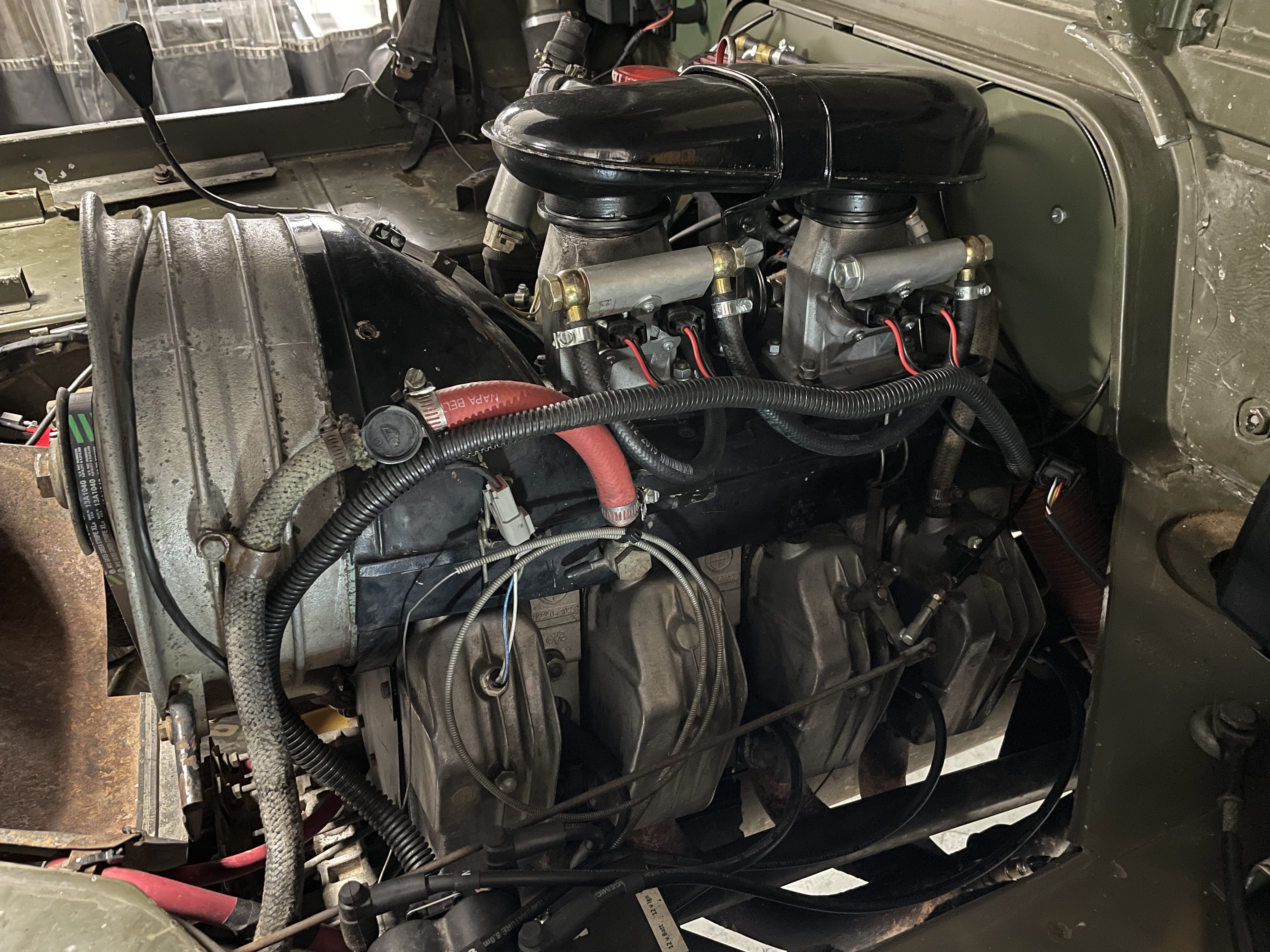

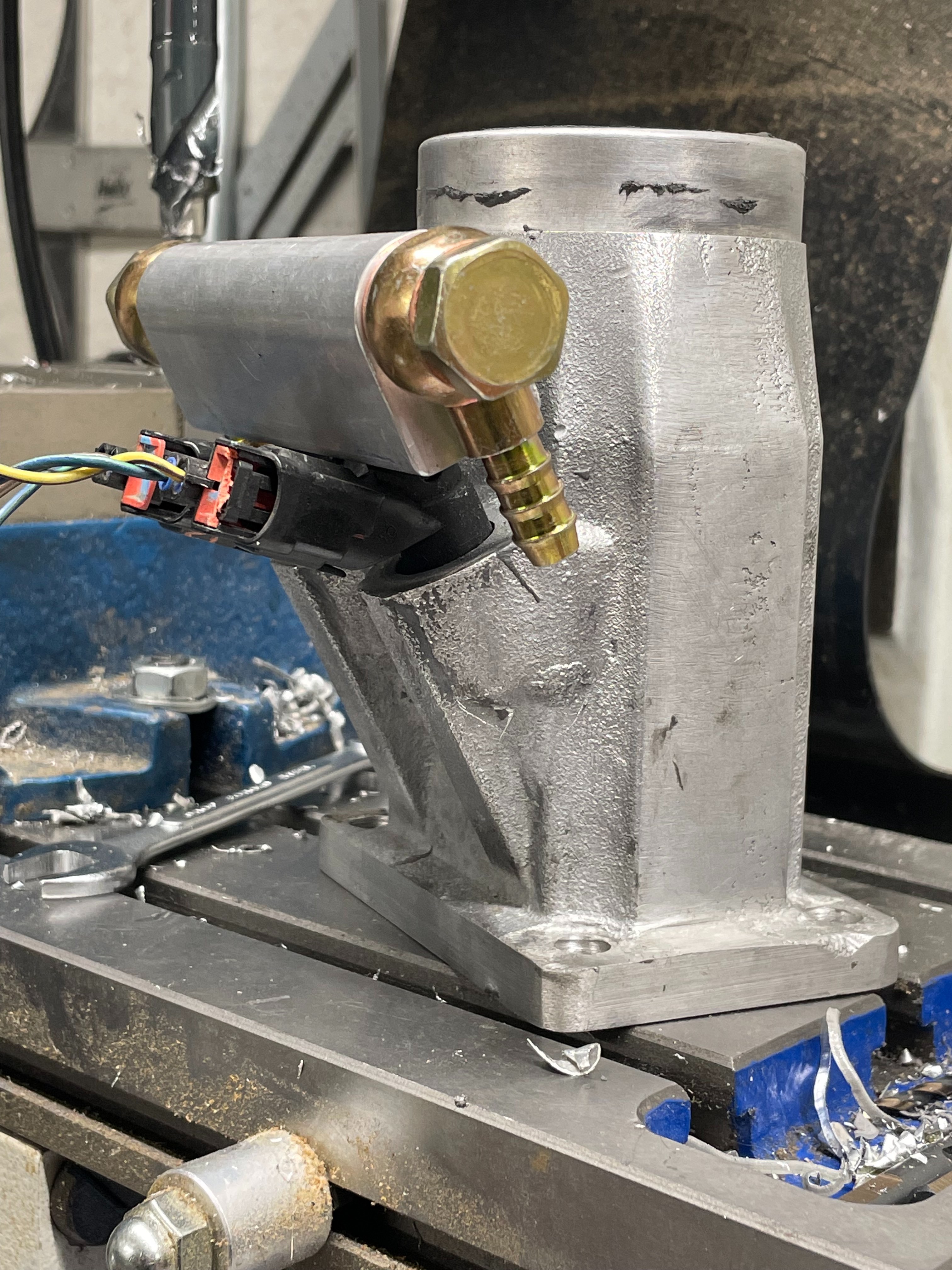

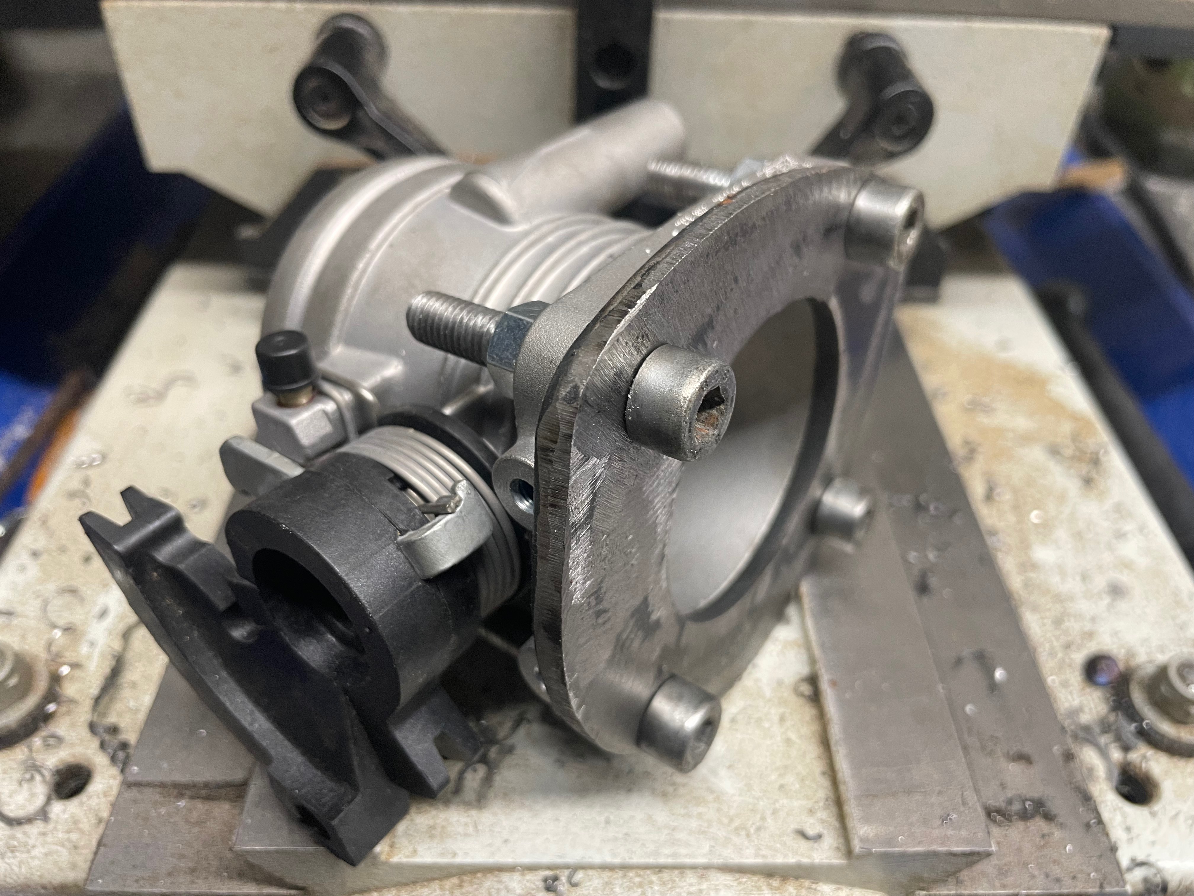

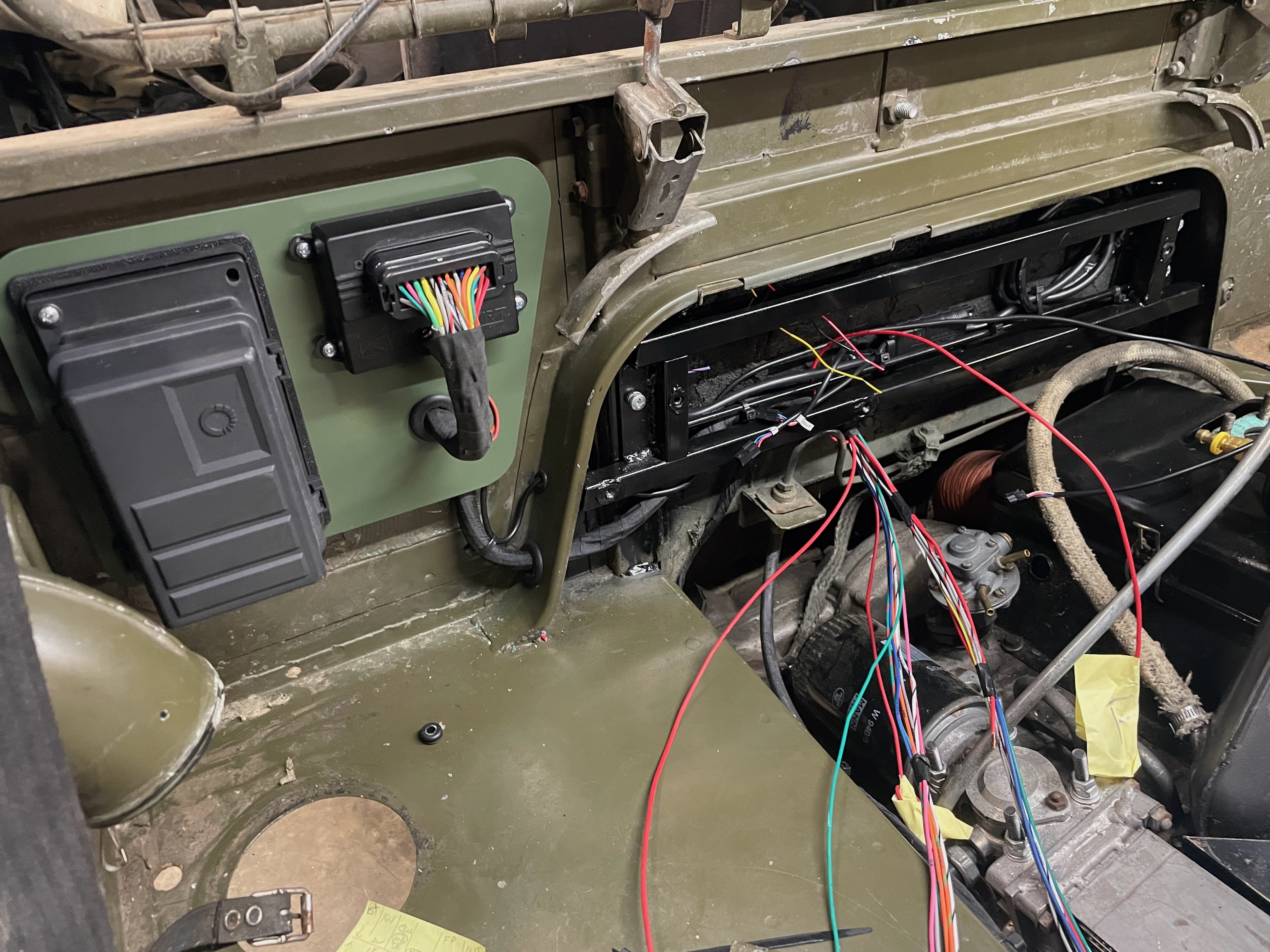

I'm back on it. Took a break when work picked up again. I quickly realized that although the mechanical system was awesome in so many ways that I wasn't ready to cut up the intakes and run fuel lines under the heat shroud and stopped working on this route. I learned a lot in the process so that's a win! I decided to modify the bits I already made to accept a more regular injector and use a Microsquirt to control things instead.
First off a new fuel system.. I'm going with the oem pump feeding the Edelbrock sump/pump combo in hopes of simple and reliable fuel at weird angles. Next I needed injectors with a long snout to fit the previous design and found some Chrysler injectors in a wreaking yard that do just that. Yay! With a little work I was able to readapt the plenum and manifolds to EFI style parts. So far so good..

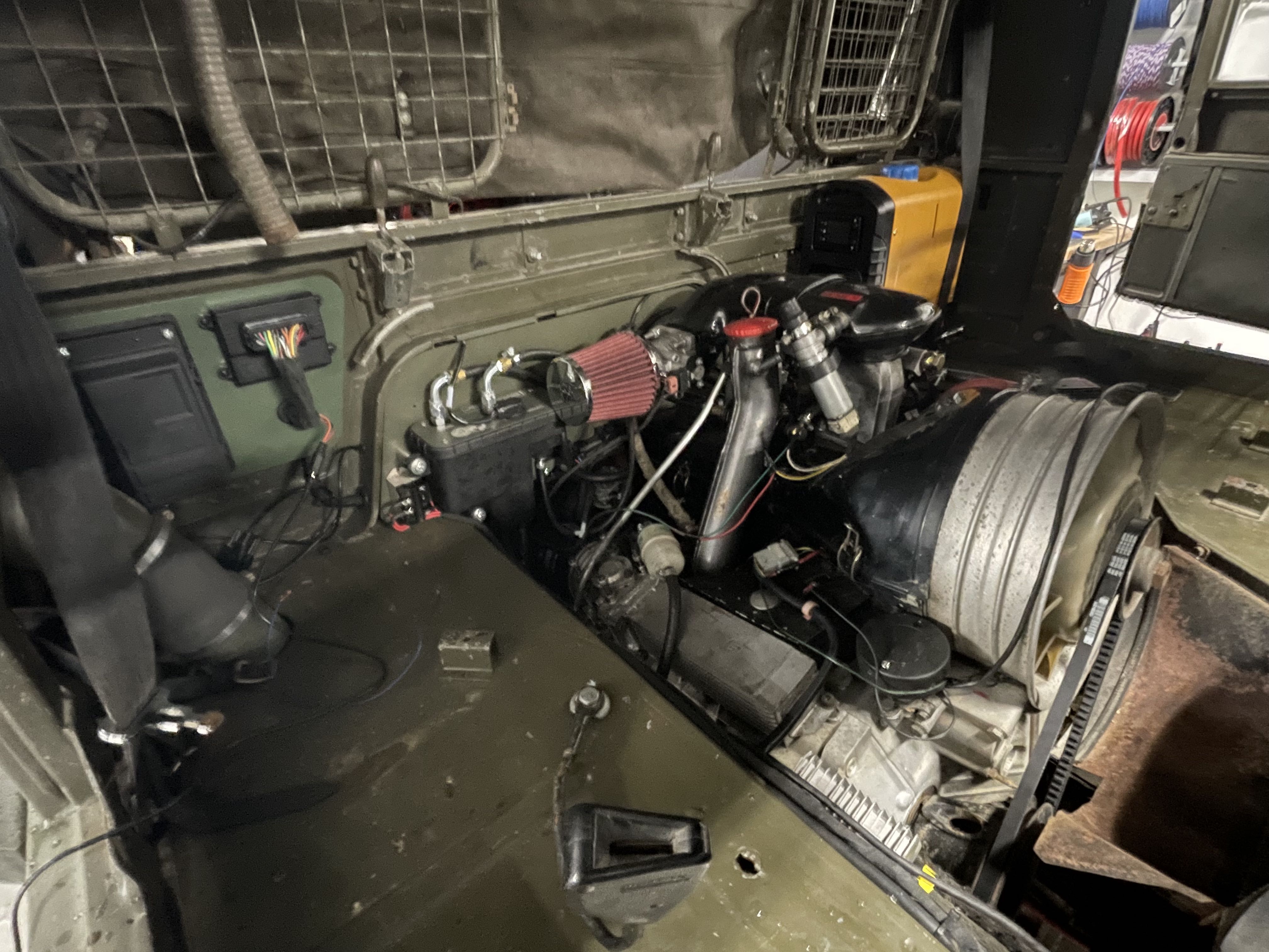

IT RUNS! I started out last weekend determined to get this thing running. There were a few bugs to work out initially but in a surprisingly short amount of time I had the harness made and all the plumbing parts installed. I primed the fuel sump, turned on the key, hit the starter button, and wouldn't you know, it started! After some initial settings for idle control and whatnotI was able to drive around my yard with a Pinz that was already running massively better than before. I've been driving it all week tuning the fuel map as best as I know how. Already I notice a huge improvement in drivability. It idles, like all the time, at every stop, without help. It starts, like every time, every day, without help except really cold mornings but that's getting better. I can climb a steep hill without dancing on the gas pedal in an attempt to get it revved up enough to have the power needed. So excited!!
Pics to follow..

Update: A little more tuning to stop fouling plugs and manage IAC behavior but after that I'm happy to report everything works as intended. Idle, starting, acceleration and all seem to work consistently. Anybody want a set of carbs?
