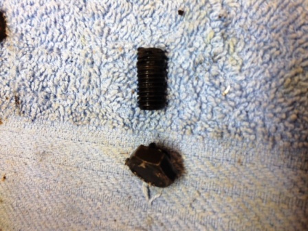

Update... So one of the two screws popped a head and busted the backing plate. Berger's post was very helpful. I have the old plate stripped and everything a part. But, the spacer on the wheel spline seems stuck. Berger's just lifted off by hand. Mine appears to be glued down. So, should I leave it alone and reuse it or replace it. I have the parts. If I should replace it since I'm already in there then what would you suggest I do to get it loose. I don't want to damage the hub/spline.

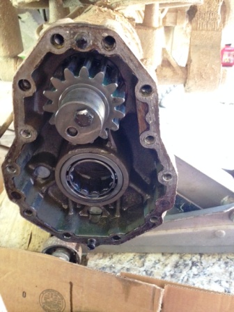

I was able to get the spacer off of the end of the hub/spline. I wound up gently using a chisel to get enough room under it to then put the gear puller on it. By reversing the feet of the puller I was able to pull it right off. I have since seated the new o-ring and the spacer. I have stripped the old backing plate of it's usable parts and am now awaiting the arrival of my new bearings. I went ahead and decided to change out both bearings that seat in the backing plate as I'm hoping I won't need to do this project on this wheel again.
Hopefully she will be back in operation by the weekend. Sorry for the delay in getting you information; but the paying job interferes with the fun one! Feel free to PM me if anyone wants a step by step of how to do this. Berger's post was helpful. I created another puller to pull the larger bearing out of the brake backing plate. But, I should have gotten another type to pull the smaller bearing. I destroyed it trying to tap it out. DON"T try and tap it from the back side. Nothing good will come of it and it is the more expensive bearing. (Just my luck.)
I want to thank everyone thus far for their input and help. I am in the middle of a project that initially scared me. But I am cautiously optimistic I will have her operational soon.
Cheers!
- Pinz Wheel Gear 004.jpg (66.13 KiB) Viewed 6944 times
- Pinz Wheel Gear 002.jpg (68.85 KiB) Viewed 6944 times
- Pinz Wheel Gear 001.jpg (68.34 KiB) Viewed 6944 times

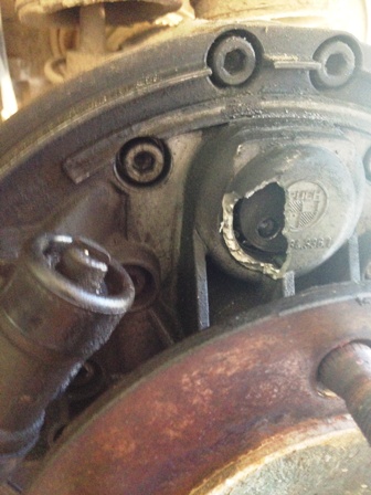

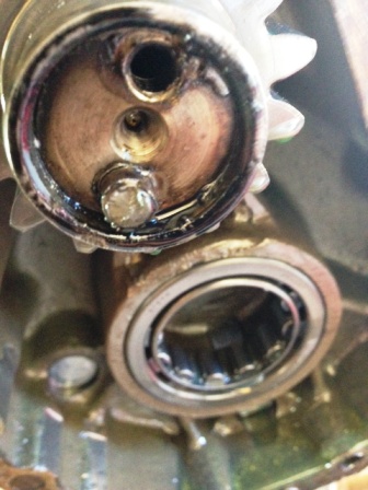

Re: Wheel Drive Oil Leak... Help!!!!!
Looks like I can't post the photos correctly. So, the bottom photo is of the damage. The one above it is of the good bolt still in place and the head from the broken one missing with the washer still on. The one above that shows the good bolt removed, the washer removed and the broken bolt still in place. (I was able to put a pair of channel locks on it and merely unscrew it.) Then, finally, a pic of the cause of this entire mess which was actually posted first.

Looking good. Very similar failure to Paul C.'s, but his took out that entire round part of the plate. Thanks for taking pics.
