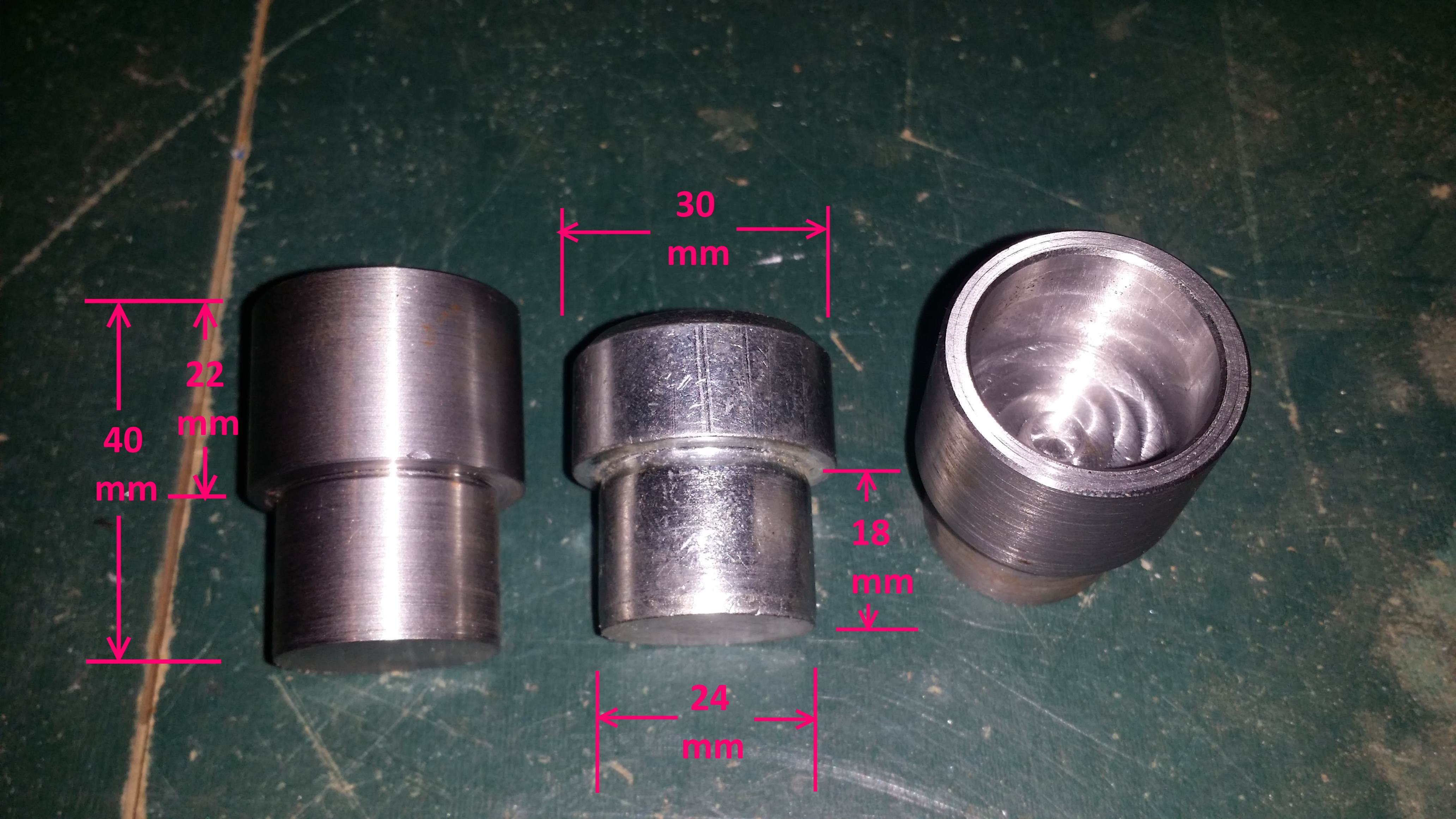

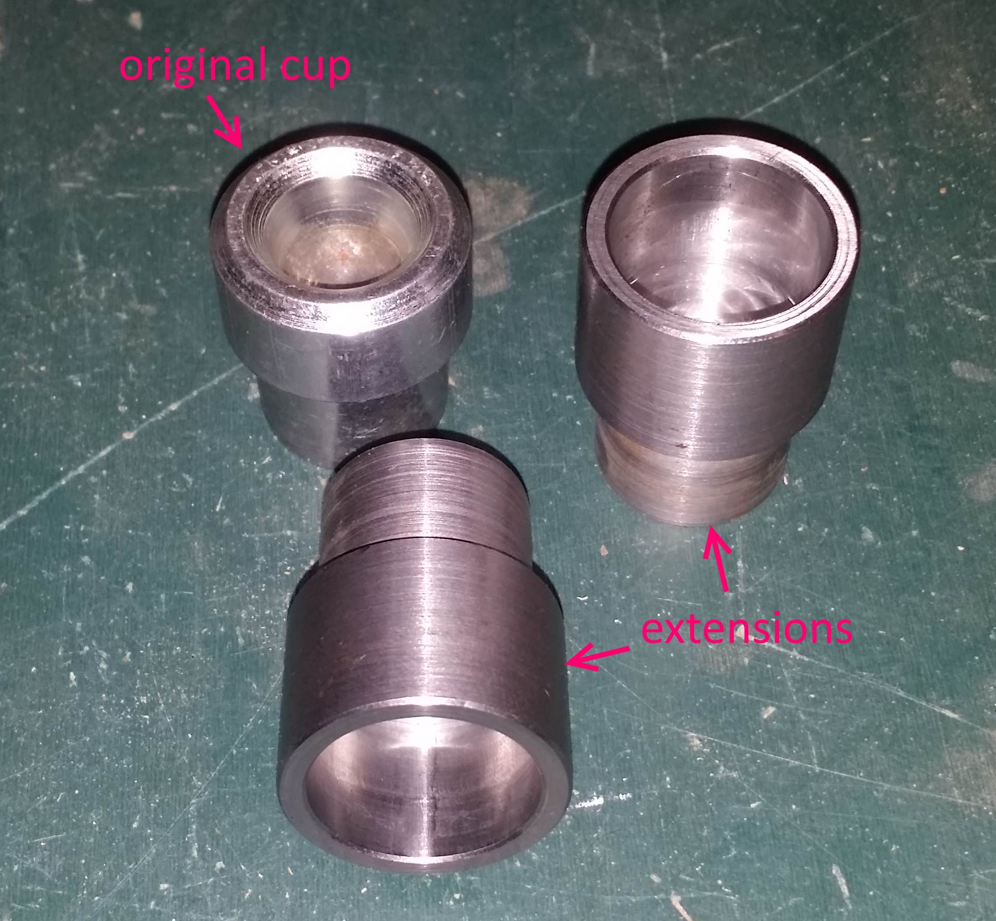

A while ago I had a friend make me up a set of front spring spacers to extend the original ball "seat" part downward. I haven't put them in yet. I would be willing to supply them to GadgetPhreak's truck if he wants to try them out. I can always make up another set - they are pretty simple.
There was a slight mis-communication and the height of the extensions was only 22 mm - which is about the minimum that a part can be made for this approach to work. I was wanting it to be 1 inch / 25 mm instead.
Here are some photos with dimensions:
Front spring spacer.jpg (291.62 KiB) Viewed 4058 times
Front spring spacer Dimensions .jpg (621.91 KiB) Viewed 4058 times
This approach retains the ball seat for the upper spring cup. It would be hard to replicate the original part's inner curved surface with a simple lathe - so the idea of making an extension seemed like an easier approach.
Thoughts?
