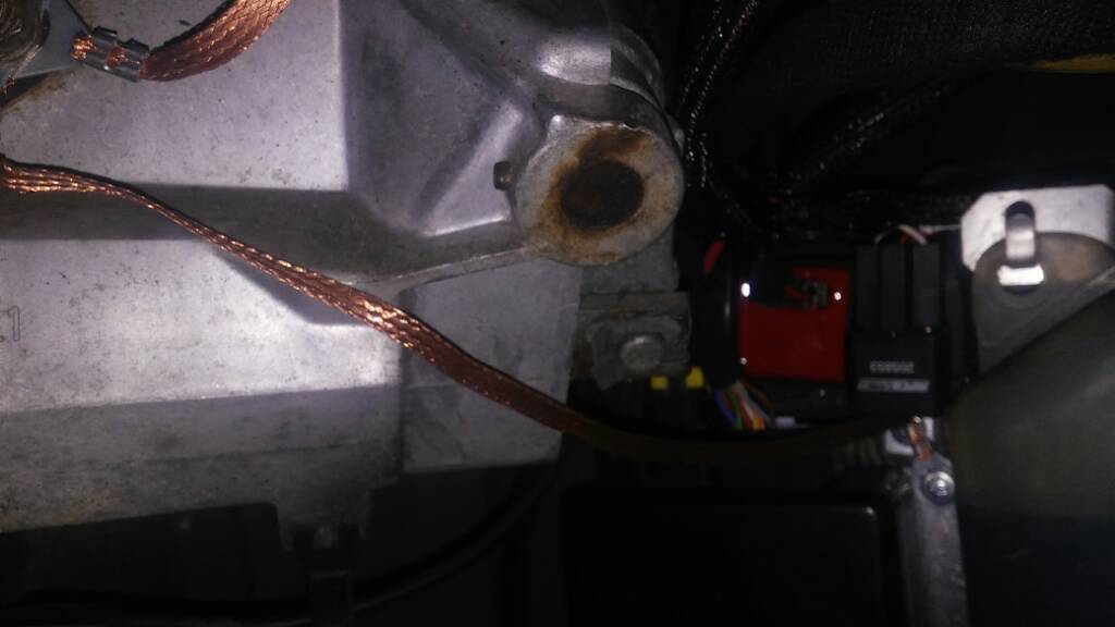

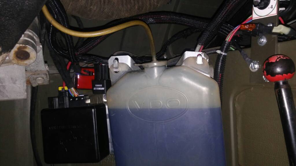

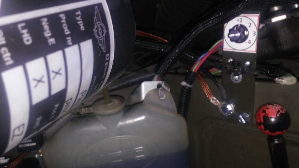

Here's the beginning of mine. Instructions suggest installing the column unit first to open up the work area to allow easier electrical install. I wanted to have the entire electrical ran before I downed the truck for a day getting the column and box out, modifying it and taking it over to the welding shop for a while I wait tig weld. This is from left to right, potentiometer box, 24 to 12v relay, module and across the pic on the right is the easy access fuse mounted to the SSI controller. So far ahead of schedule. The wiring took 2 hrs to lay out, run, build the sheath and mount it all. Just have to plug the column harness connector into the module and the module harness into the column. I figure 2hrs out with the column and cutting the tube and shaft, an hour or so over at the welder and a couple more hours installed. Scott says 5 hrs by a competent tech, I am far from that and should have about 7 in it over a couple eves and a lunch hour :) crossing fingers it works first try!

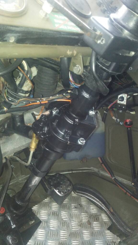

Heres the column installed. I ran 2 additional ground wires from the module and the column to the clutch master bolt and to the body. Just need to mod the ignition switch for the trigger and mod the knee bolster to fit and done. Probobly 7-8 hrs

The system is up and running. Here are a few notes for those installing in the field.
Test fit the new lower column sleeve to the old column before and after painting before installation. I had to grind then feather material on the column shaft including spreading the ears of the lower 2 bolt cover to get it to fit and " slide"
Clean / scrape the pitman and box shaft really well, the marks ARE THERE to line up the pitman.
Test fit your horn button with the wheel installed on the new column and fabricate as necessary before installing the column. I have as much time making my horn work as I have installing the mechanical portion of the system.
Loosely assemble the 4 lower box bolts ( 19mm) , the stiffner rod and align the upper column bracket before tightening ANY of these bolts.
1/8 cut across the backside of the knee bolster will allow it to flex and form around the new steer motor.
Overall it works great driving around town however, I purchased it to help at slow speeds in the rocks with these big tires. No matter where the potentiometer is set, the system stutters and has no power steering or very little felt when it is parked and running. Not was I was hoping for in the rocks. I have an Eticket sent in to Scott to see if they have run across this issue.

Newfisher
Thanks for posting all the pics; i finished my installation today and positioned the electronics like you did, but I moved the water container to the passenger side
two questions remain:
*) how did you manage to position the wires so neatly ?i had troubles squeezing myself underneath the wheel, let alone work with both hands...
*) did you also fond the connector on the underside of the horn button way to big to fit into the column ? how did you solve that ?

Hotzenplotz wrote:Newfisher
the truck can be used by my daughter now :-), but the horn cannot be used yet..
Good to hear!
I laid the harness out on the floor and roughly measured the area in which it was going to be placed in, running all the loom and then fitting it up in the truck. It takes a while to clean it up ,but looks better than the factory I think.
The horn was a real pain. I had to machine down the horn contact stud and drill the end of the column opening it up so the contact stud wouldn't touch the inner column.
