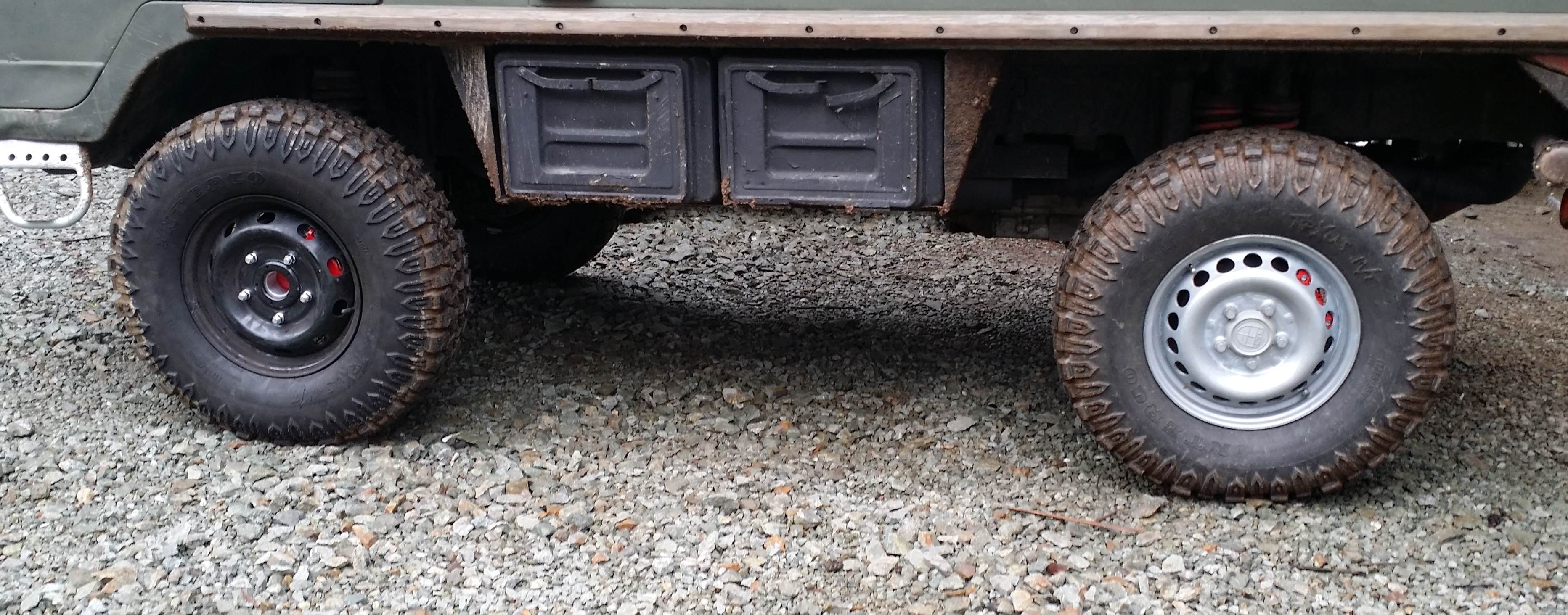

I was able to test them both on the road and in the mud - here is a good comparison of the Transit and Sprinter wheels:

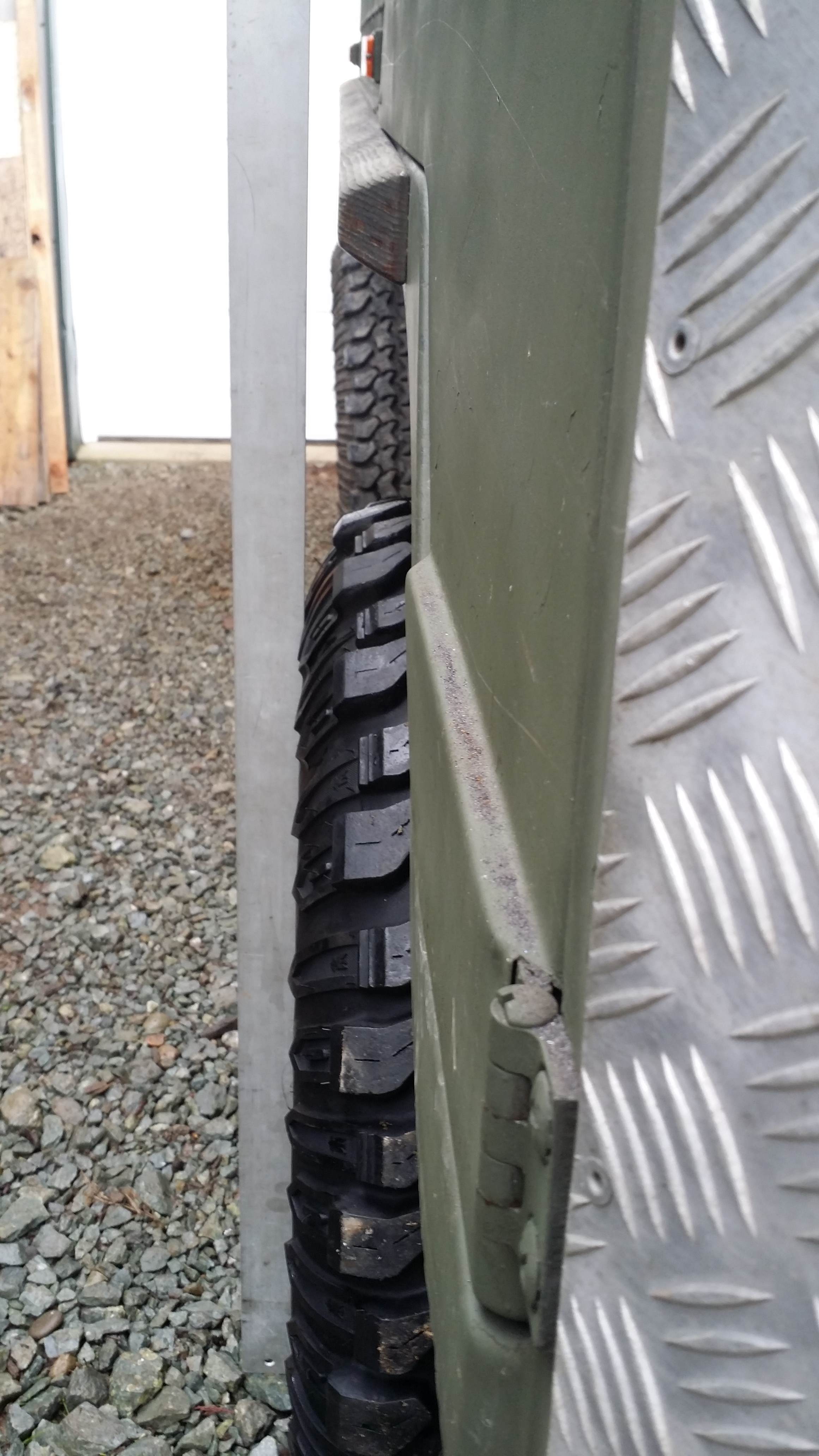

The Transit wheels are 3/4" father outward than the sprinter wheels - but the steering effort was reasonable and no adverse handling was noticed with this size of tire (which, in my opinion, is the perfect tire size for a Pinz). Even in the mud there wasn't an issue with the tires throwing up too much mud - none was hitting the mirror or door in any significant amounts.

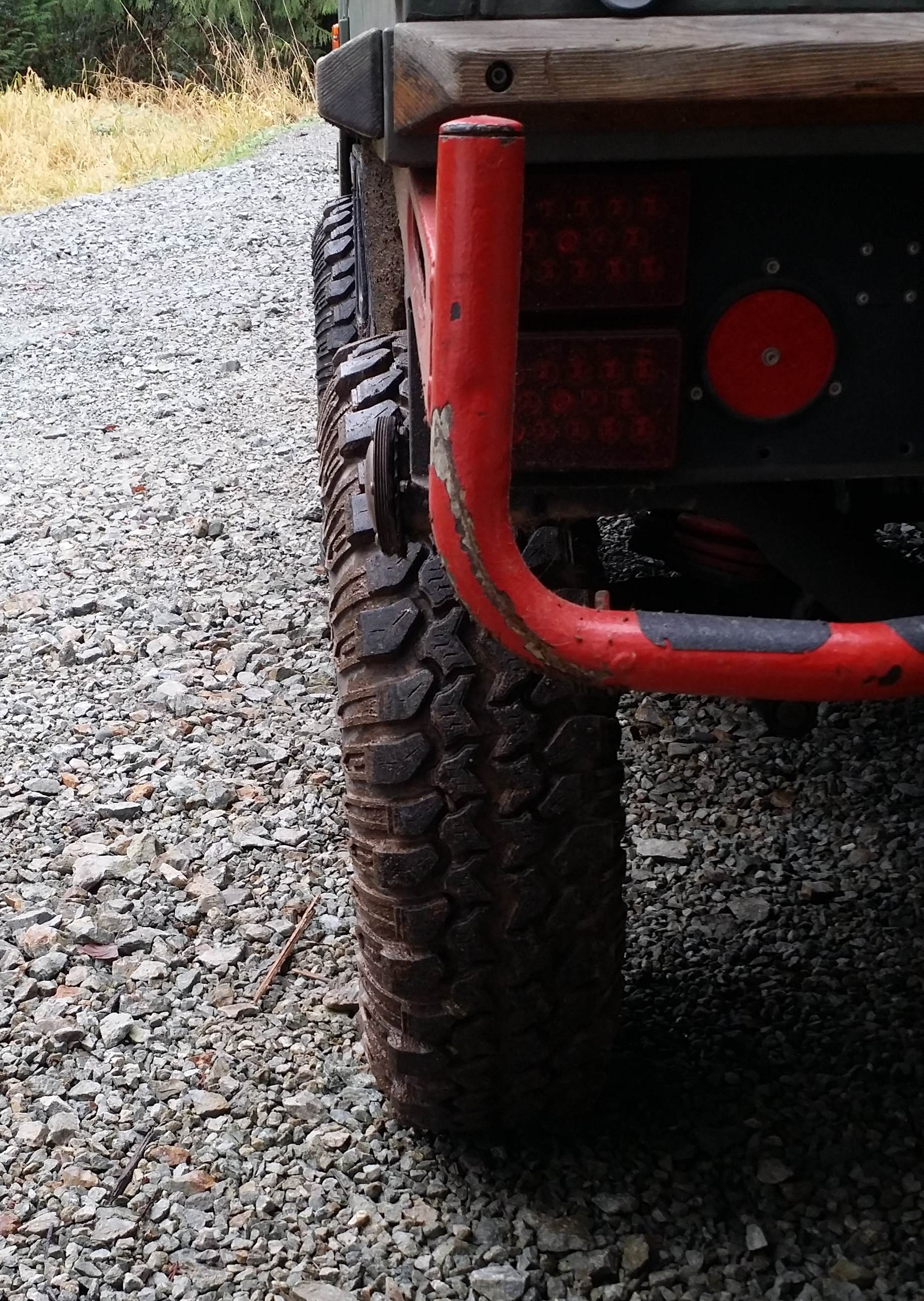

The Sprinter wheels (6 inch wide x 16) are exactly flush with the stock wooden side rails, BTW. Here is a view from the back with the sprinter and transit wheels installed and the same size of tires:
