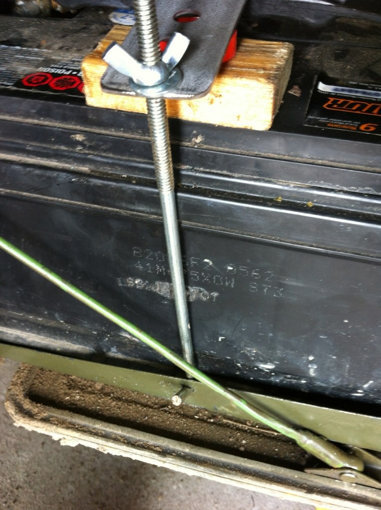

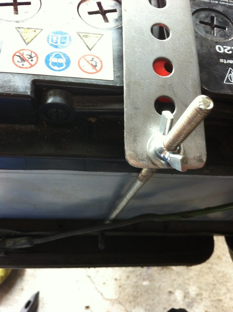

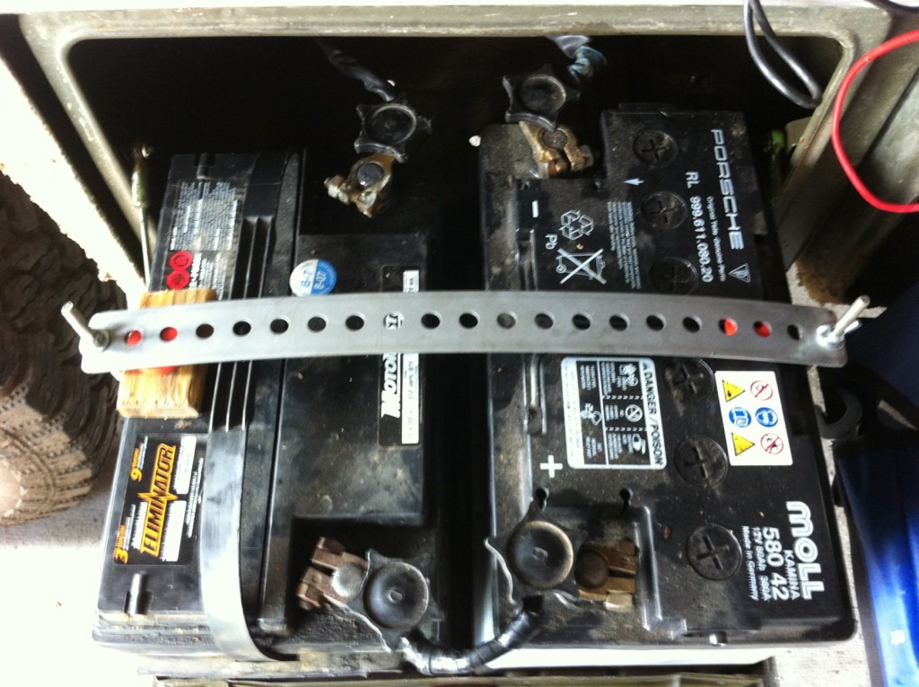

My tray is in rough shape and because the batteries are not the same or parallel, I drilled two holes in the tray and made my own. This is a temp solution as I want to get the original config.
Temp door latch.

Good go at making an odd situation work for you.

Berger, make sure you charge each battery individually with a 12V charger every month or you will be buying a matching set sooner than you plan to! You can use two chargers and do both at the same time; and you don't even need to disconnect the battery leads. Just pay attention to the polarity of each charger to each battery.
With two different batteries, they will have different capacities and one will get discharged more than the other. Because of the way lead acid batteries work, the more discharged one will get LESS charge then the one with more charge; so one gets more and more discharged, the other gets over charged. Monthly equalizing will help to prevent this from happening.

I was wondering that when I first got the truck....but I haven't had any issues :?: . I have had the truck for over a year now, didn't trickle them over the winter (just started the truck every month) and they continue to function.
I do plan on replacing them eventually, but batteries ain't cheap! :mrgreen:

Nope, that's why Jimmy gave you the advice to charge each battery separately. Given the different batteries and almost guaranteed differences between them, the charge disparity will almost certainly occur. I'd say you've been lucky, so far.
Typically in a situation like yours, one battery will just go completely and irreversibly dead, all of a sudden. (Hmmm, wonder how I know this...)
If you're trying to keep your existing batteries alive for as long as possible, Jimmy's suggestion is mandatory, IMHO. I do it seasonally, even though I've got two new Optimas from the same manufacturing batch! As you observed, they ain't cheap!!

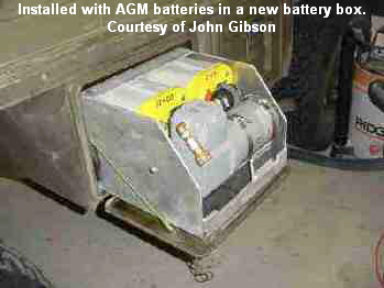

I've always liked this idea
Battery plus compressor.jpg (29.04 KiB) Viewed 5540 times
