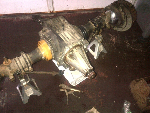

New split boot from Scott at E.I. installed. Man, that was easy. I'm sure it's partly because the front end is out, but the quality boots sure do go on without a hitch.
pinz split boot2.jpg (132.36 KiB) Viewed 5843 times
pinz split boot1.jpg (123.58 KiB) Viewed 5843 times
Re: Big bang, now metal "rattling" sound...yikes!
HEY! You've got that boot oriented wrong. Check the instructions that came with the boot.
The seam belongs to the right, as you stand looking at the differential, on both sides. If you look closely at the diff., you'll notice that the axles do not line up. One is ahead/behind the other. The seam should be at the point of least flex: ie. right as you face it.

undysworld wrote:HEY! You've got that boot oriented wrong. Check the instructions that came with the boot.
Thanks for the heads up. Somehow my boot arrived without instructions, so it was a bit of guesswork. So the boot needs to rotate right as was the orientation of the old one (90 degrees)...makes sense..... will adjust tonight!

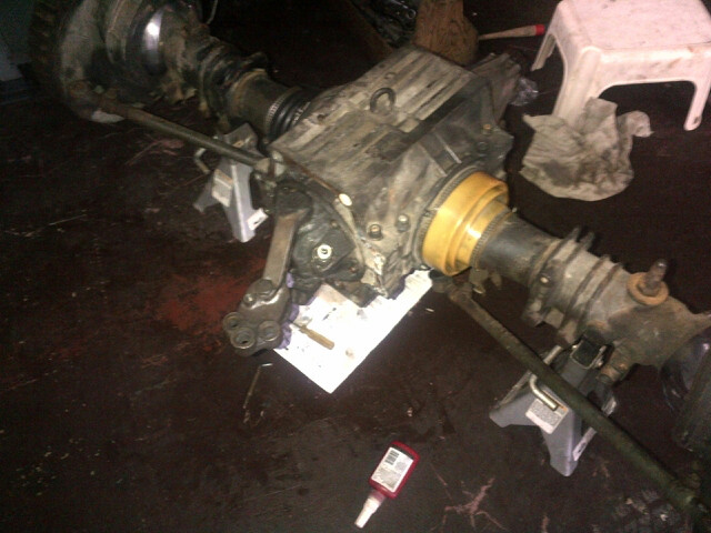

Ok, so the boot has been reoriented, case has been reassembled, witches hat installed and and steering/speedo drive reattached to front end.
Of course, after filling with gear oil, I have developed a small "weeping" leak at the passenger O-ring, probably from dislodging it and resetting it. No point in fixing it until the diff is back in the truck, as I will have to remove the axle drive.

O ring leak is now fixed. Just took it apart again and cleans all surfaces really well. Reassembled and we are in business!
