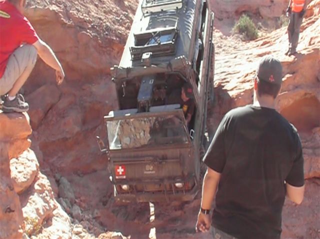

this was taken at one of my favorite teaching areas. This area provides all kinds of obstacles to teach new pinz owners how to handle different situations, from sand to big rocks.
In this photo we lock the rear only, no transfer case or front with the tcase in low range and tranny in first gear. This provides what little engine braking there is available and the use of regular brakes. As you can see once the front right wheel clears the hole he is going to need to make a hard left turn to line up with the next ledge. With the weight of the truck on the front end having the lockers engaged would make that turn almost impossible. In this case constant pressure on the brake pedal to control speed is a must. When he first attempted this downhill with everything locked he came extremely close to rolling the truck (he got a lucky bounce on the lower ledge). On these types of downhills where it is steep, loose and has ledges abrupt braking is a big no no (it will cause the rear to try and come over the top) constant pressure on the pedal is maintained and ease the truck down. Very comfortable once you get used to it.
The 712 really does not have a line on these as it will just cruise down them.

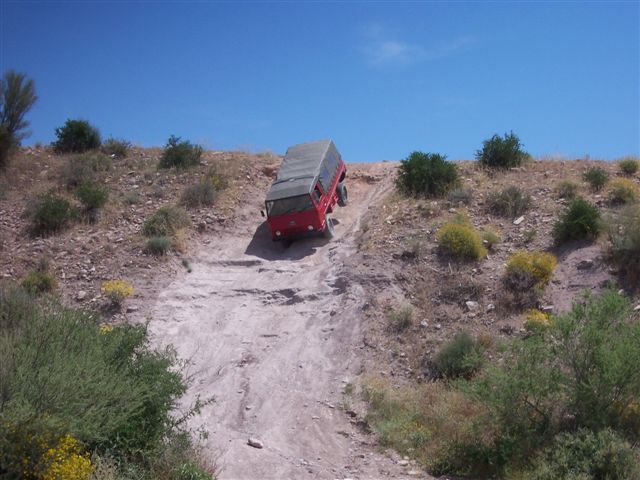

You can not tell from the photo but the passenger side rear tires are off the ground in this photo. Again the front is unlocked as is the tcase. I had to make a hard left hand turn once I got down just little more. Yeah I know it is a 712 but some of the operations are similar. Note that this is solid surface and not loose as with the case of in the above photo but it did not change the setup.
- waterfall1 (Medium).jpg (50.52 KiB) Viewed 4251 times
