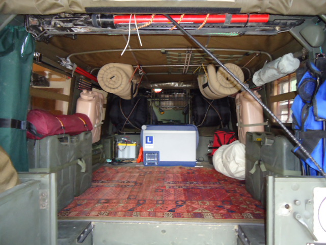

Wrong pic...ignore this ...can''t delete it

Off topic, but what is in the centre area of your truck bed? A slide out drawer or tanks? Access hatches?krick3tt wrote:Wrong pic...ignore this ...can''t delete it

PM sent

No worries about the picture, I have always liked the back of your rig, the rug really pulls it together!
