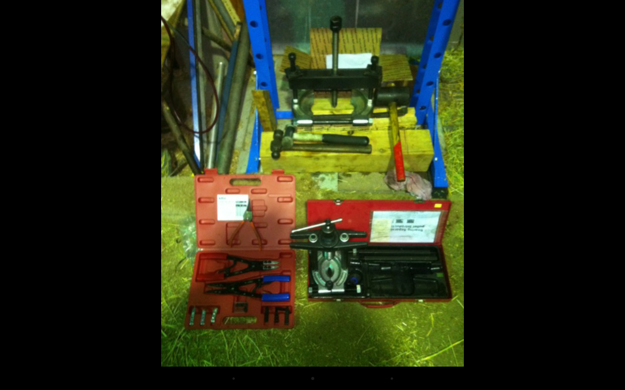

I'm curious to see or read about specific pinz tools that people have fabricated to get the job done. Buying scecialized tools can be expensive especially if they only have very limited or one off use, for this reason where possible I like to make some of the tools needed for the pinz especially if I can save a few bucks. Here's a few pics of some things I've made that did the job nicely, I'm happy to add further details like exact measurements if people are interested. Show us what you've knocked up I'd love to see it, also include easily available generic tools that are relatively cheap and tools you've modified to make it happen....like basic puller sets or tie rod/joint breakers etc.
I rebuilt my gearbox about 18 months ago, I've never done a manual gearbox of any kind before this and was a bit reluctant but I've always wanted to learn and there wasn't anyone down here I trusted anyway so it seemed like as good a time as any, besides it was done only a few thousand km's before this because the previous owner ran it low on oil (incorrect filling procedure), he used a local gearbox specialist who shimmed it incorrectly because he cut his own gaskets. So why trust it to another idiot "specialist". Luckily for me I had profpinz to bounce my concerns off and he encouraged me to go for it. I should add that while I had never been inside a gearbox I do have a background in heavy vehicles and some earthmoving machinery so this did give a level of confidence.

Apart from a gas barbecue with a hood to heat the relavant gears and syncro hubs up to temp (bit of help with an LPG torch) the tools pictured above is everything I needed to to the job and the manual was easy to follow with easy step by step instructions, everything makes much more sense once you get the box apart. IIRC the only parts I made are the big puller in the background, the aluminium press plate as well as a cut length of steel tubing to reach around the mainshaft/layshaft and the small aluminium ring and disc to protect the steel surfaces, I also bought a decent set of ratcheting circlip pliers which made life much easier .With these I entirely dissembled both shafts and reassembled it with all the needed new parts this time with factory gaskets which made the shimming a breeze. I took my time with it and I'm really happy with the result, its done approx 10000km since the rebuild and its still running smooth and quiet.
If you think you might be up to this job then I reckon go for it as it wasn't that difficult.
