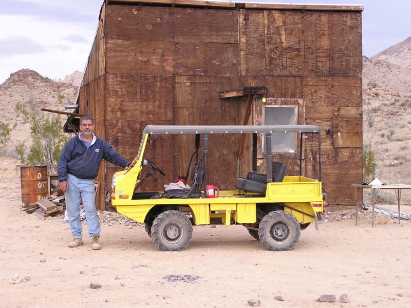

You may have seen a picture of mine.
It had a Jeep CJ seat in it, installed 2 owners ago
I drove it for a week with that seat but removed it as it is too tall for anyone other than a child, no place for feet (with the rear seat doors on. I guess you could remove them)
2 owners ago

Yes, that's the one! That was Hafwit's (I had emailed him this morning to see if I could share pics). Thanks for posting. I am wanting the rear bench for children so that's really what I am looking for. Is it for sale? I like the SUPACAT seat but two kids wouldn't fit.
