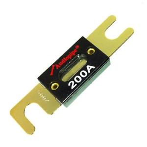

I should have added, I kinda take it for granted --but-- current sourcing/sinking nodes
should always be protected with an appropriate fuse. A decent choice are ANL fuses,
compact, and a wide current range e.g. 50A to 600A. Good for protecting the Equalizer
and the 12V output.
