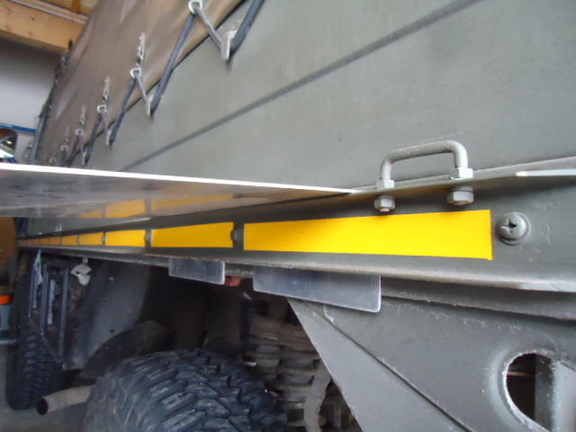

I replaced my wood rail with a 2 inch 'C' channel and used 1/8 washers to stand it off from the body. Only one screw refused to be removed so I drilled it out an in the body it stayed, who is going to notice one more rattle on this thing?
I had sheet alu bent to form a shelf and used that for a table for my morning coffee making, the shelf was then used in the rear to keep items from sliding out under the sleeping platform that I created.

Re: Rubbing strip removal
Post by MTPinz »
Great idea with the c-channel. My 710 didn't come with any and I'm trying to decide what to replace them with. I really like the tube rails, but the c-channel is an excellent alternative. Decisions decisions!
