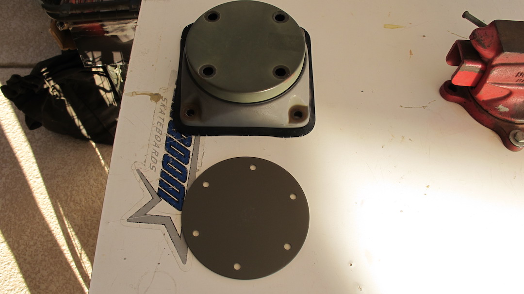

I ordered a spare top center antenna cap from SAV since I'll be drilling mine for my CB and Ham antennas (will only use one of them at a time). The SAV diagram shows a 4 hole cap like mine, but they sent me a 6 hole plate. I'm fine with using the plate instead of my cap if it works. The underneath of antenna base shows bosses for 6 holes, but I can't get my cap off to see if they are threaded. I've asked SAV about this but thought you guys would know.
How do I get my darn antenna cap off! I've lightly tapped it with a hammer from underneath but it isn't budging!
If I can get mine off, are the 6 bosses in the base threaded? If they are I can use the plate and drill it for the antennas instead.
Here's a picture of my base with 4 hole cap, and the 6 hole plate that SAV sent me:

The 4 holer is a standard Nato 4.5" BHC mount, the 6 hole is not, you got the wrong part.

SAV just confirmed that they did send me the wrong cover. They do have correct used caps like mine and they are sending me one. They made a mistake and are responding to make it good really well.
The correct round cap is SAV part number 7131950581U group 31-35-03 in case anyone else needs one.
The flat plate they sent me goes on the non-Swiss side antenna mount.

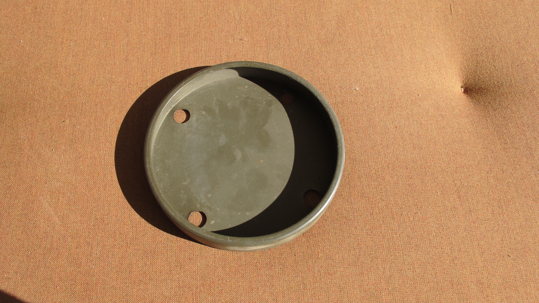

I received my correct replacement antenna cap today. So everyone will know, here are pictures of the top and underneath side. There's a curled lip on the bottom that meets with the round gasket. The side of the cap doesn't contact the base except through the bolts and the curled lip. So RF grounding should probably be done by cleaning off the bottom of the bolt heads, cleaning off the paint on the top underneath the bolt heads for the cap and the base, cleaning off the paint on the underside of the cap where the antenna studs mount, and using NO-OX-ID A on the bolt threads for the cap and the base.

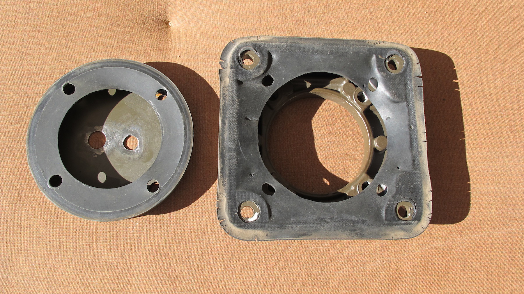

I keep thinking I'm done with this. Previously tried to tap the cap off the base with no success. But today after drilling my antenna mount holes and cleaning burrs and paint, the cap came right off! It just sits on the gasket and is bolted to the base. The base 6 hole bosses visible underneath are NOT tapped for the 6 screws. I've drilled the holes for the CB and Ham antenna mounts. A step drill worked fine. The cap seems to be aluminum. Here are a couple of pictures:
