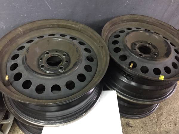

I thought someone here got a set of the new Fiat 500 steel wheels in 15 inch to try on their Haflinger - any feedback on them?
I picked up a brand new set of 155/85-R15 Vredestein Snow+ tires and want to try them out. Just under 24 inches in diameter. There is a local CL ad for 4 fiat steel rims that are 15x5.5 with an ET of 35 I might go pick up to use - just wondered if anyone else has tried them out yet. I think these might be aftermarket and not OEM ones however.
15x5.5 steel.jpg (33.84 KiB) Viewed 12094 times

Well - It looks like all of the rims I can find in 15 or even 14 inch are too wide for the tires I want to use - I need something more in the 4 inch width and not 5.5" wide.
Any ideas of where to look? The temporary spare rims have way too much offset it seems. There are narrow rims for 4x100 (Honda etc.) available - but not in a 4x98 pattern.
