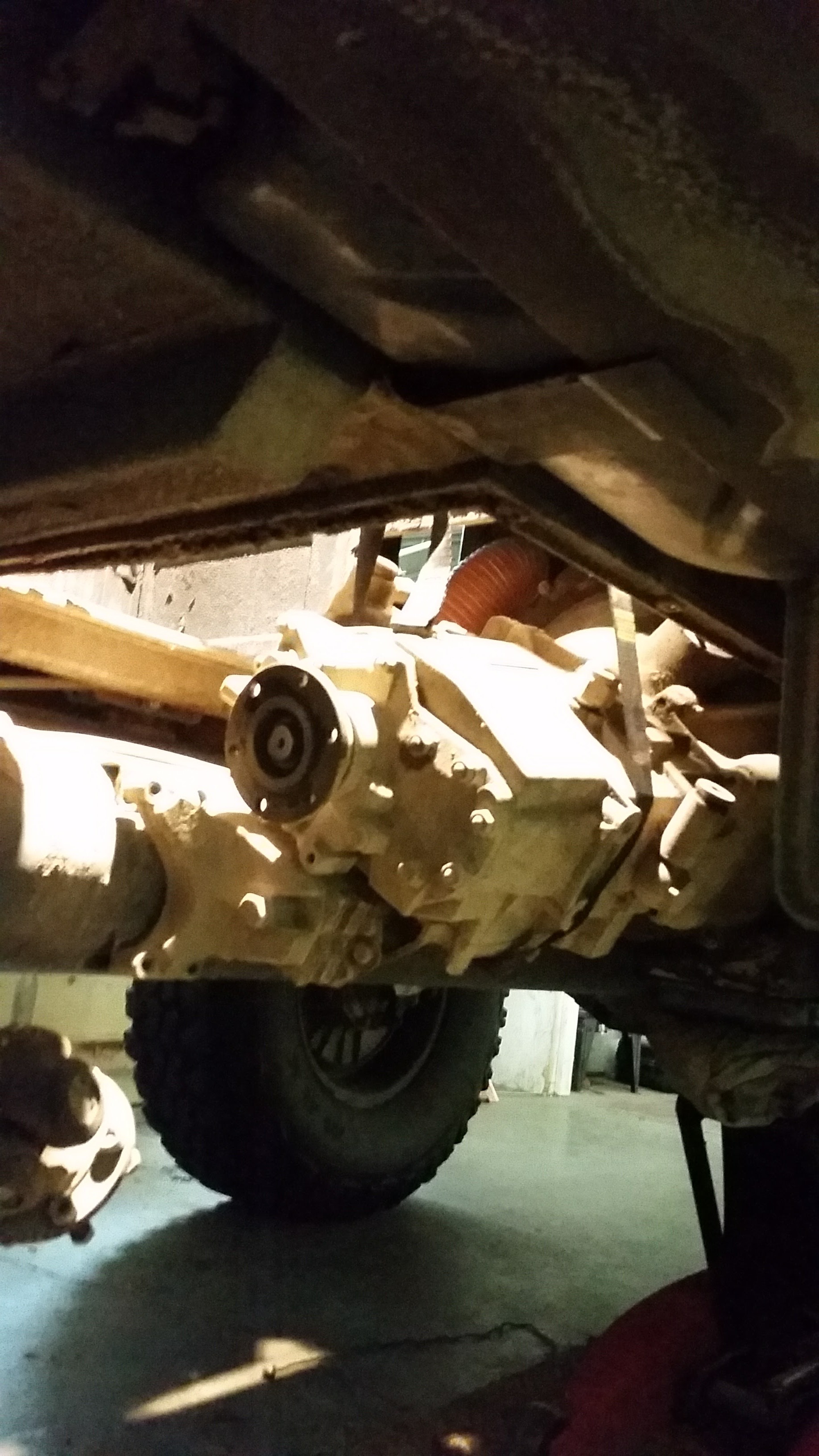

Step 1. Remove the seats, doghouse, and rear access panel in the bed of the truck
Step 2. Carefully support the engine under the oil pan with a floor jack

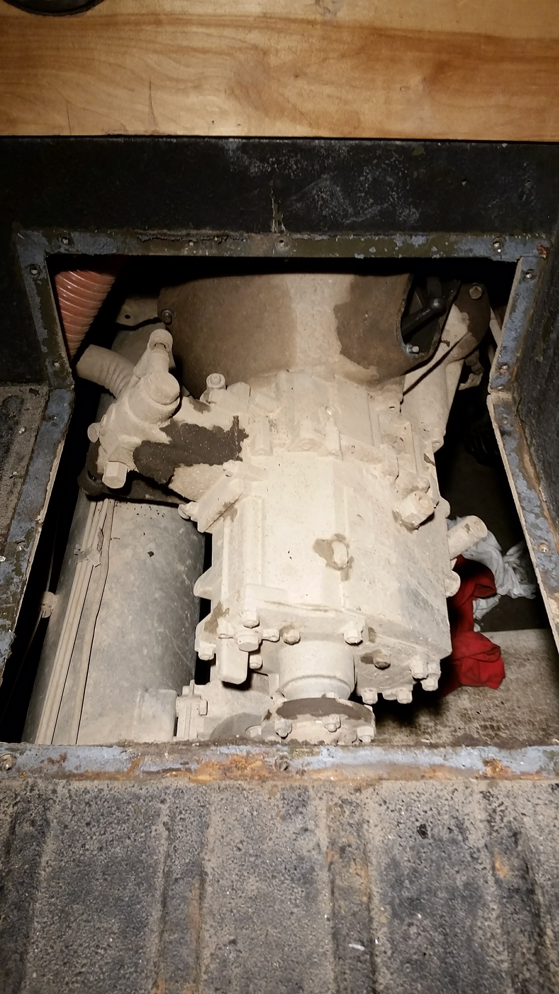

Step 3. Support the gearbox with another floor jack or with a strap from above. This might also be a good time to drain the gear oil and use it as a chance to refill it with Redline MT90 per all the suggestions on this forum.
Step 4. Put the gearbox in neutral and disconnect the shifter linkage on top
Step 5. Remove the 4 large nuts around the bellhousing and the 2 bolts at the starter. In my case 1 of the nuts came out with the stud, but that's not a big deal.
Step 6. Remove the 6 nuts and bolts at the cardan shaft at the rear of the gearbox.
Step 7. Verify your supports or straps and then remove the 4 bolts fastening the rear gearbox mount to the center tube. The gear box should be loose now.
Step 8. Pull the gearbox rearward to clear the studs and carefully lower it to the ground.

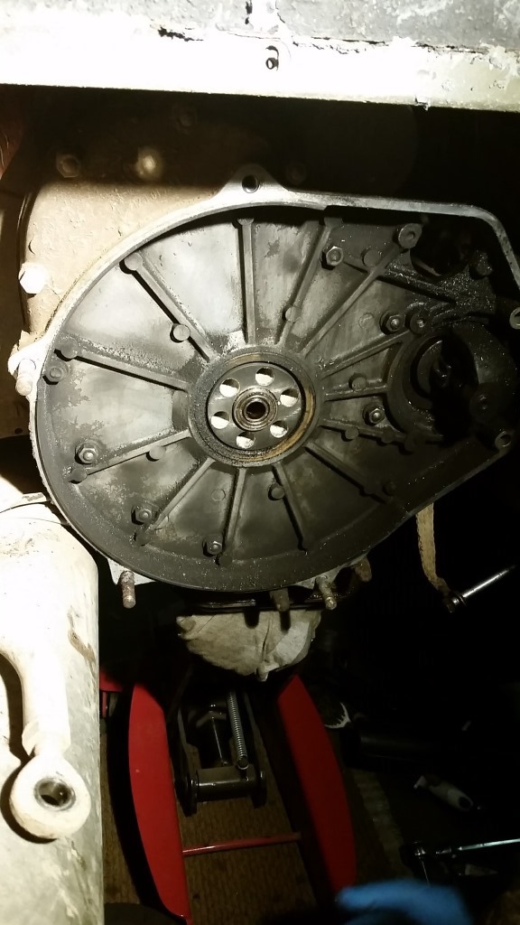

Step 9. Block the clutch from turning with a wrench against one of the studs. Loosen the 6 bolts around the perimeter of the pressure plate and remove the clutch assembly. If necessary, tap the clutch assembly with a rubber mallet or gently pry along the edge with the flywheel.

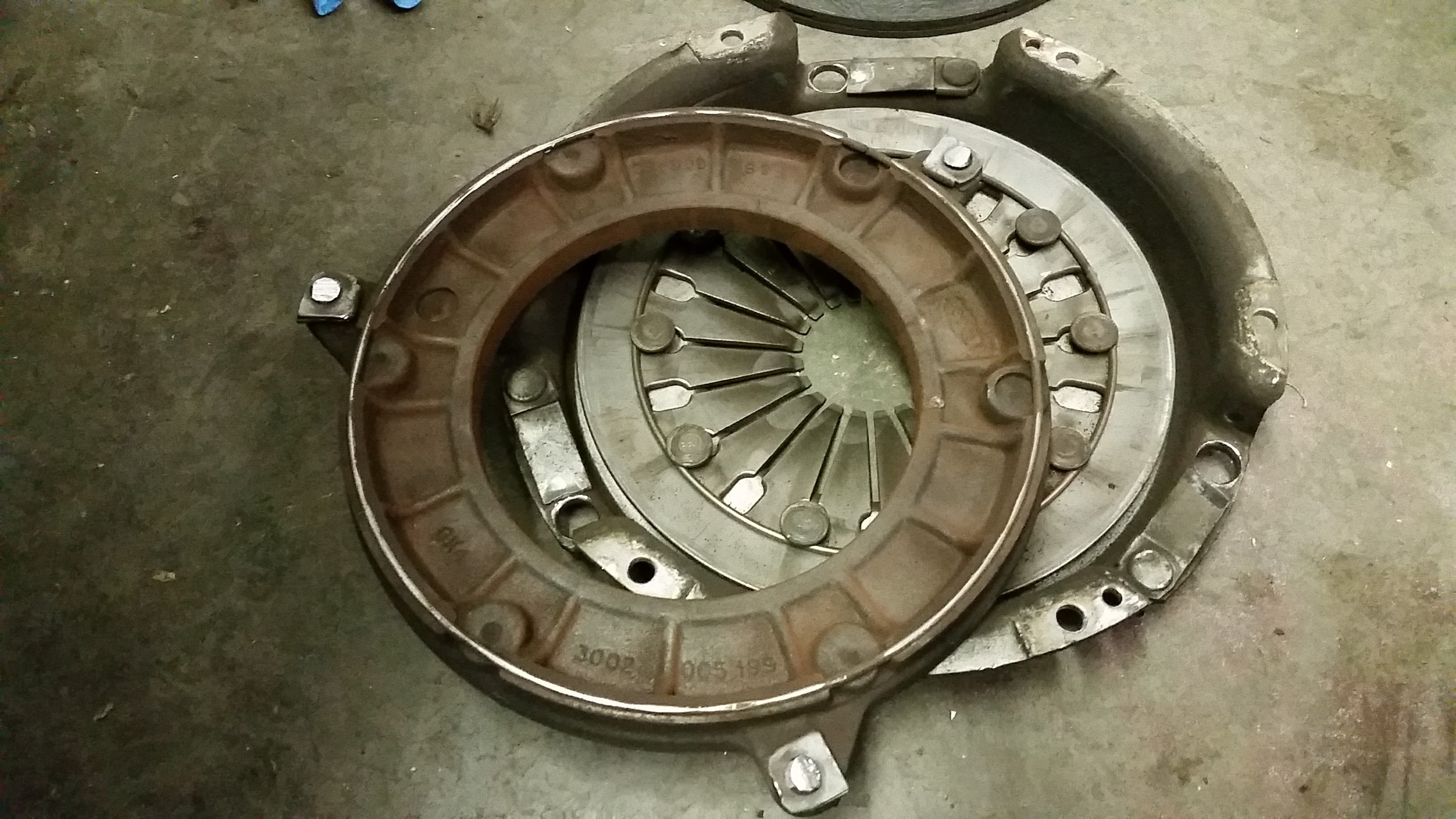

So it is now removed and I've found the source of my mystery clunk...

My mystery clunking was from a broken pressure plate- sheared in two.
- Broken pressure plate.jpg (884.45 KiB) Viewed 10647 times

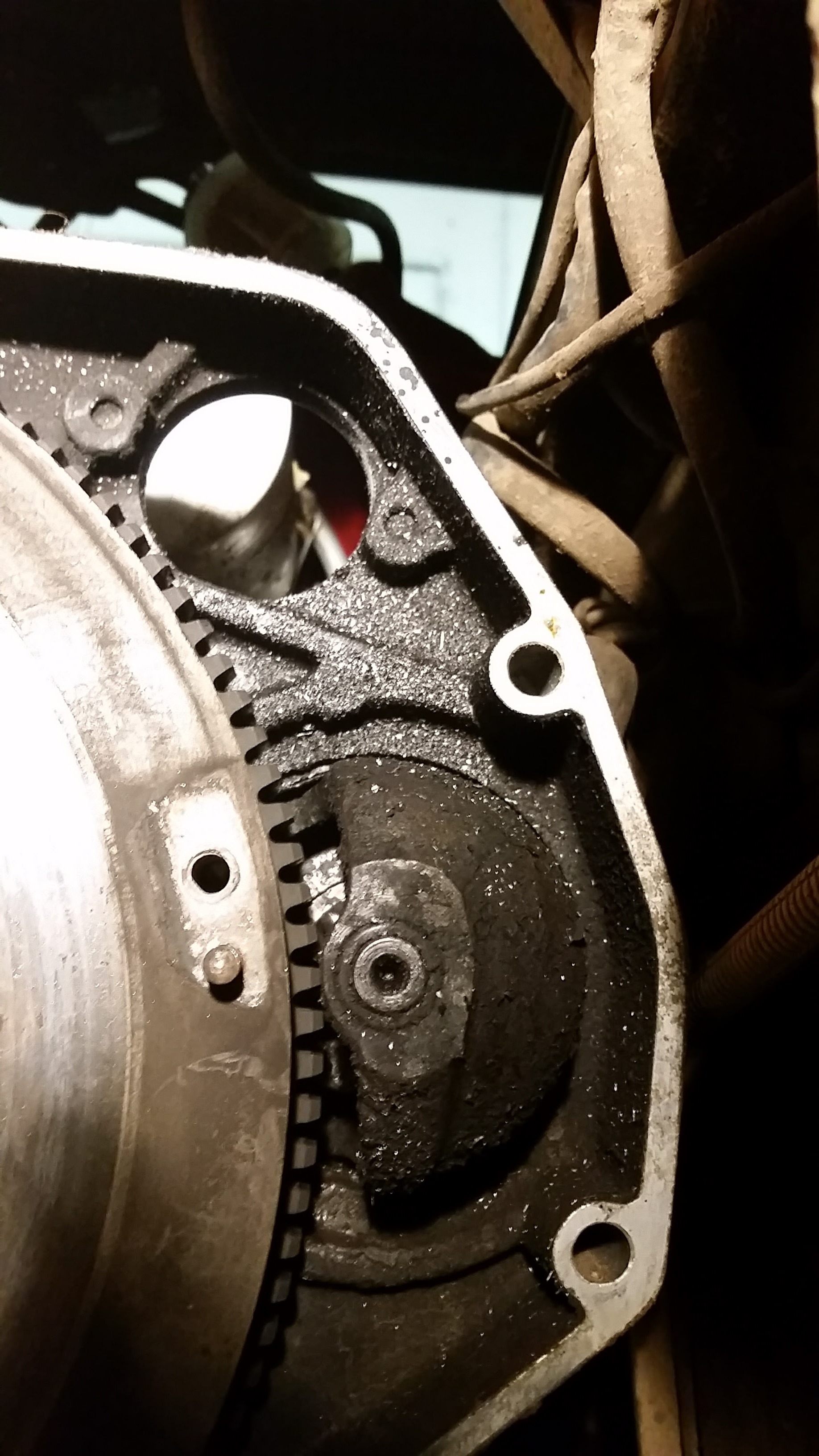

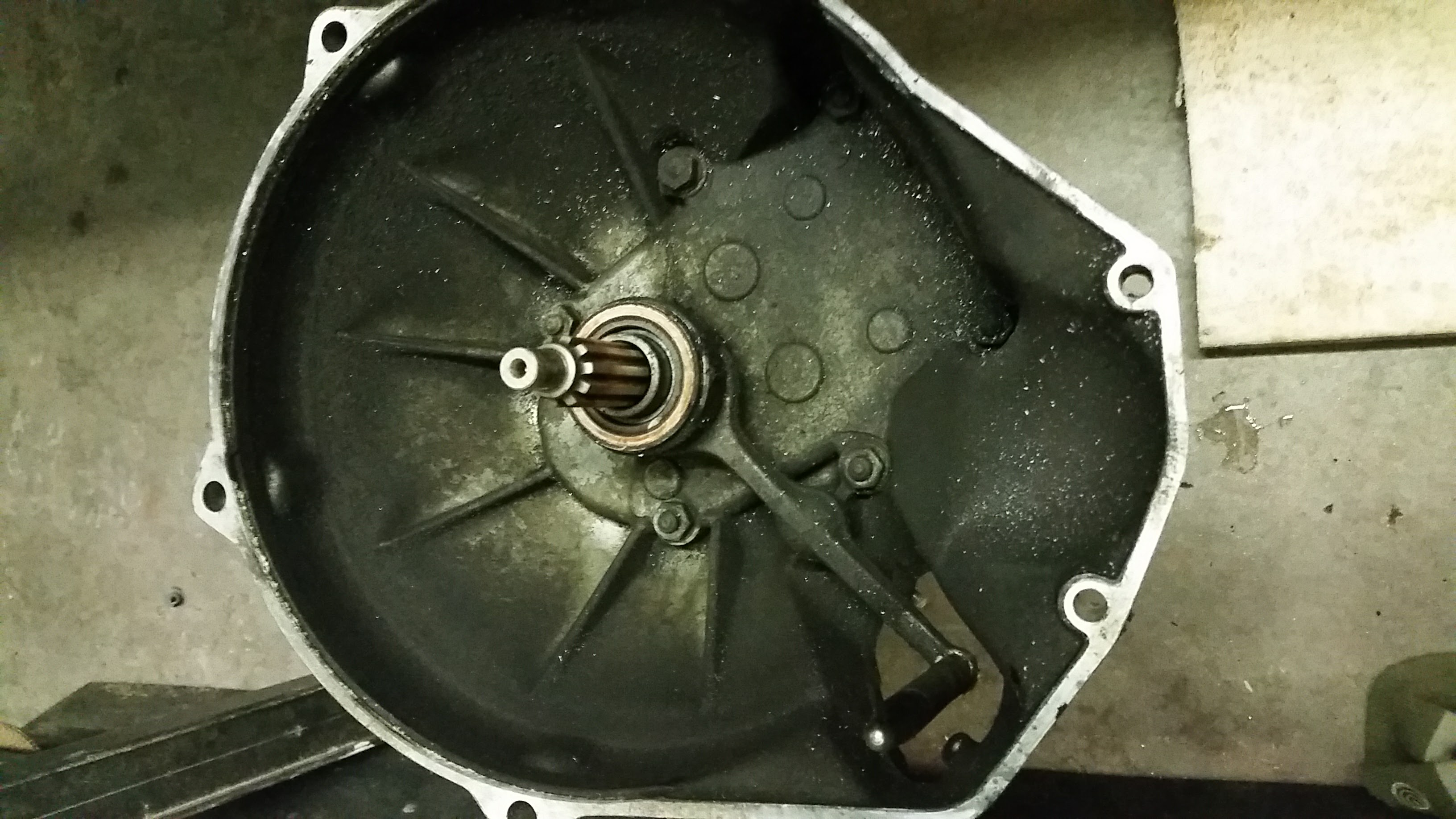

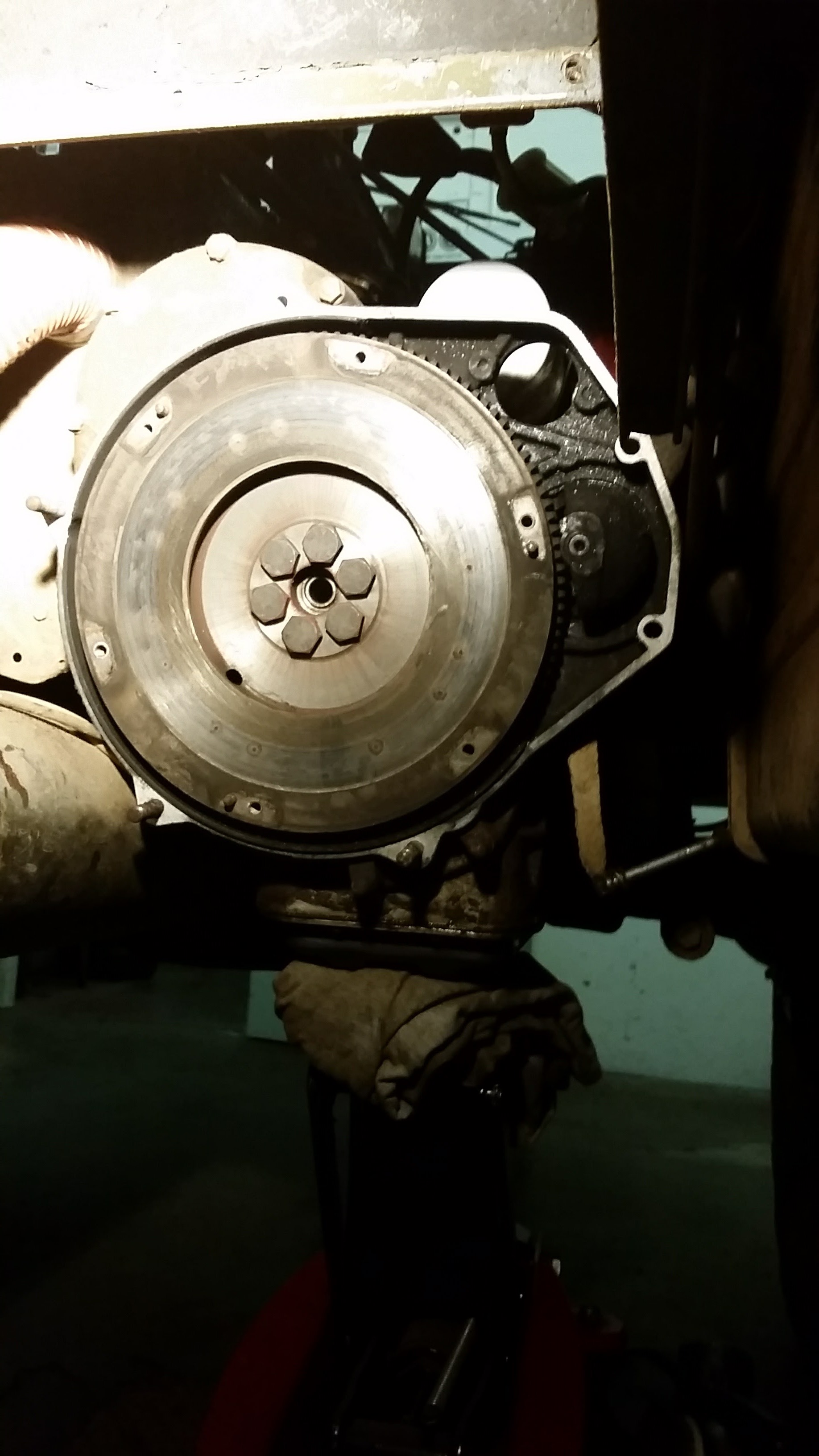

What do you guys think about the inside of the bellhousing? I think they should be dusty, but dry in there. I'm sure my clutch slave is leaking a tiny amount. Could the oily residue be from the slave cylinder? Should I pull the flyweel and look at the main bearing seal since I've gone this far?
eat, sleep, Pinzgauer
Re: Clutch replacement
McCall Pinz wrote:What do you guys think about the inside of the bellhousing? I think they should be dusty, but dry in there. I'm sure my clutch slave is leaking a tiny amount. Could the oily residue be from the slave cylinder? Should I pull the flywheel and look at the main bearing seal since I've gone this far?
The only time I did a clutch job and didn't surface the flywheel I had clutch chatter afterwards.
Since you have it this far apart if it were me I would replace the rear main seal, resurface the flywheel and replace or rebuild the slave cylinder.
Good time to replace the dog-bone bushings if you haven't done them yet.
73 Ed

do you think is absolutely necessary to remove the rear Access panel to remove the tranny??? or you can get away removing all bellhousing bolts from underneath??? im asking cause my floor is furnished and carpeted

It might be possible, but I think it would be VERY difficult to detach the shift linkage which is located on top of the gearbox. One bolt is accessible from below, but I don't know if the 2nd one is accessible from the engine compartment. The previous owner spray-lined the truck bed area and it took a while to remove the coating from the screw heads, but I think it was worth it- especially because I only have 1 real floor jack.

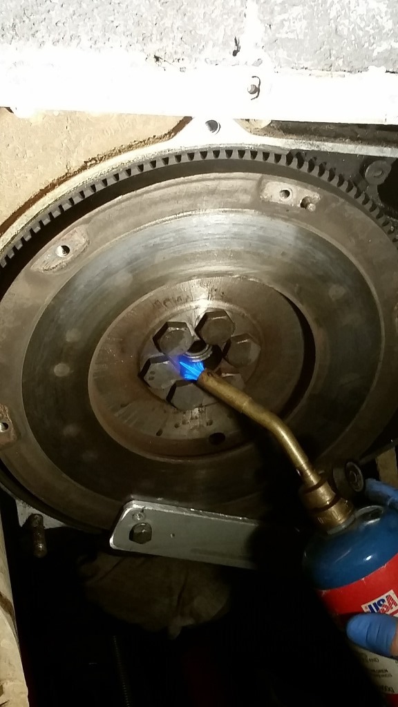

Very little progress this weekend, but it was interesting...

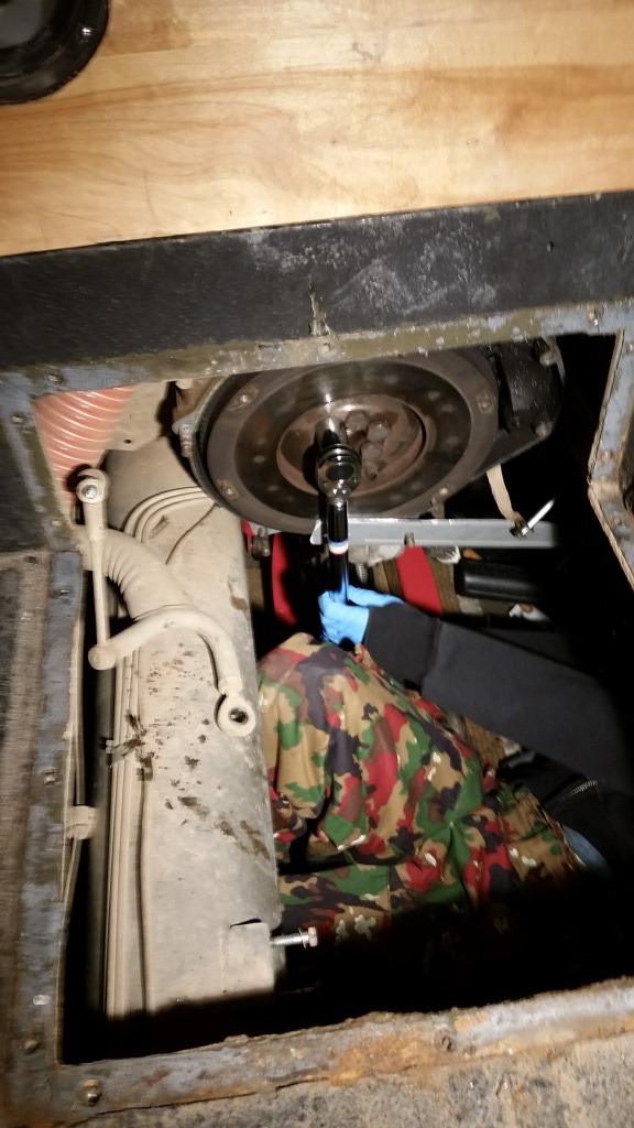

After making an extremely simple version of the flywheel locking too, my son and I pulled the flywheel. The "tool" is a scrap of aluminum and 2 random holes. Per an old Jim L. thread, we heated the bolts to soften the Loctite and they came right out quite smoothly. There was no real "breaking" of the bond just a smooth pull with the torque wrench. The markings on the head are RIBE 12.9 and the manual indicates they're 14mm x 1.5 pitch. 12.9 is the Extreme Strength rating. Also, they're 50mm long under the head. In addition to that big size they have an interesting profile. It really looks like they're designed to stretch a very specific amount. In the old post Jim L. mentions re-using them with a drop of loctite on the threads and under the head, but I think some new ones from SAV are in order.
The rear main seal looks fine to me. You can see that the "oil" in the housing is coming from the slave cylinder (above the starter). All the parts are on their way now.

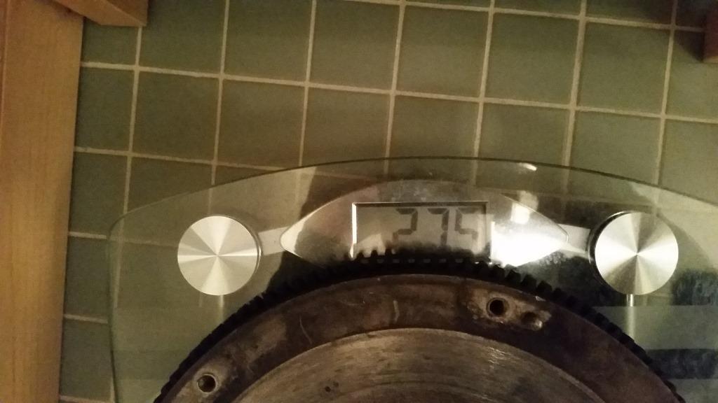

FWIW, the stock flywheel weighs 27.5 lbs (12.47 kilos) on my bathroom scale. Classic SuE runs a lightened one that looks like it is 8.86 kg or 19.53 lbs. Anyone running a lightened flywheel here? Based on past results with aircooled VWs that can make a big difference to the torque curve and how quickly the motor revs up... usually at a cost to the top end or fuel economy though.

- HeatingFlywheelBolts.jpg (126.16 KiB) Viewed 10352 times
- BreakingLoose.jpg (145.87 KiB) Viewed 10352 times
- RearMainSeal.jpg (137.24 KiB) Viewed 10352 times
