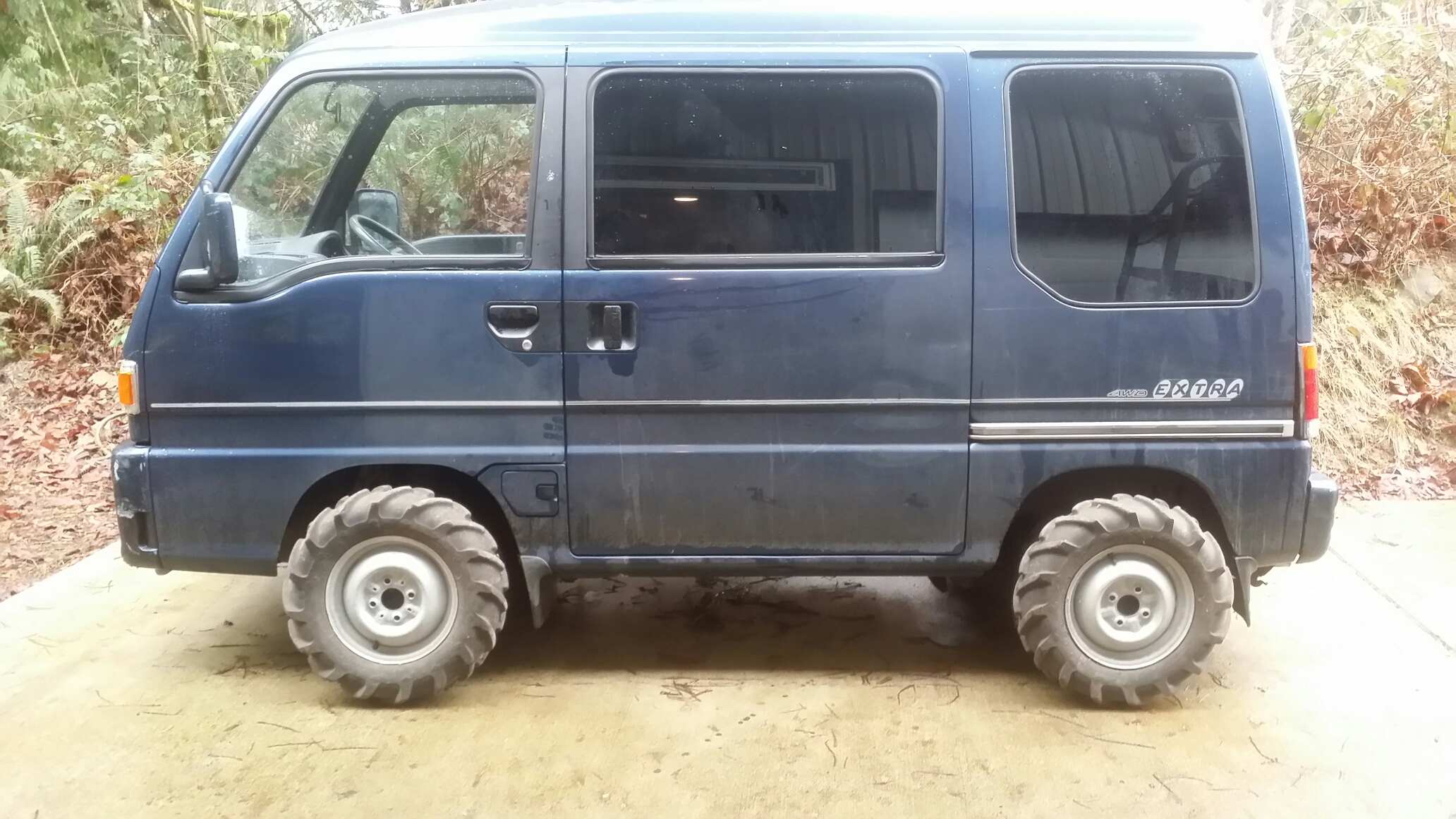

These are 6-12 carlise super lug tires on haffy wheels.
- 20170205_130510.jpeg (1.09 MiB) Viewed 15067 times
Re: Atv tires on stock rims?
They should fit but would have a large sidewall bulge.
I would be more worried about the load rating but if your just using them off-road, probably not a big issue due to low speeds
