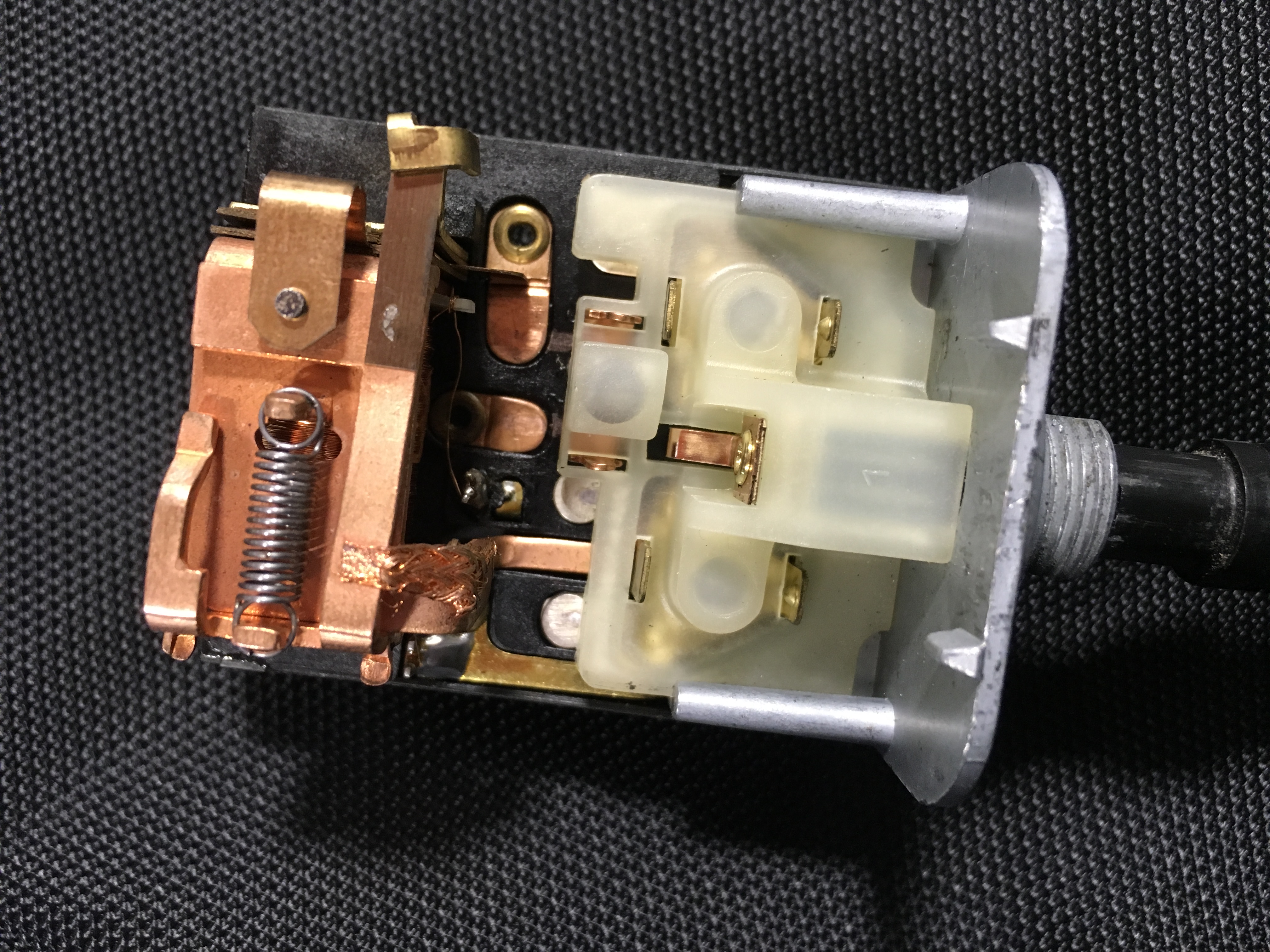

I have a question.
Does the ignition have to be on for brake lights to work?
I am troubleshooting rear flashers not working and notice rear brake only work with ignition switch turned on. All other lighting circuits work.

Took apart emergency flasher switch it looks like new inside. I still took my my meter and did checks of alll contacts with switch open and closed.
