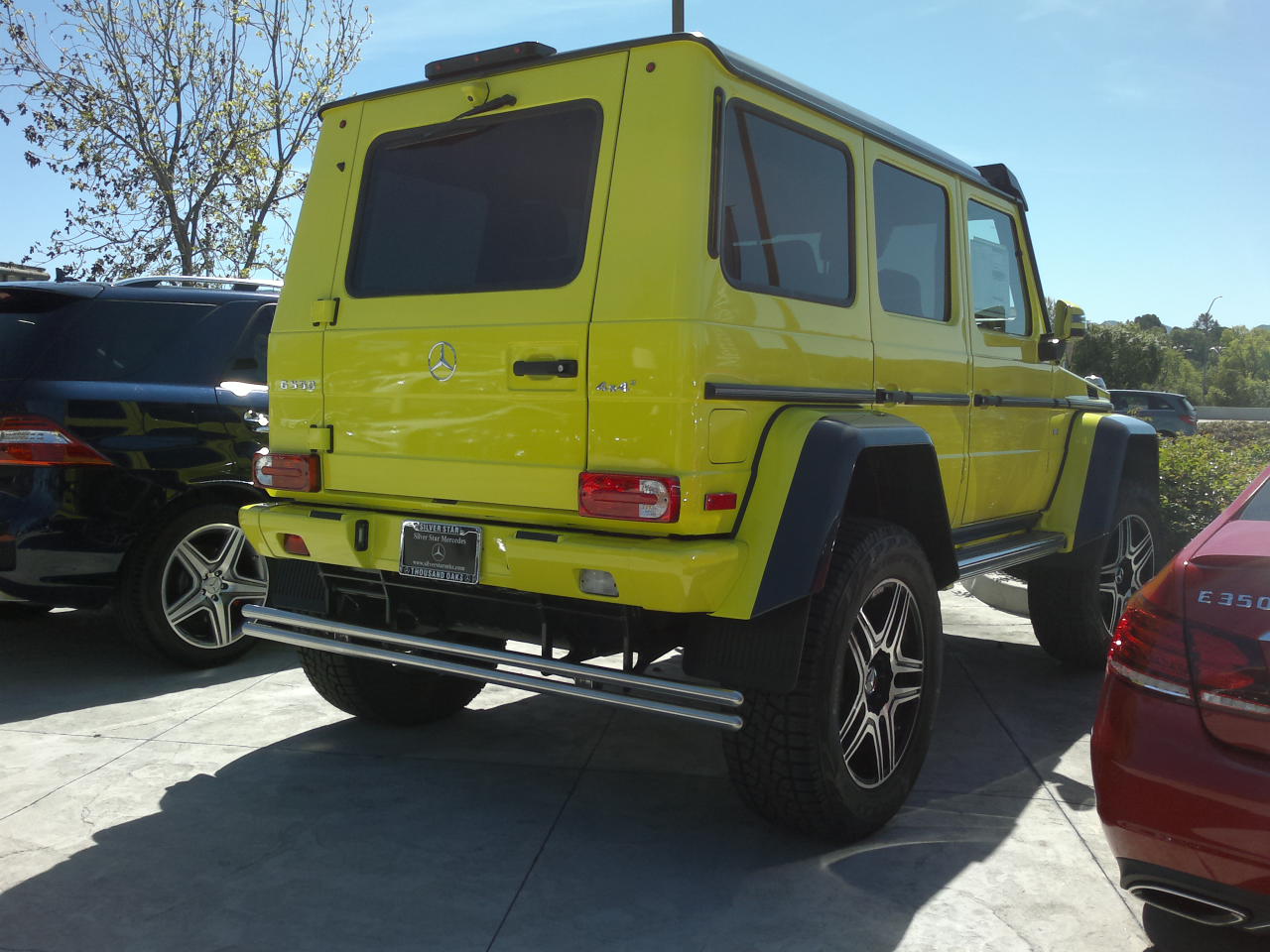

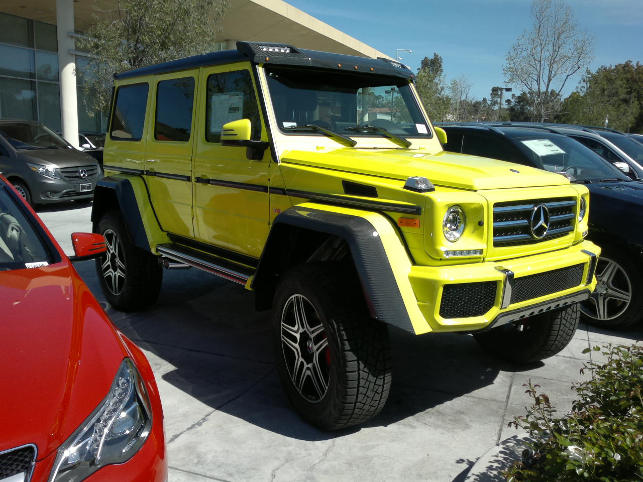

I asked the ex-football player looking sales guy, who ran out to me, if he thought that color was the best gamble and he skipped that question and simply said, "Well yeah buts its got carbon fiber and you can, like, drive in the water and pull other SUVs out with this thing". That concluded my conversation.
I just passed by and saw this, one of 5 made for the US market, parked down the road at the dealership. They call it the 4x4 "squared" which, like the paint color, isn't the best idea in my opinion.
11mpg (same as a C303!) That's $245,000 on the sticker. There is a ton of clearance underneath, I'll give it that. You got to love that rear "compliance bumper".
Now to sell a kidney so I can buy a set of those axles for my old lump.

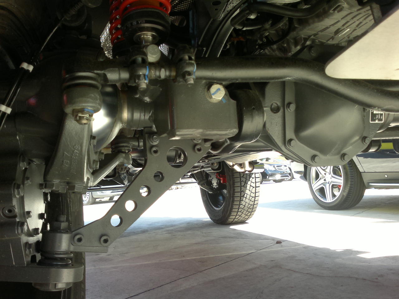

Disappointing to see the rock catching, Hummer-like triangulation bracing the portal hub.

Not sure how you avoid that support?63rover wrote:Disappointing to see the rock catching, Hummer-like triangulation bracing the portal hub.
It is only on the front steering axle

Yeah I was wondering about that too. Salisbury (Volvo) has a very similar axle with plenty of strength without intruding into that space.

The brace wasn't necessary on the Pinzgauer which I'm certain has a higher load capacity. Could be a cost saver since it's not too likely these G's will see much off-roading.
Re: The new 2017 4x4-2 Gwagen... with portals!
Well it wasn't designed from the ground up to have portals like the Hafi, Pinz, 303, Mog
They are all just bolt on even the 4x4^2
Those angled bracket could have been easily designed for more clearance - there is a lot of space between them and the CV joint that isn't necessary and they are just flat plate. I think part of the idea was for them to be visible to look "kool"... with the size of tires most of these are running the portals are not really necessary.

Well both LeTech (who designed the 4x4^2 ones) and Tibus uses them in very similar design
But I don't really know the reason/engineering behind them

Yeah but the Volvo Salisburys look a lot like one of their basic axle designs just with some portal engineering on the end.
Maybe these weren't worth setting up new designs for due to the low numbers, or maybe its typical of today's standards? Although these still offer up more clearance than a Humvee underneath.

I think it's because the older portal axles (pinz, volvo, unimog) are king pin swivels versus these newer ones (hummer, tibus) using ball joints?
