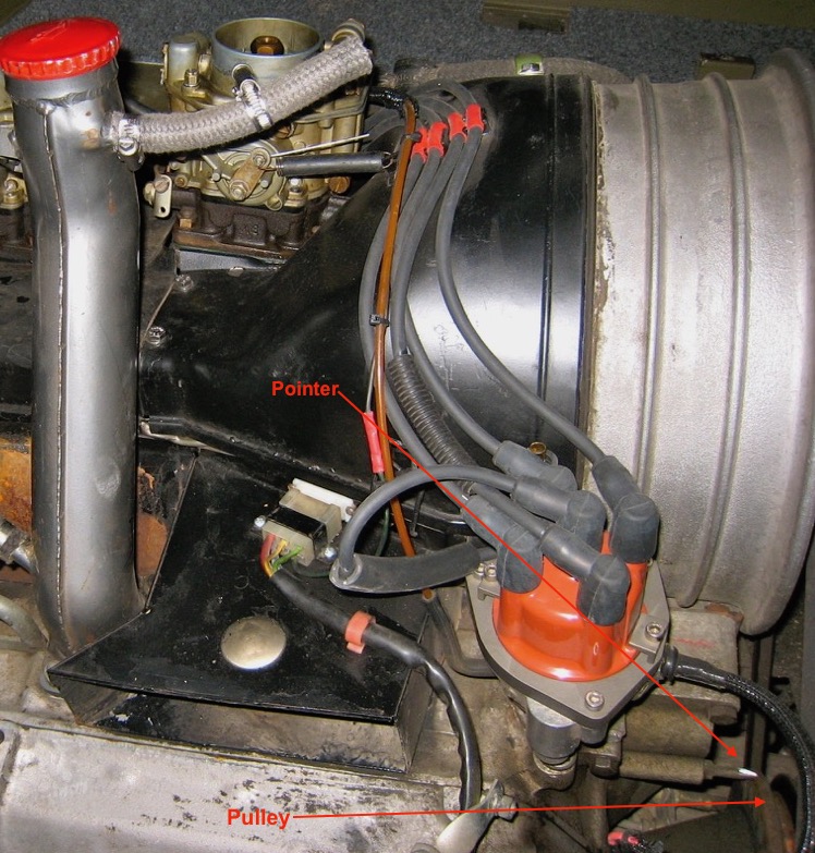

Ed... one other thing. The flywheel has an orange v or mark at TDC. So, if you're trying to confirm that the timing is right look for the orange mark. You can turn it with a large socket. If memory is correct, which generally it fails me, it's a 25mm socket. Good luck.

Here is a photo of the pointer and pulley for checking the timing. There is a small groove cut in the pulley and when the pointer is on it, the engine is at TDC.

Today I need to go in there to replace the distributor seal on the one that doesn't idle - oil everywhere - so then I'll need to do the timing - thanks for the picture, very helpful (I would have been looking on the back side of the motor!)
