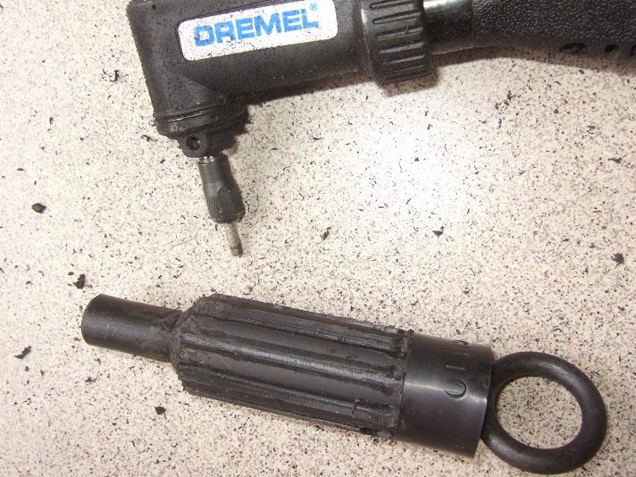

- One Clutch alignment tool (SAV: SAV2725 = $9.50 + postage) (I bought a plastic $6.50 GM-10 one (Ebay) and spent 30 min grinding it down so it would fit... Buy the real deal !)

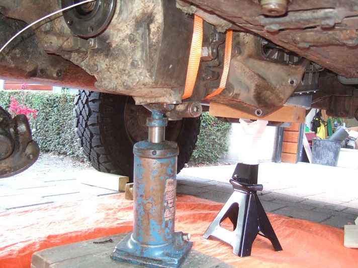

- One Jack-stand: the type where you adjust to a set height and the ratchet keeps it there (see photo)

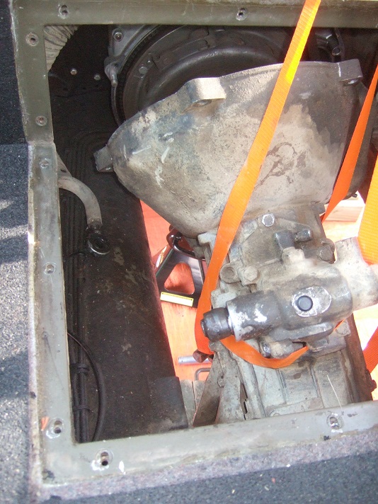

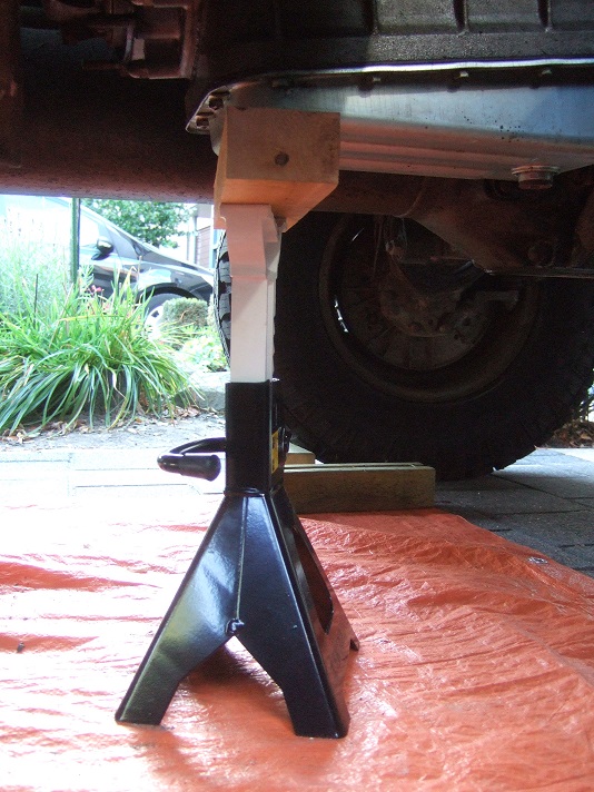

1 - First support the engine with a Jack-stand: Use regular jack to lift engine 1-2 mm and then put a jack-stand under it with pieces of wood so they fit tight.
2 - Build a make-shift bridge to hold the gearbox later with the ratchable strap (Don't use a thin crossbar-beam like I did, but had nothing else... It needs to support 39 kg)

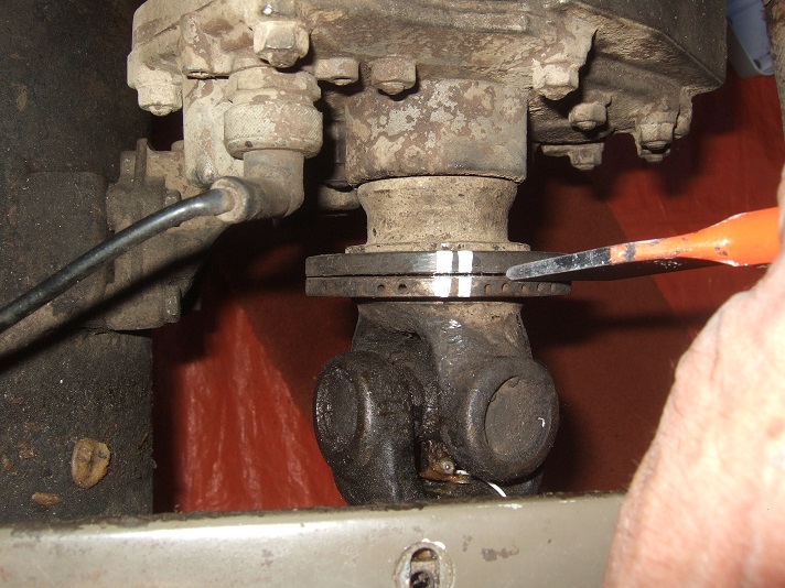

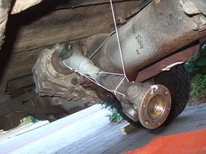

3 - Wire the two ends of the cardan-shaft, so they cannot slide apart (some mark them, but with all that grease easily wipes off). They are balanced together and when they're apart: no telling of the correct position anymore (This is more fool-proof, like for me...)

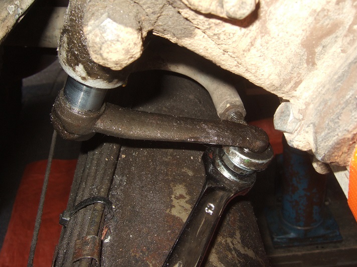

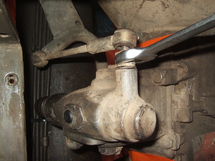

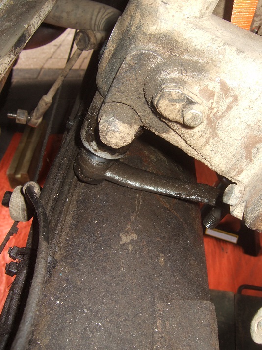

4 - Remove the nut (size 17) from the gear-shifting-rod-guide that connects to the weird two-pronged bit at the end of the thick tube
5 - Remove the nut (size 19) that connects the gear-shifting-rod to the gear-selector-arm of the gearbox. Keep the ring under the nut together with the nut !!

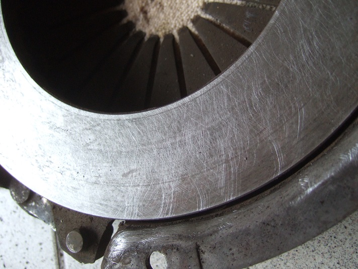

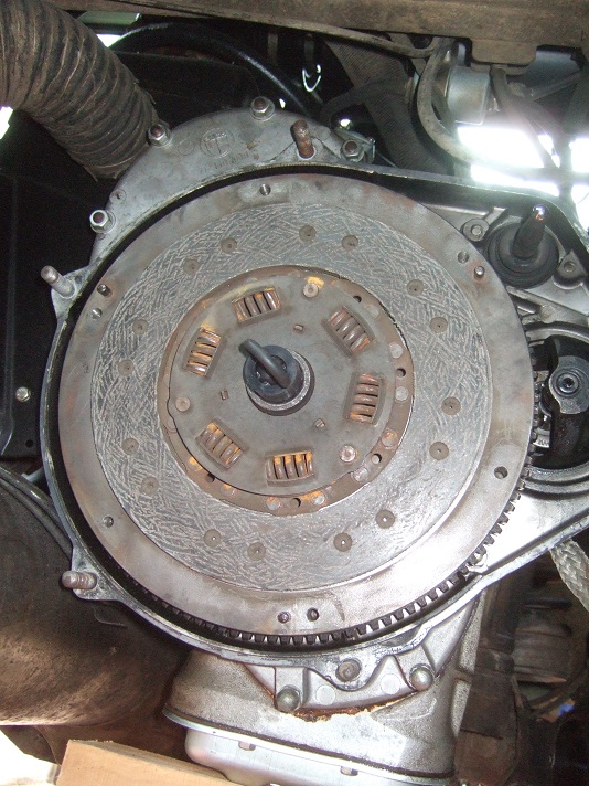

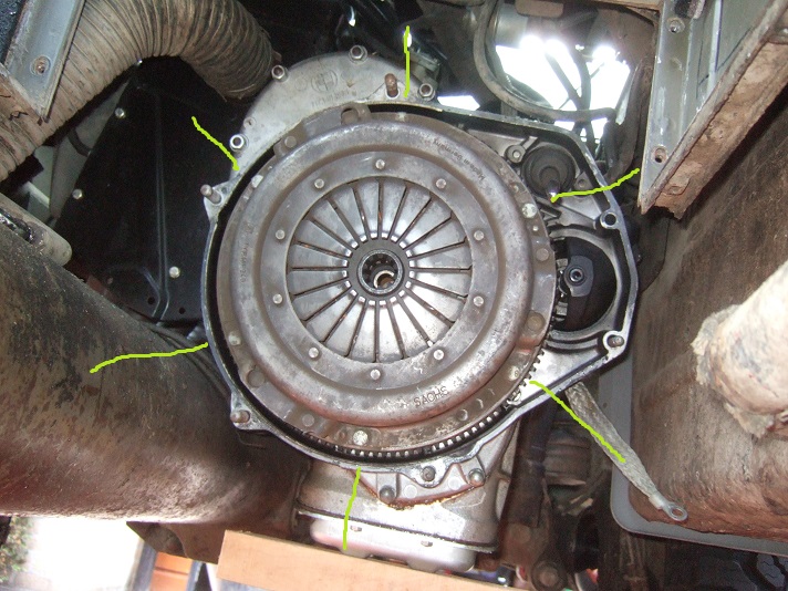

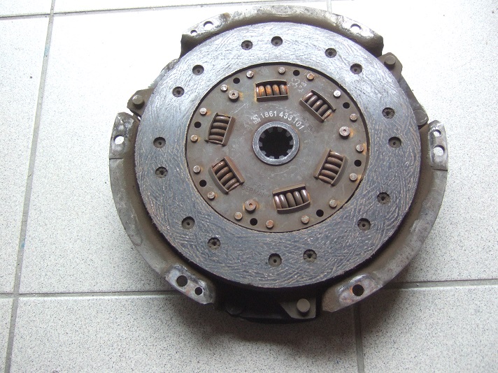

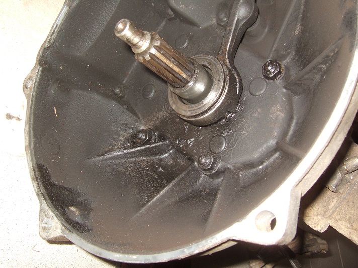

21 - Luckily ... ?? the clutch-plate was stuck to the pressure-plate and not on the flywheel, which means I could take the clutch-unit off, instead of working underneath the truck.
If it was stuck on the flywheel; I would use a piece of wood and try to hammer on the pressure-plate-side to pry it loose, but would have at least 1, or better 2, bolts still threaded in a bit, so if it comes off suddenly it cannot fall to the ground, or your face....
In case it is stuck on the pressure-plate: remove the clutch-unit (as in picture), then on a bench stand the unit up on its side, place a piece of wood against clutch-plate-grooved-sleeve and bash it loose (a good whack as it is stuck hard) from the pressure-plate-housing in one go.
22 - Without going into too much detail (huh ?), I just sanded all the exposed surfaces with 80 sand-paper. (Flywheel, pressure-plate and both sides of the clutch-plate) It seems that the 'rope' in the clutch-plate swelled from the moisture and got it stuck to the pressure-plate. The picture shows the sanded area from the pressure-plate. It looks the same as the flywheel. Sanded the clutch-plate slightly also, the remove any 'swollen' rope on the clutch-plate.
23 - The clutch-alignment-tool did not fit and had to remove excess material to make it fit, next time I'll buy from SAV
24 - Put the alignment-tool in the clutch-plate-sleeve and insert both in the flywheel

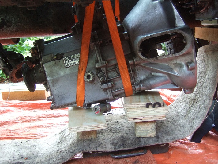

By now all the bolts are off, that hold the gearbox in place !

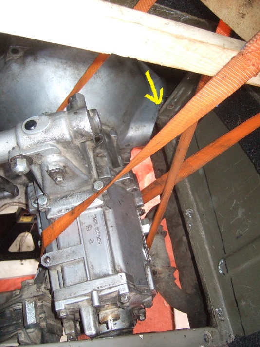

Make sure the strap supports the gearbox and that the jack & jack-stand underneath support it, in case it suddenly comes off !!

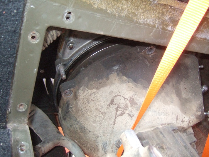

16 - Now wriggle the gearbox backwards, pull up and down on the cardan-shaft-end and pull backwards... (muscle-power needed...)
17 - Just pulling it straight backwards, means the gear-selector-arm will hang up on the central tube, so you have to turn the whole assembly sideways !!
18 - After turning it sideways, you still need to wriggle it about to lower it.
19 - Let the strap out so that the gearbox-assembly can lower a few inches. Now assist its descent with the jack, until the strap is tight. Support gearbox with the jack and re-loosen the strap.
Then let it lower again on the jack, etc...
20 - Now, after removing the gearbox with bellhousing, the Clutch-pressure-plate is visible... Remove the 6 bolts (size 17) near yellow lines

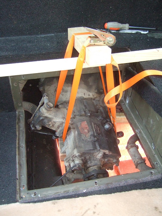

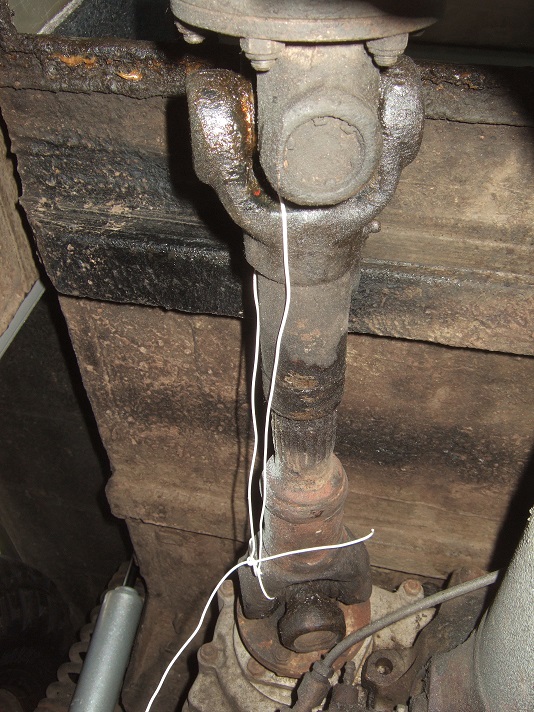

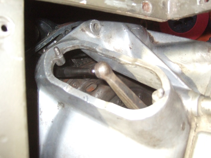

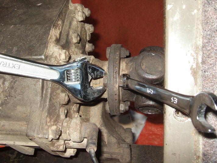

6 - Unscrew the 6 bolts and nuts (size 13) of the cardan-shaft at the gearbox end
7 - Ensure that the wire, holding the cardan-shaft-parts together, is tied off somewhere above, so the cardan-shaft cannot fall all the way down.
8 - If needed; pry the two apart, mine spilt a tablespoon or 2 oil with it, when the cardan-shaft suddenly parted...

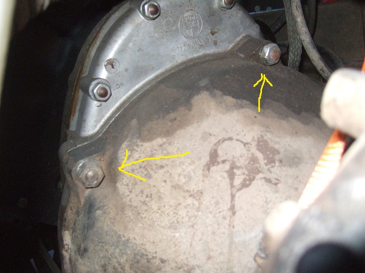

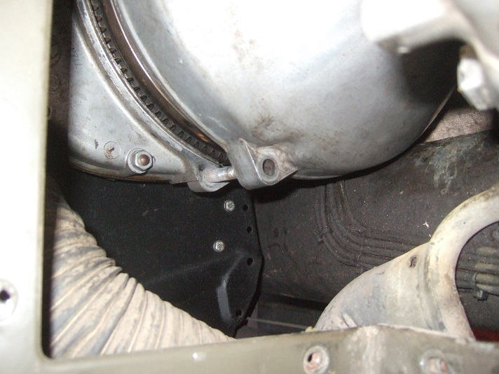

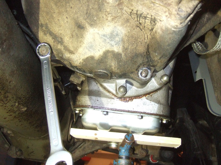

9 - Remove the 4 large (size 17) nuts from the bellhousing, two on bottom... (Ratchet with 17 socket is easier to use , but I just could 't find the 17 socket...
10 - and two size 17 nuts on top...
