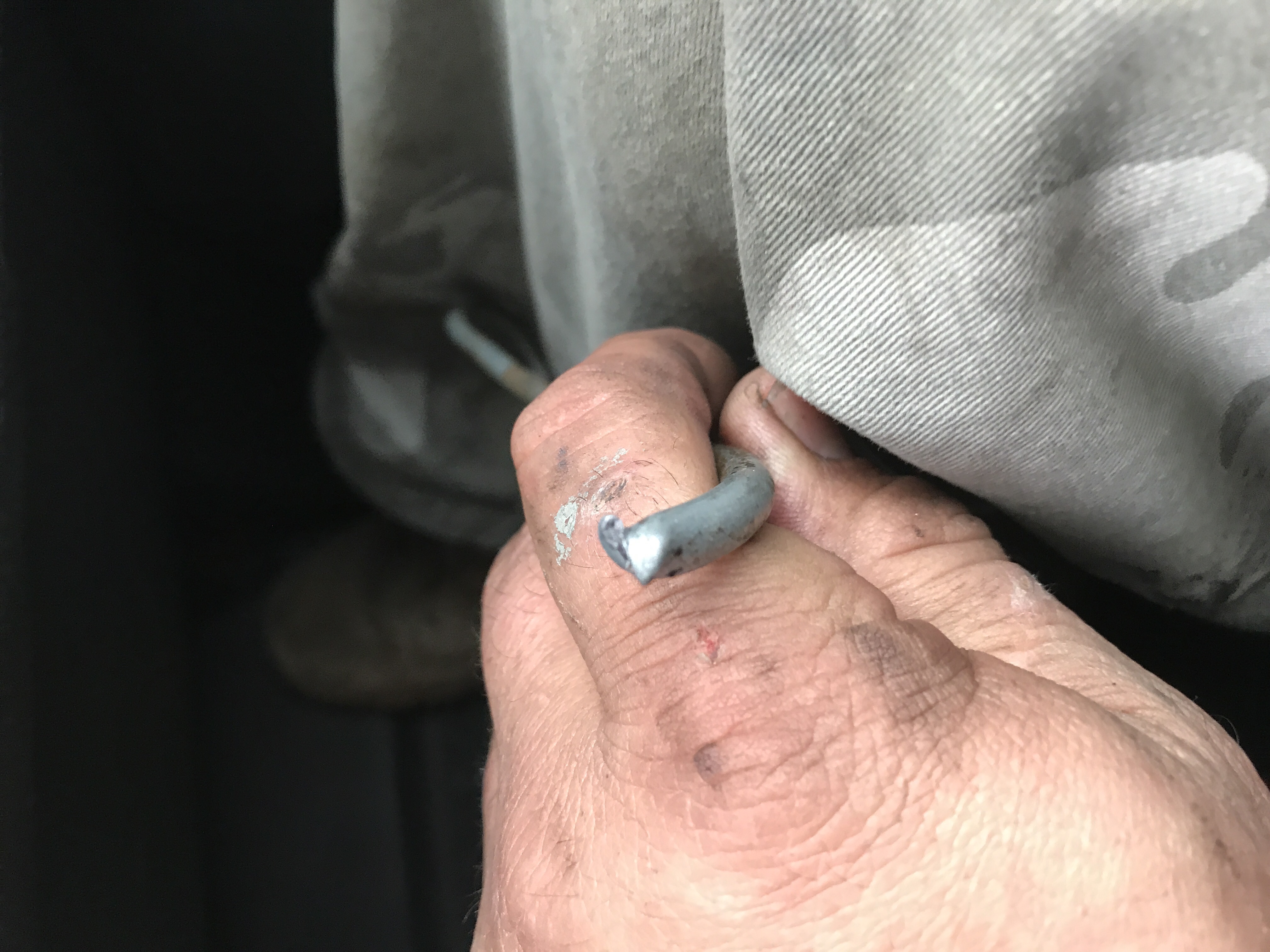

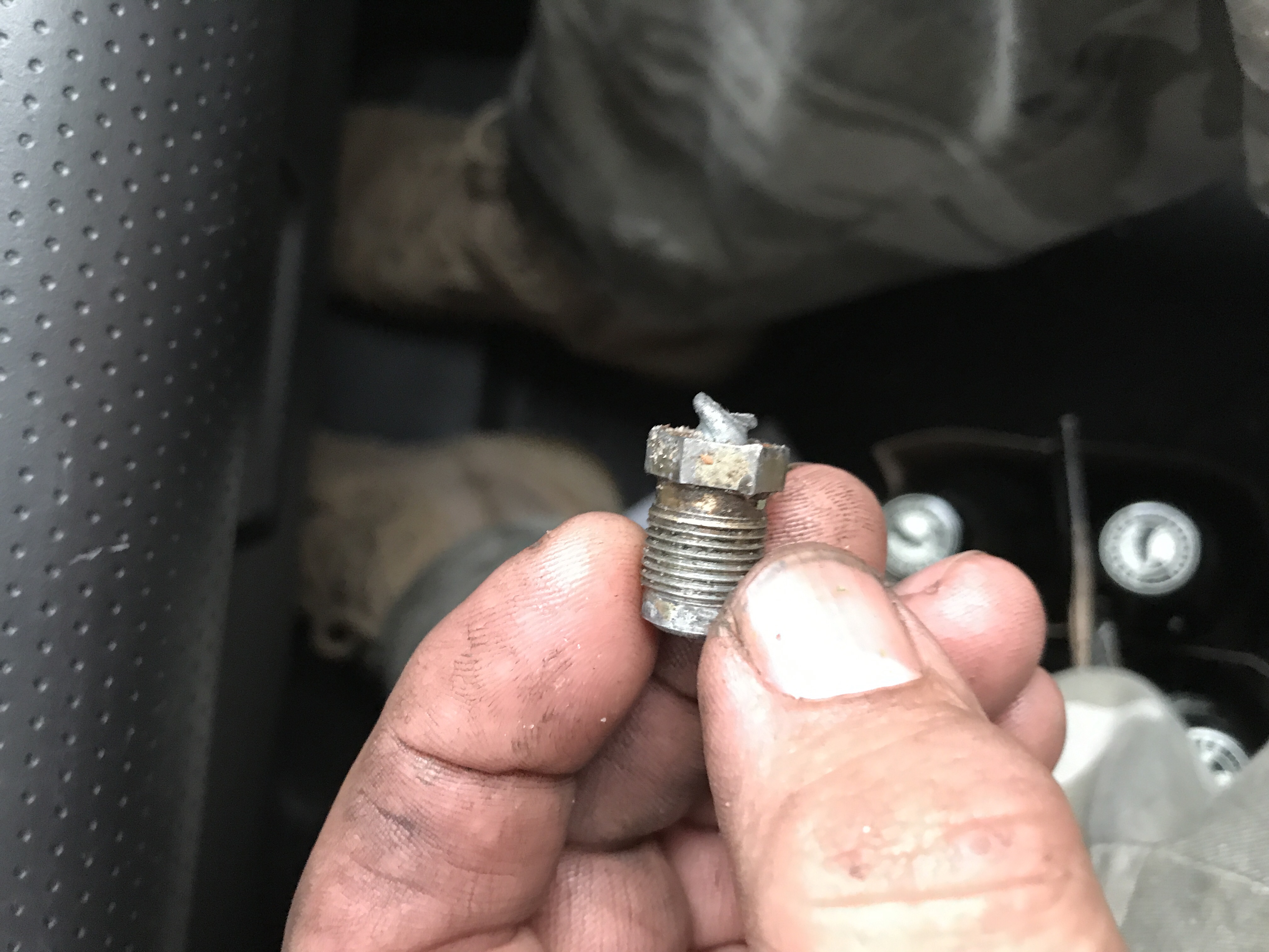

While servicing a customer truck. My help twisted the all wheel drive, steel locker line clean off where it meets the rubber jumpers under the cooling fan tin. due to it being a Saturday after most import places are closed! I need to see if any pin owner is willing to lend me a line to avoid staying in town for 3more days waiting for a part to ship from the house.

Is there enough length to re-flare the end?
Re: Fat Fab in need of assistance.
Posted: Sat Nov 18, 2017 1:33 pm
by Andre
Haf-e wrote:Is there enough length to re-flare the end?
Have you shopped for a 7 mm flaring tool on a sat.? Can't find one plus not enough to reflare.

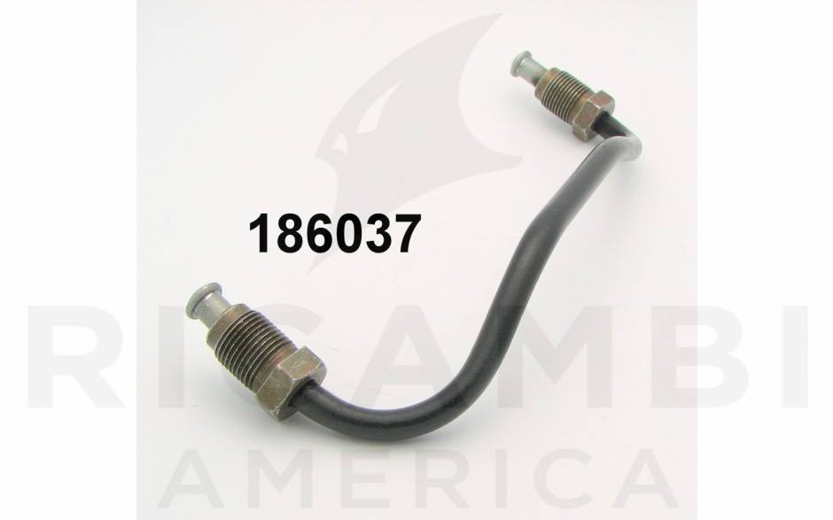

Posted: Sat Nov 18, 2017 8:16 pm
by Jack Russell Racing
Ferrari parts to the rescue !
(Actually, more of a band-aid, but it allowed the truck to get buttoned up for the night. The pipe and fittings shown above are used in Ferrari 360 paddle shifted cars, and something I had in stock back at my office. Naturally the lineage between a Pinzgauer and Ferrari is so obvious...
