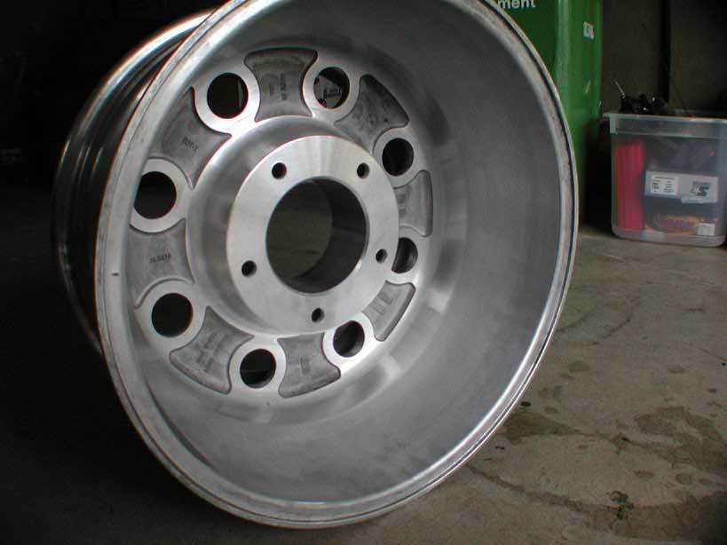

Here is a photo of the inside of the Cepek wheel (this one happens to be a Land Rover 5x165.1mm) showing the interior space. I think it is possible to make the disc brake conversion work for these wheels but would require different disc and brackets than the ones used for the 16 inch wheel:
Cepek Wheel Inside 5x165 LR.jpg (40.04 KiB) Viewed 8315 times

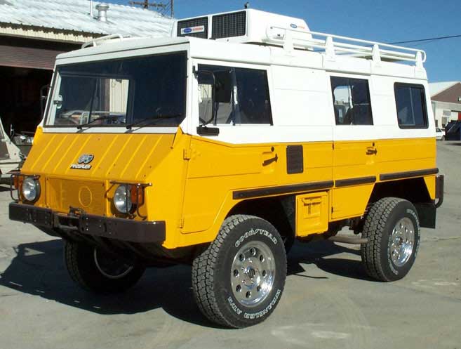

Here is a photo of a Pinz 710K with the Cepek wheels:
Cepek Wheel 710K.jpg (38.47 KiB) Viewed 8315 times

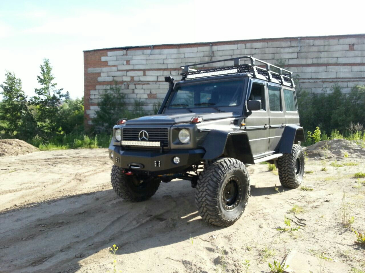

They also offer them in 5x130mm pattern for G-wagens which should work with the existing disc brake conversion kit as this is the same pattern as used on the Sprinter wheels. These are designed for the Tibus portal kits which also require a large backspacing:
Cepek g463-g-wagen-portal-axle-beadlock-wheel-4.jpg (584.92 KiB) Viewed 8315 times

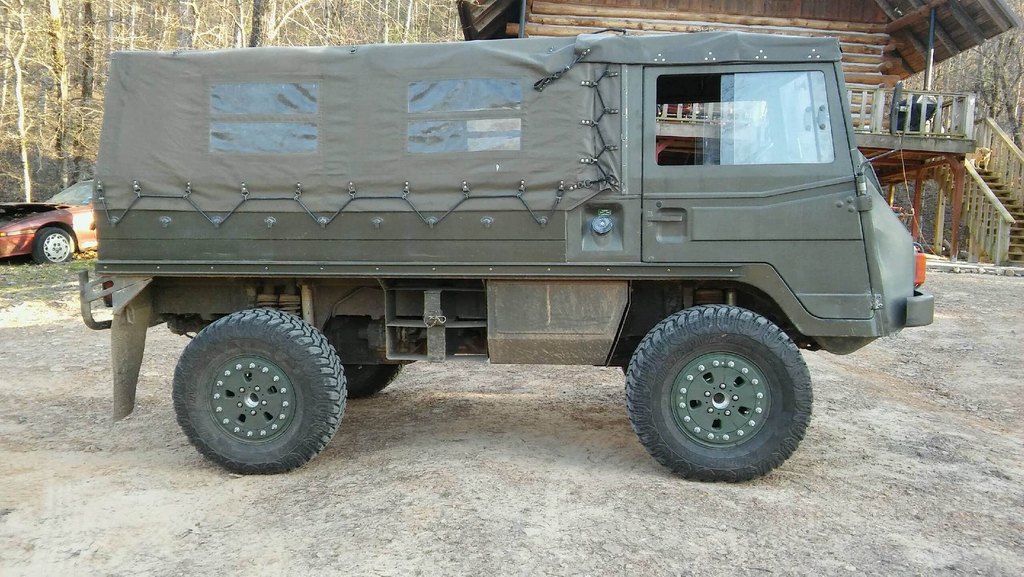

BUT - for this kind of money I would consider the Hutchinson wheels which are true double beadlock wheels and are 16 inch diameter (The Cepek are 17 inch). Here is a photo of one in Oklahoma which has them:
Hutchinson Pinz 710M.JPG (383.51 KiB) Viewed 8314 times
