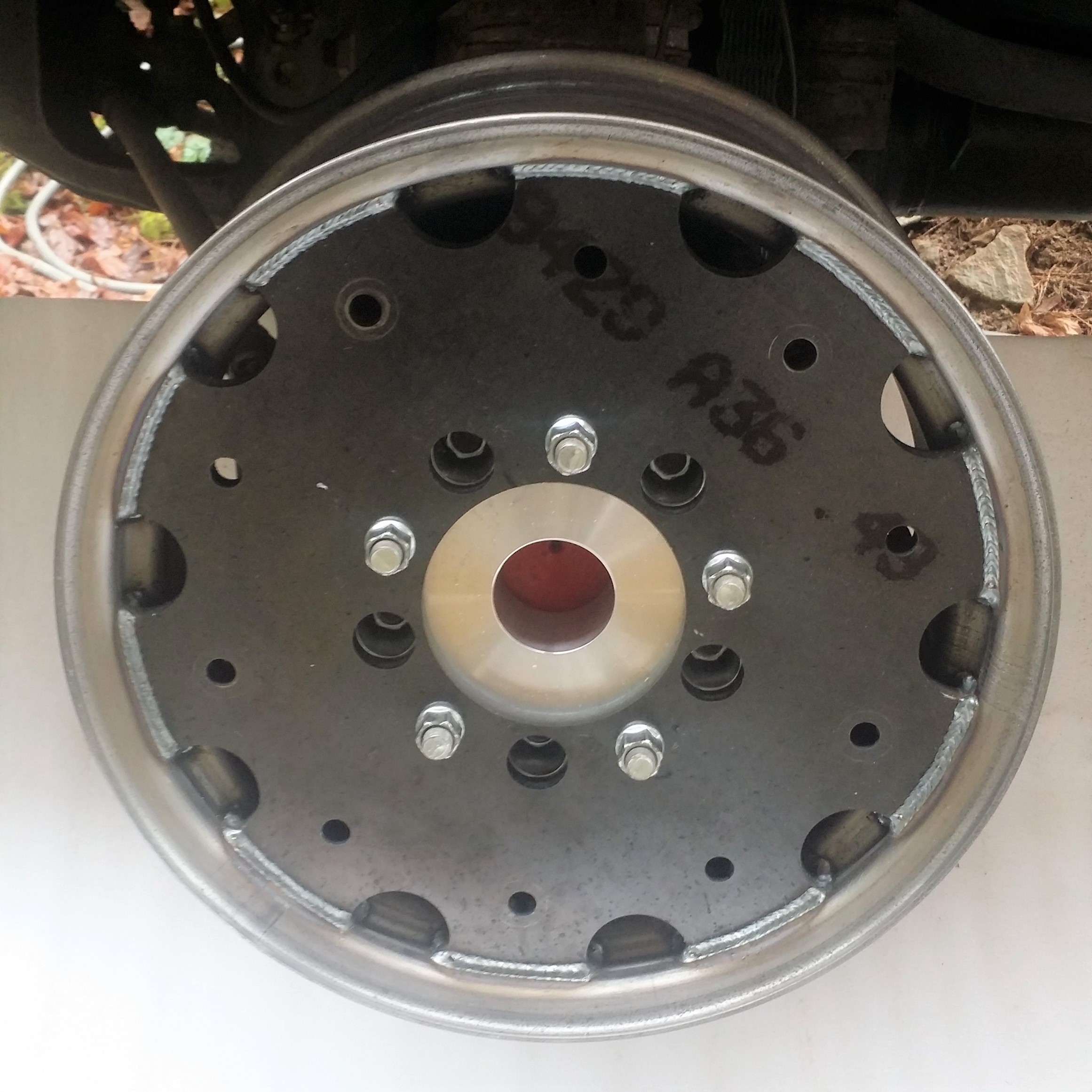

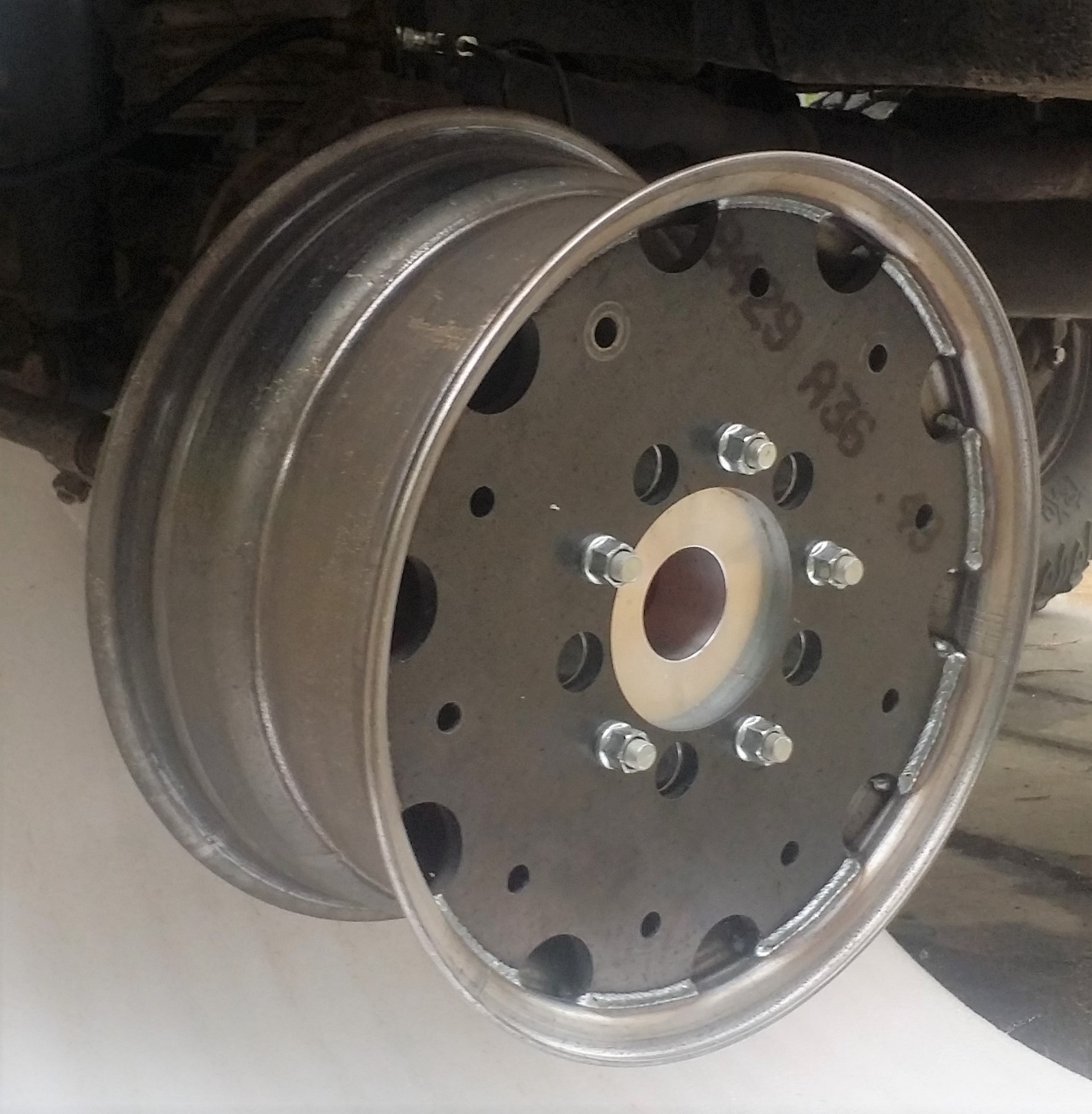

Specs are:
Wheel Shell - Steel 16x8 - 0.157" / 4mm thick with safety bead "humps" - DOT stamped
Wheel Center - laser cut 1/2" thick high strength A36 alloy steel
Bolt Pattern - 5x130 with 84.1mm center hole (hub-centric)
(choice of) - 5x160 with 120mm center hole (lug-centric)
Backspacing - 7.5 inches (requires spacer/adapter or disc brake conversion)
- outer edge of wheel matches the Ford Transit wheels position +50mm / 2" outward from stock position with disc brakes installed
Lug Nuts - 60 degree "Cone" type required

Here are two pictures of the 5x160 lug-centric version:
KW 5x160 straight 14MAR2018 .jpg (783.22 KiB) Viewed 7098 times
KW 5x160 angled 14MAR2018 .jpg (415.84 KiB) Viewed 7098 times
The five holes around the center allow re-torquing of the spacer's nuts with the wheel in place. The spacer is used with the disc brake conversion.
The ten holes around the perimeter are used to press in the center and to hold it true while it is being welded in a fixture. They also can be used to bolt on a sacrificial aluminum "rock ring" to reinforce and protect the wheel's outer edge.
These wheels extend outward the same amount as the Ford Transit wheels with the disc brake conversion - but are 1.5 inches wider. It might be possible to even make a 9 inch wide wheel the same way with 8.5 inches of backspacing - anyone building an iceland / arctic type truck?
Thoughts? Opinions? Too ugly?

Yeah hard to tell without it mounted up. They look really thick and heavy to me... like something Id make a winch plate out of. Why so much metal?
Re: Hyde Ho
Posted: Sat Mar 17, 2018 9:55 am
by Haf-e
These weigh 40 lbs per wheel - the transit wheel weighs 32 lbs but is 6.5 inches vs 8 inches.
The center plate is 22 lbs of steel. I made a set up in 3/8" steel for myself to test out also.
It would be possible to take a few lbs of steel out by adding more cutouts / holes in the plate as well. The current design is pretty minimal as far as cutouts go.

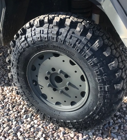

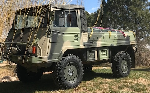

Here are a couple of updated photos of those wheels installed on a Pinz. Also I reweighed them on a better scale and they are 38 lbs vs 32 lbs for the Transit wheel. I don't have a original Pinz wheel on hand to reweigh as a comparison.
Mike Wheels 1 crop.jpg (196.73 KiB) Viewed 6952 times
Mike Pinz 4 crop.jpg (152.31 KiB) Viewed 6952 times
