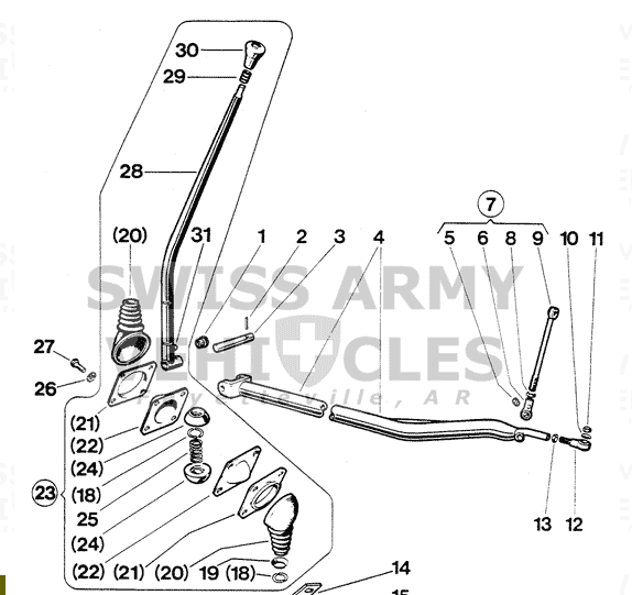

I've never had to take the shift assembly apart myself (yet) to confirm this,
but the assembly diagram section "7-14", shows a retention pin #2, holding
the shift pin #3. If that is not removed that would certainly stymie the
situation.
If removed and the shift pin is still stuck, perhaps disassembly at the
floor board inside the cab might allow you to drop that joint down lower
under the truck for better access with a puller as Lewis suggested.
Screen Shot 2018-07-14 at 7.10.13 AM.png (69.01 KiB) Viewed 3840 times
