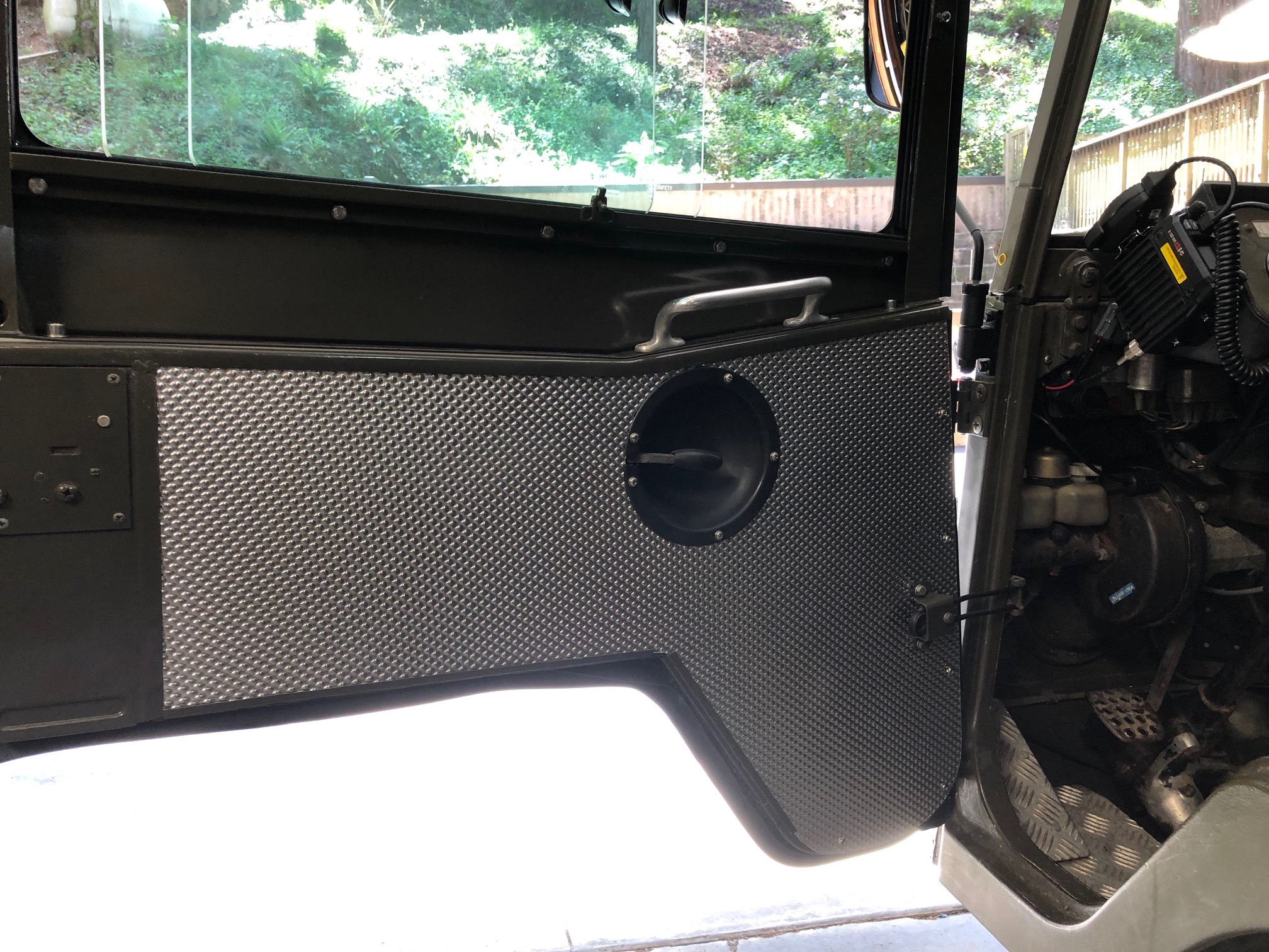

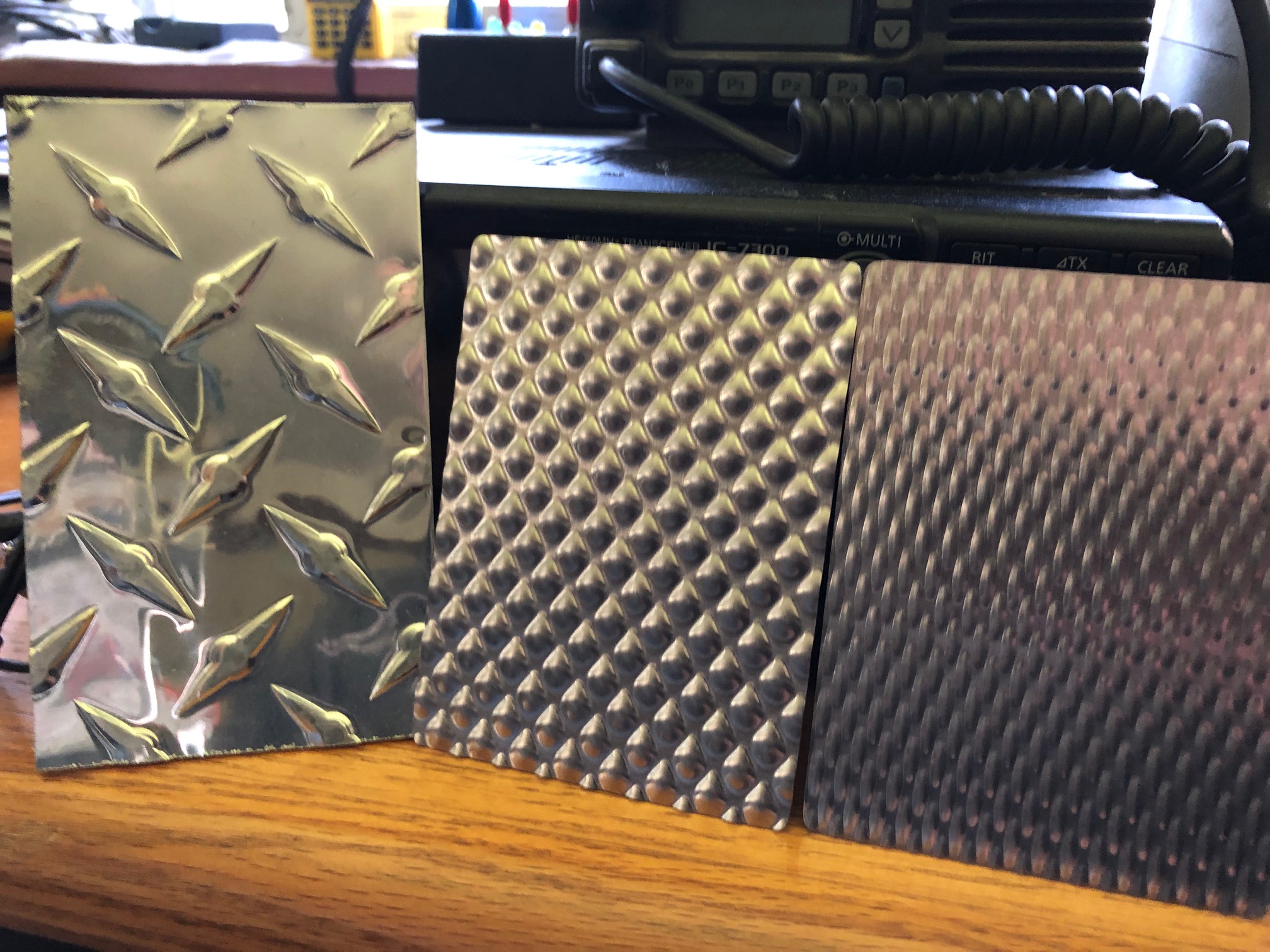

The door panels on my 712 project truck were totally messed up.
Looked around for replacements, most of the metal replacement
panels are cut from Aluminum Diamond plate which I don't like.
Found a source for several different textured Aluminum and SS from
http://xpressmetals.com/ out of upper state NY. Several
interesting patterns, 6WL, 5WL, 2WL, etc, made by Rigidized Metals Corp.
You can request samples. See attached of samples of 5WL and 6WL next
to Diamond plate. I settled on Aluminum, 6WL, 0.063" stock which measures
in the ballpark of 0.09" inc. the raised texture, fits in the channels well. I had to fabricate a template from a plastic sheet, as my original panels were
only good for the barrel. This took time, a lot of patience, and numerous
tweaks and to get right. Once that's done you can flip it over and the template
is good for the opposite door. Cutting and fitting the 6WL panel was not too bad.
IMHO the look is far better than Diamond.

These might be the best looking door panels I've seen.- I like how you went over the door hinge area, instead of cutting around it, I'm thinking of copying your doors, how did you cut the panels? What was the cost of the material?
Re: Custom door panels
Most people that replace the fiberboard panels use the old panel as a template -- unless it's in bad shape.
As such they follow the same cut-outs inc. the hinge area. That is proper for fiberboard material, but if
you are replacing with Steel or Aluminum no need to cut an opening out. The textured aluminum stock
came from Rugidized Metals Corp. N.Y. it ain't cheap. The gauge (or thickness) is BEFORE they run it
through the texturing mill so the dimples will increase the effective thickness. I went with .062", fit
nice in the groves. I had to fab a plastic template as my fiber boards were a mess. I cut the hole using
a drill mounted "nibbler" cutter using a radius arm. The hardest part was drilling holes to match where
the old sheet metal screws went.

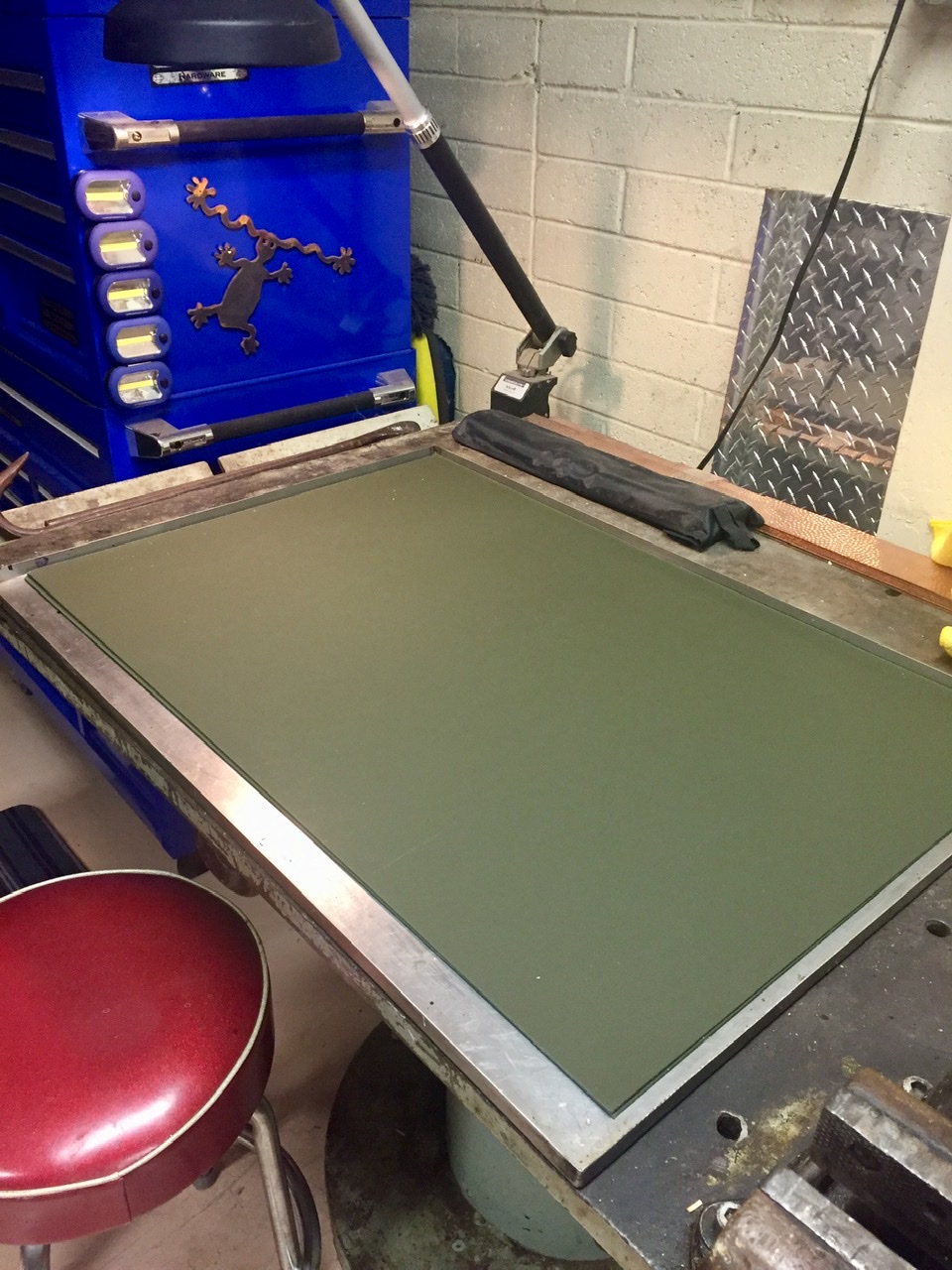

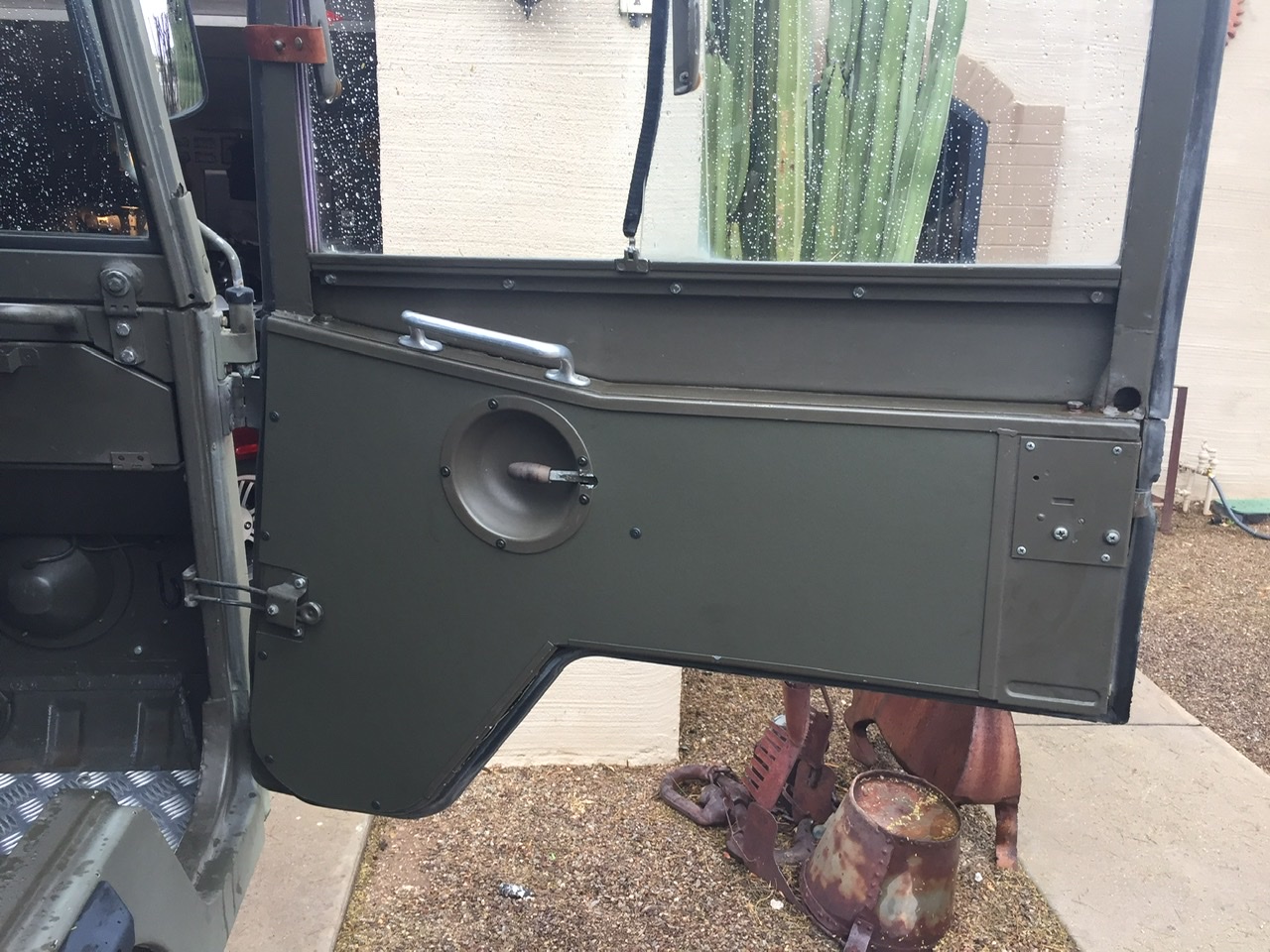

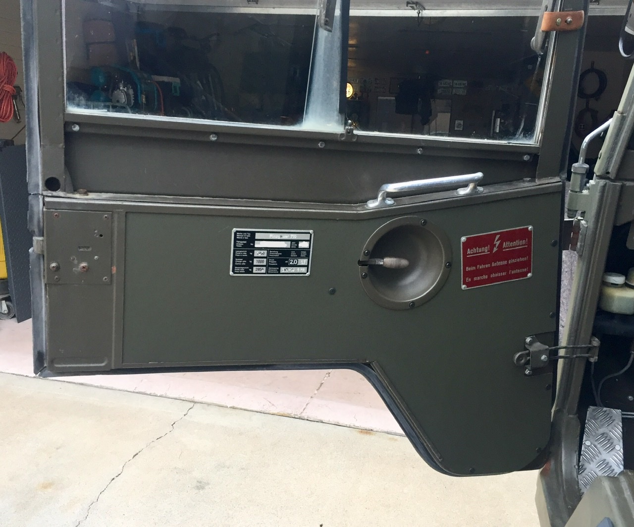

My old truck needed some new door panels. I wanted mine OD green and that left me with OEM, aluminum that I would have to paint, or something else. That something else was .080 thick Kydex T sheet in OD green. I found an online supplier that would ship me partial sheets. 2 x 3 sheets are perfect for a door panel. About $40 each. It’s smooth on one side and textured on the other. I made mine with the textured side out. It’s the heat formable stuff they make holsters and knife sheaths from. It’s easy to work with and can be cut using simple wood working tools. I cut mine using an electric jig saw using my old panels as a pattern.

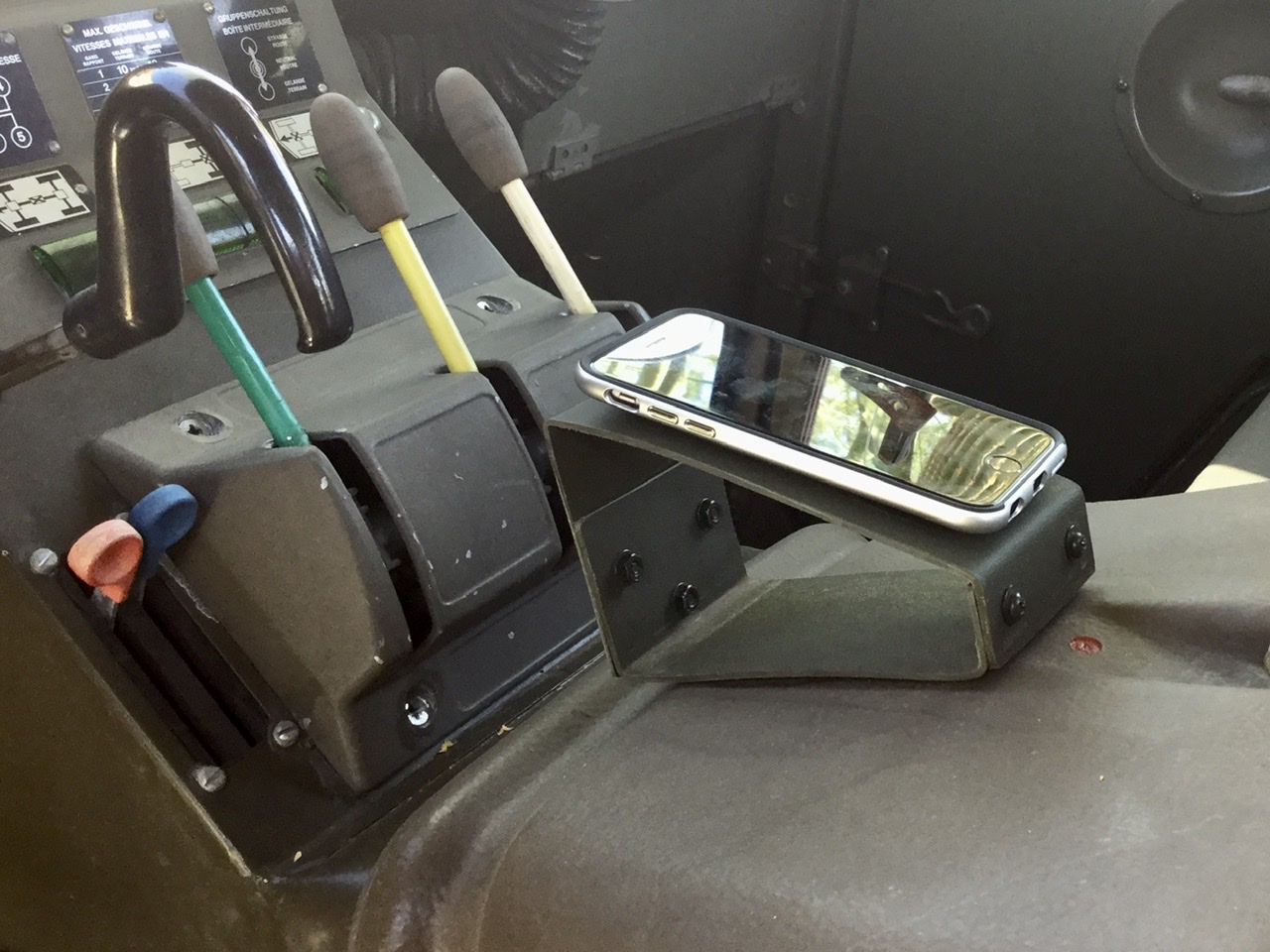

It’s also great stuff to make other things like phone holders and such. Easy to form using a heat gun.

The match is actually better than what is shown in the photos. It’s not perfect but really really good. Good enough for most I think. I’m happy as heck with them.whitesik wrote: Wed Sep 30, 2020 6:55 pm That's a great idea. I just made new ones form hardboard and painted with SAV's spray paint. I will certainly consider this next time. How close is their OD green to Swiss green? There are so many OD greens.
I’m confident I could not get any closer with paint. New paint against old won’t be perfect.
I imagine you could get a sample if needed. It comes in all different colors.
