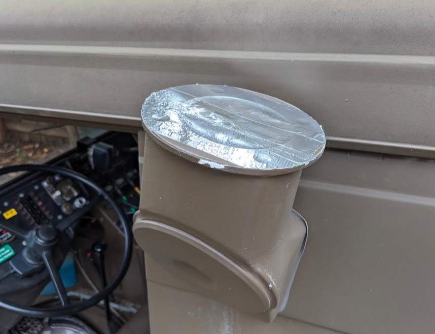

Anyone found a good solution to cap off the 710K antenna mounts? I've covered mine with tape until I can find/make a plate. It's 140mm diameter, with four 10mm holes 115mm center-to-center across (72.5mm from disc center). Ideally, it'd be a black ABS disc or metal.

For now, I'll just fabricate some caps for the mounts (secured with 4plc M10-1.5, 10mm tapped holes) until I can decide if there's more than aesthetic value to the antennas themselves since they are the tallest feature on the truck (read:height constraint). My interest would be ham (W3LX), and mostly 2m operation. Not sure if they'd do any better than a center spike NMO mount in the roof plate, though. That's what I run on the FJ and it does pretty well with the roof ground plane.
Oh, and I have the full antenna setup -- it's just that I pulled them to lower the height and want to cap the holes.

I'll likely just fabricate some either out of ABS or aluminum. If others need them, please PM me and I can see about getting extras made.
