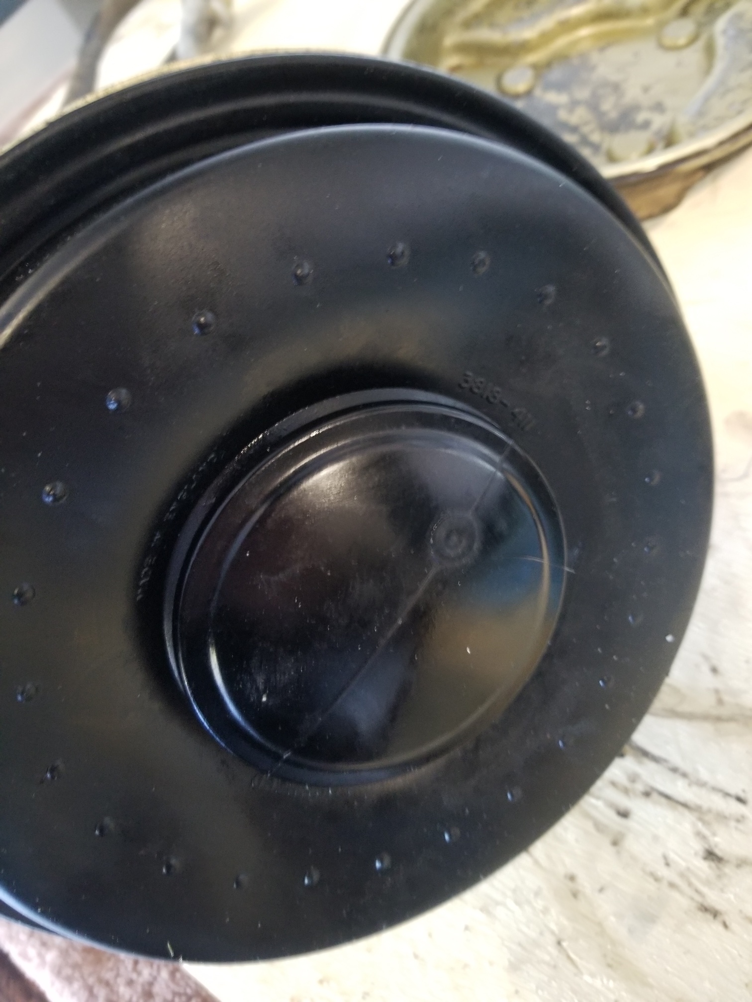

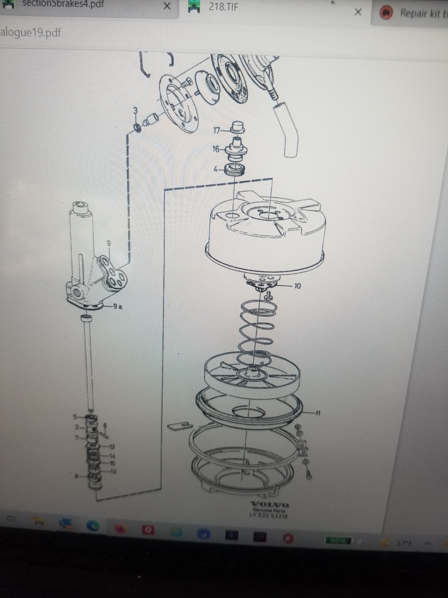

Ok, I removed the upper brake booster, and it was full of brake fluid. Is it safe to assume that, given only one brake reservoir is drained empty, the other brake booster should be fine?
Also, the vacuum membrane looks good, but obviously there's fluid all over, so the shaft, or piston that is filled with brake fluid must be leaking into the vacuum chamber. Hope that the repair kit will have the required parts. Next question is how do I take the darn thing apart without using a sledge hammer (kidding)? Is there a trick? The hard round black disk that is holding up the membrane is firm against the membrane, and both are just spinning, so unscrewing isn't going to work.

Re: Where does my brake fluid go?
You have to pull off the main membrane, then a metal pin approx. 15mm wide will appear in the groove. Lay the brake booster on its side, the cotter pin points downwards, press the siphon lid in very lightly ... lift the whole thing up once and let it fall onto the table with a jerk, then the cotter pin falls out and the lid goes down. It's very easy!
...and make sure that you also change the small o-ring (number 3 in the picture).
