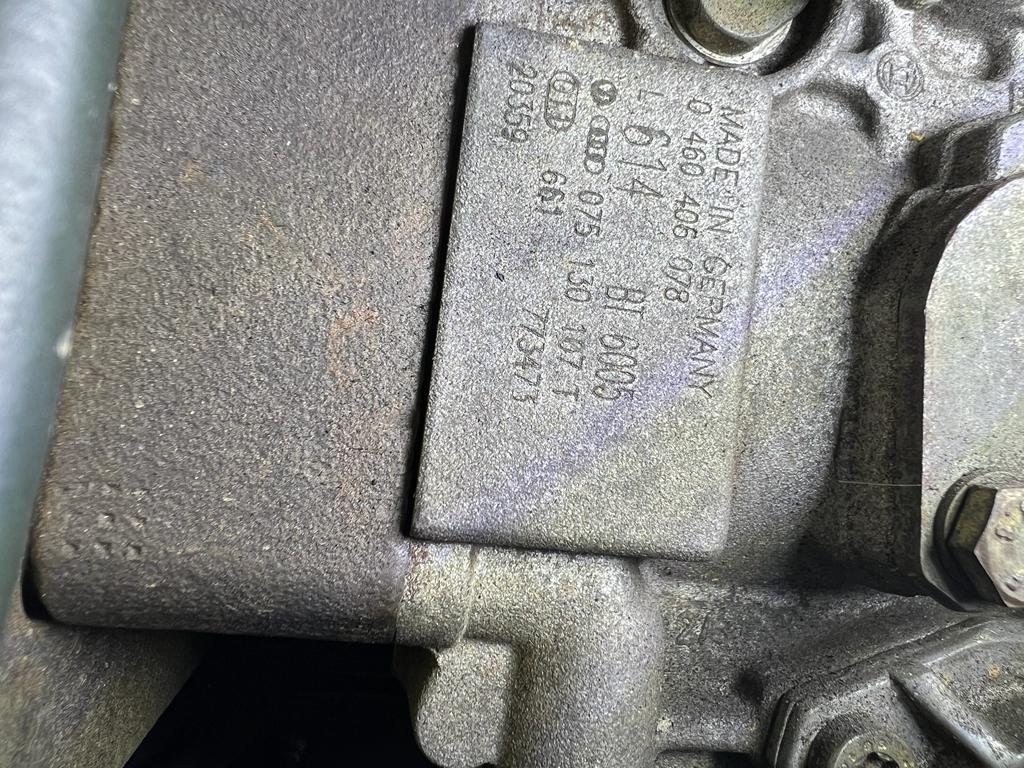

I have spoken to another pump expert and he is suggesting that there is no way the pump could have been rebuilt and tuned properly without the Bosch numbers on the side of the pump. These are missing from my pump. Could anyone enlighten me as to what they should be? He is refusing to look at it unless I give them to him.

Hi, I am from Malaysia
The Fuel Pump is BOSCH VE6/10F2250L614 Type number: 0 460 406 078
I am also looking for the Calibration Chart for this pump to be able to send it for proper calibration since this is exotic.
Attached is the pict I took of my pump.
