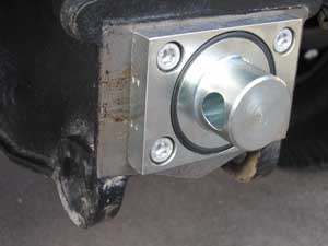

Has anybody had any sucess reducing the height of the towing point and converting to 50mm ball. If so how did you do this?

a flat 12 mm plate of steel with the corresponding 12 mm holes does it nicely..
usea 50 mm ball similar to this one Image

Thanks for your response Albert.
I have never seen a tow bal even similar to that, where did you get it from?
I have fitted the arrangement shown in the picture below but I have not tried it yet as it looks inadequate to me (Paranoia posibly). It was designed for a landrover and I have been told that they are normally braced to the body of the vehicle from the bottom of the plate where the ball is mounted. It is made of 6mm steel with an aproximately 20mm upstand. Any thoughts on this arrangement?

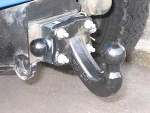

this is the structure I use for towing
The towball is bolted to the baseplate with 4 M12 bolts.
On that pic I have replaced the welded on ring with a revolving shackle.

Watch out for the hole pattern. The 4 bolts on the top are 85 x 45 mm, which allows the use of the revolving shackle designed for Landrover Defenders ( search for Bearmach BA 2682)
The bottom section is 83 x 56 mm which is the standard for 4 hole towing balls.
I used a link to the picture at https://www.kupplung.at/universal-kugel ... =kugelkopf as an example in the previous posting.
The search parameter in the URL tells you what to look for :-)
If you decide to follow the inspiration from my pics I suggest you keep the plate as small as possible to prevent it from dragging when you are offroad. Then measure the position of the trailer side coupling when the trailer is balanced and select the towing ball accordingly.

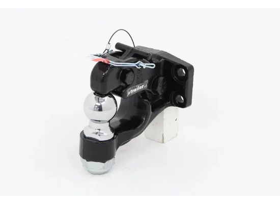

My Arborist just swing my and uses a Ball-Pintle combo hitch.
Kinda cool, don't know if there would be any interference with
the bottom of the door, but I found several options on etrailer.
Don't know about shipping outside the US either but knowing
something exists then the hunt begins :wink:
https://www.etrailer.com/dept-pg-Pintle ... Combo.aspx

the combo unit you mention is sold in Europe by Florian
https://pinzgauer-ersatzteile.webnode.a ... nd-puch-g/

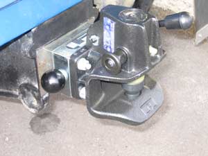

Look here. The are on my 716K.
Best regards
Udo
