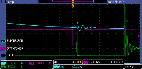

I've wrestled this for a long time, but after instrumenting the engine, I narrowed down the issue. For some reason, I see 130us (approx) interruptions in the power to the Pertronix, as picked by a siamese splice into the green wire at the 6-pin connector into the heat shroud. This short interruption in power seems to occur at consistent timing relative to the "points" opening/closing, but off-cycle. This causes a spike on the TACH signal (low-side of the coil), and causes the tachometer to get excited (bounce).
Adding a BFC (2200uF 50V Al cap) on the power wire appears to remedy the issue.
I can see no clear reason why this brief interruption in power occurs, especially since it's consistent in timing to the spark, relatively consistent duration, and only seems to occur at high RPM, and *seems* more common when the engine is warm-versus-cold. I'm open to ideas. Remember, this is the 24V bus power from the 6-pin connector, so not affected by the rev limiter which is on the coil power side.

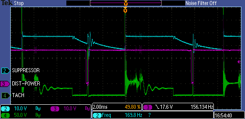

Some of the ringing is inherent in the probing challenges. There's a fair bit of electrical noise, and most grounds gave similar results.
The 24->1->24V pulse is only present without the large cap -- adding the cap prevents it, and there isn't any obvious sign of it then. FWIW, I chose 2.2MF because that's what was on top of the bin with large caps.
The pulse width is the real head-scratcher, as it's pretty consistent (though not exact) at around 130uS. And the edges are pretty clean, not like a wire coming loose. And it seems pretty legit because the low-side of the coil bounces up, and the output of the suppressor bounces up as would be expected when the "points" open. The Pertronix module doesn't find the loss of power very funny, and as expected, opens the output.

Oh, OK, although a different time-base I thought the
2'nd panel was W/ the capacitor -- that's why my
comment w.r.t. potential high current and no reason
for it. So, the cap did the trick good. Still, that pulse
makes no sense.
