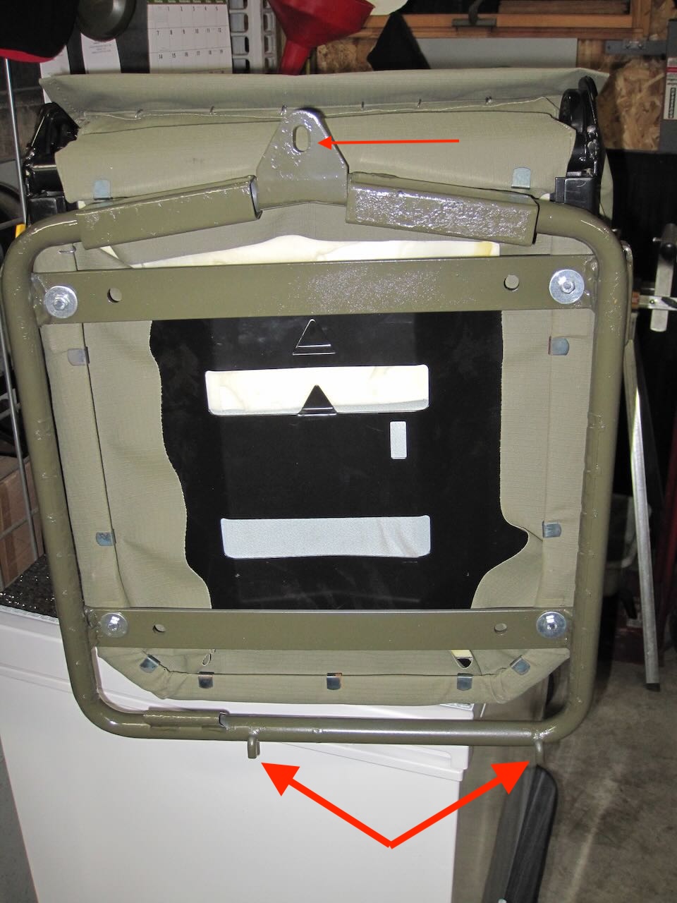

The front passenger seat should have a steel frame fastened to the bottom. The frame has 2 hooks in the front that engage the metal stand-offs welded to the chassis under the seat. The frame has a hole at the rear that sits on another metal stand-off that has a threaded hole in it for a wing bolt.

I was asking about what’s within the frame. I see yours has to pieces of flat steal welded in( four shiny bolts with washers and four unused holes). Did you weld those in for your seats?
The middle of the seat is my concern.
Re: Seats
Posted: Tue Feb 25, 2025 7:41 pm
by pcolette
Yes, the flat bars were welded in for mounting aftermarket seats. My original frames had the factory upgraded bottom seat cushions which have a plywood board with clips that snap over the frame tubing. I really don't remember how the original seat bottoms were secured to the frame.

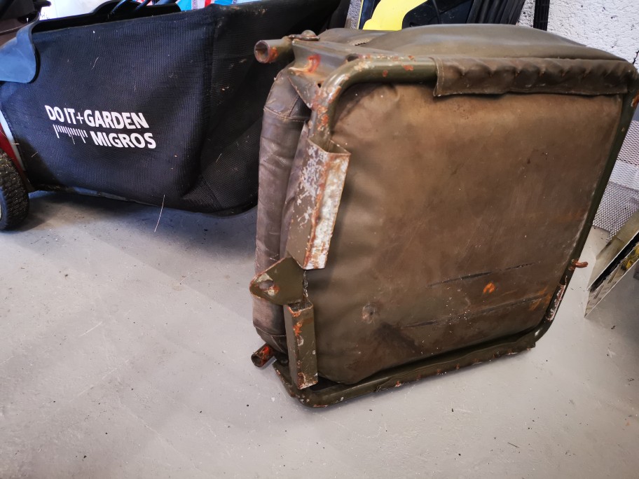

This is my passenger seat on my 710M

Re: Seats
Posted: Mon Mar 03, 2025 12:57 pm
by Hugues
rollingpinz wrote: Sun Mar 02, 2025 9:18 pm That’s what my seat is like.
Do you get complaints from your passenger? When I sit there, I can feel the edge of the engine cover and it makes me lean to the right.
Maybe there’s something wrong with my seat. It was reupholstered by a previous owner and something might have been done incorrectly.
My wife rarely rides with me :D
I sat there a couple of times while working, can't remember any difference between driver and passenger seat,
