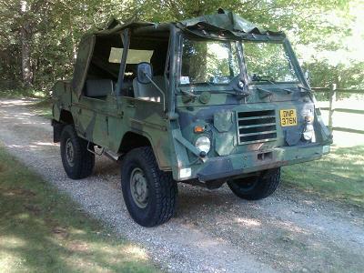

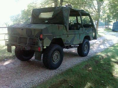

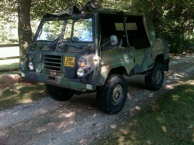

Mark, thanks for the real answer! The only thing throwing me off was the warning on the cap, if I do ever run in to the need to change the radiator, that sounds like a good idea! The old coolant didn't look so bad coming out, but it is changed and good to go for a while! Here are a couple pictures of "Hilda" with new tires installed today. Thanks!

Nice!

Damn nice little unit.
I like but the polis here would pull you over for the paint job :(
put some videos up of it offroad - or a link to youtube action :) please.
