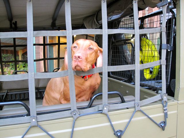

A few photos of them in use:
My canine containment system - my dog jumped out once too often.

I found the cargo net here: http://www.sportsmansguide.com/net/cb/m ... x?a=683649
Had to do some cutting and sewing but one net did both sides and the back on a 710.

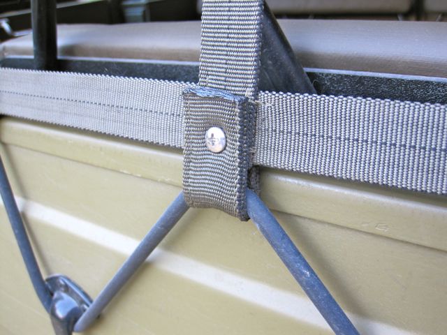

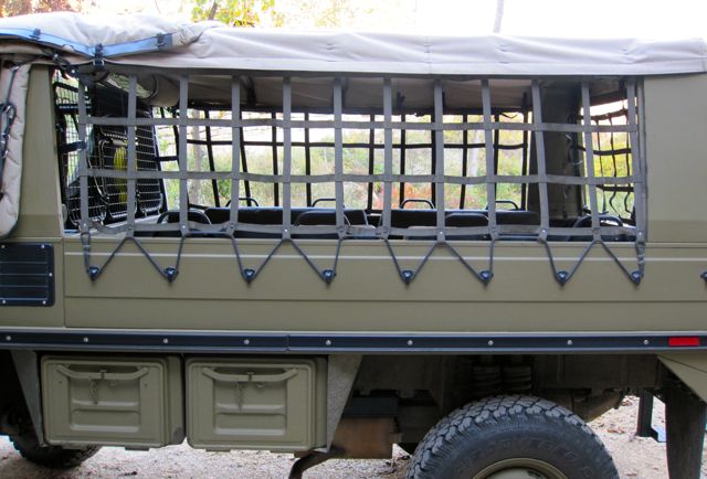

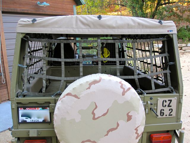

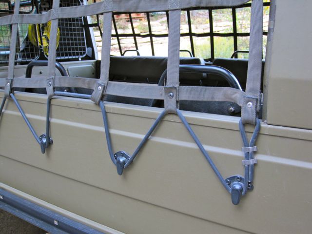

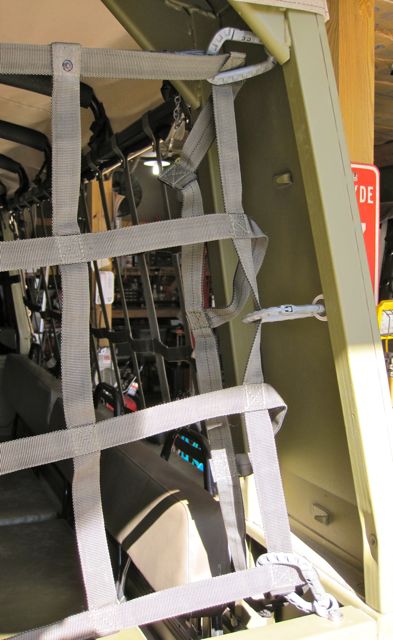

More photos of the dog/kid/? containment net:

Net details:
After cutting the net, use a lighter to melt/fuse the cut end so it doesn't unravel. I used a pliers type leather punch to make holes in the nylon webbing and then used a soldering iron to seal the edges of the hole. If you use the soldering iron to make the hole it builds up a ridge of hardened plastic around the hole which makes it hard to bolt or rivet together. On the side panels I used bolts and nuts but then switched to 3/16" rivets with a washer on the rear. I can't really say one is better over the other - personal choice.
The cargo net comes with ~ 3' nylon tie-downs on each corner which I cut up to make the loops for the rubber cord.
Any questions, let me know.
