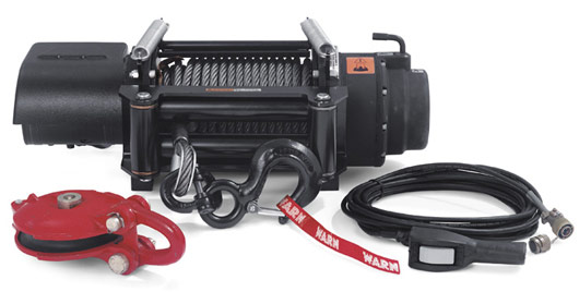

I have a Warn 24v Severe Duty 18k Winch that I am considering mounting on my 712 AMB-S. It weighs in a 175lbs as it is currently set up with 1/2"x75' EIPS (steel cable) and roller fairhead. I am afraid that it may be too much weight hanging off the front of the vehicle (front end sag) especially when I add a nice tubular bumper set up.
I have looked through many of the photos and specs of the other Pinzgauer owners and it seems that most perople running winches have 8k-10k models. Are most running the smaller models because of front end weight? A typical 8k-10k Warn with steel cable will weigh in at 85-95 lbs?
As I understand the rule-of-thumb minimum for winch selection is to take your GVW (Gross Vehicle Weight) and multiply it by 1.5. My Pinzgauer AMB-S 712 weighs approx 5500 lbs and has a cargo capacity of approximately 3000 lbs. GVW is then approx 8500 lbs
Based upon the figures above, I would be looking at a winch with a minimum pulling power of 12750 lbs. The 18k is quite a bit more than that but I suspect more is better than not enough as long as the weight does not get carried away.
I can cut weight on my 18k by changing out the EIPS to a synthetic rope and the roller fairhead to an aluminum hawse type. This will save approx 65 lbs and make the overall weight in the range of 110 lbs.
Long story (sorry) short, is the 175 lbs winch too heavy for my 712? If so does the extra cost of replacing the cable with rope, etc and saving 65 lbs make a big enough difference to making the 18k Warn usable?
Comments/suggestions are welcome.

- severe-duty-18-winch.jpg (28.95 KiB) Viewed 9534 times

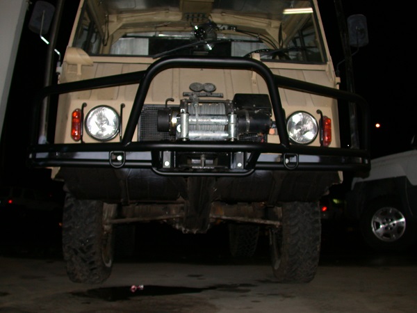

Here's a bumper I built a few years ago for a Heavy duty winch.
- steve (2)resized..jpg (81.8 KiB) Viewed 8916 times
