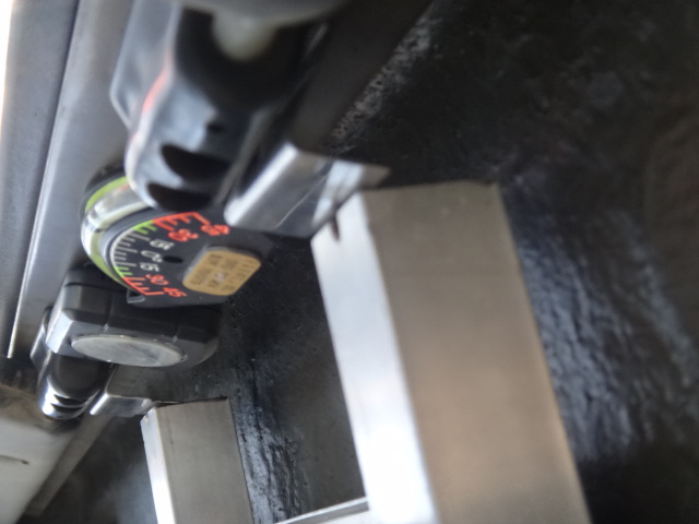

I took some 1" square aluminum tube that was bent to fit the contour of the roof (the bends are ugly, but that's how they came out from the brake press); the rear ends are hinged to the rollbar. This way the whole assembly can hinge downward so I can get to the wiring above. I used some springy stainless sheet and cut out "clips" that mounted behind the visor ends; they spring forward as the bars rise until the clips pop back into the top edge of the inside of the tube. To release, I put a notch in the lower edge of the tube so I can insert a screwdriver to pry the clip forward. I have some foam above the tubes that give the assembly some push downward to prevent rattles. The wiring hinges neatly as well when it is lowered; the tubes almost brush the edge of the doghouse cover when down.

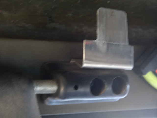

Closeup of the clips, and how they fit into the tube. Note notch on bottom edge of tube to get the clips released:

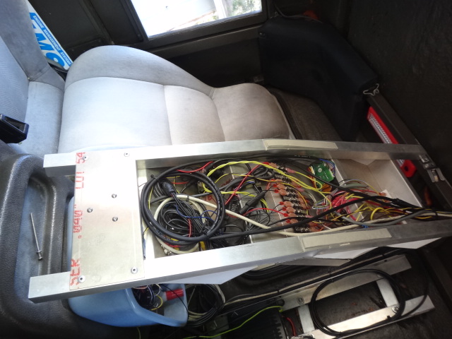

And when hinged open it is easy to wire. Note the double headed nail that I use to unclip the clips (the nail fits into a clip at the back of the console where it is always available; you can just see the double heads above the circuit breakers in the first photo):

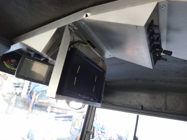

I finally decided to get some of the stuff off the dash area, plus I had a new backup camera monitor to mount. I fabricated a box for the monitor and hinged it to fit under the switch bay; then in front of that is my 6 channel tire pressure monitoring display and GPS in the front:
The monitor box is held up with strong magnets; one in the box, one inside the switch bay. The monitor hinges down like this"
I closed in the sides of the bays with 1/4" thick craft foam, cut it barely oversized and just stuffed it into the openings. It does clean up the look.
The tire pressure monitoring system is 12V only, so I've run power up from my converter for it an any possible other 12V needs. The GPS and monitor can run from 24V but they are powered/protected by the third circuit breaker switch.
And it still hinges down to make wiring easier.
