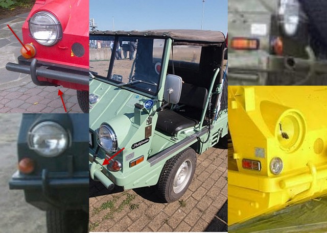

Can anyone confirm if one is right and one is wrong or if both are right and just different 'options'??
V1: 1st pic is of my 71 Pathfinder Hafi with a short style 'bumperette' and it is bolted flat under the bottom of the front
V2: 2nd pic is also of a 71 Pathfinder Hafi with long 'bumperette' and it is bolted so the end goes into the front much higher
I have looked around and there is a mix it seems and I am not sure why?

This is all just for interest sake but here are a bunch of the "V1" bumpers like I have on mine.
I am wondering if the US DOT requestest the square hollow mount so there was some "give"/crumple to the bumper (even though it is only 1")??
The mount is also directly behind the bumperette vs far to the side like on the "V2" bumper.

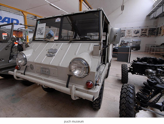

I also found a pic of the NA Pathfinder in the Puch Museum - it has the V1 bumper and mount...hhmmm... :idea:
You would assume they would have a pretty original one but who knows!!

The bumper which is shown e.g. in the picture with the red Haflinger and in the pictures from the Puch Museum is a younger version. The other bumper style is an older version, which was also used on some other civilian Haflinger versions e.g. in Europe.
It appears to me that Pathfinder marked 3/71 on the compliance plate have the older style bumper, while Pathfinders with younger dates on the compliance plate have the younger bumper type. I don't know for which reason the bumper was changed, but maybe it was a problem that the older bumper was partially in front of the headlights.
The younger bumper is, as far as I know, unique for Pathfinder models. I haven't seen it on other Haflinger versions.
By the way... the Pathfinder at the Puch Museum was never exported to USA. There exist quite a lot of such Haflingers in Europe. It appears that a batch of Pathfinders was not sold to USA any more in 1972.

In my 1st post the red haflinger is marked 12/71
The tan one is marked 3/71
So if I follow what your saying 3/71 and older have the larger bumperettes ('older' version)
And anything marked 4/71 and newer should have the smaller bumperettes ('younger' version)
Makes sense

yes, this sounds correct to me, except that I haven't ever seen 4/71 so far. It appears that the next younger ones after the 3/71 are 10/71, 11/71 and 12/71. Then comes 4/72, but these vehicles already mix up with Haflingers which stayed "at home" for local sale.
