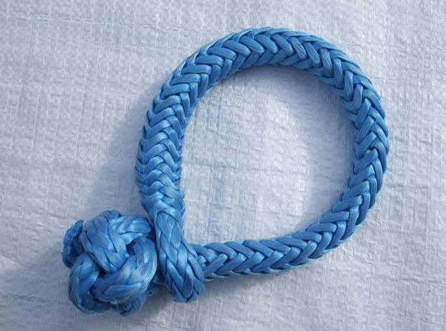

I am going to be making some soft shackles for the Hafi and Pinz.
Just ordering the Amsteel Blue synth line now but was wondering if anyone on this board had used them.
They get great reviews on other boards and like synth winch line they remove the broken steel shackle projectile issue (plus they float and weight 1/10 of a steel shackle).
I figure if I use 1/2" Amsteel I will have a shackle rated with a failure of about 30,000+lbs and a WLL of about 10,000+
So I will probably order 5/8th a few more tons of rating :)
7-8-2013 1-06-07 PM.jpg (65.22 KiB) Viewed 11598 times

Looks like they use 5/8"
I just think it would be good to make them so I know how to fix them, re-splice synth winch lines and it is a simple process.
Will go with much smaller line for the Hafi obviously :mrgreen:
Any reduction in this danger is wonderful. But don't be overly confident and assume there's zero danger.
Remember that anything else involved needs to be similarly safe. That big red hook in your second photo could probably do some damage in the event your shackle and/or the vehicle itself failed. A fellow in Wisconsin died a couple years ago when something ripped off the truck he was towing and hit him.
I've been knocked a$$ over teakettle once by a flying chain, and it weren't no fun at all...

I could be wrong but if you had a synthetic rope on each side of that red shackle then it would not go flying far if at all since synthetic lines do not go flying like metal chain/cable can.

There is way less kenetic energy build up in a synthetic line over a static chain/shackle. The "explosive" force of a link releasing is bad, bad, bad.
That being said, a soft shackle failing where the "monkey fist" meets the spliced loop would still pack a ton of force, and should be treated like a lit M80 when under load.

I would try to get rid of all (most) steel - so the hook was just for showing how shackle works.
I agree with Cascade esp since that is exactly where the soft shackles fail (but at 20-35,000+++ lbs avg failure you are much safer vs a similar sized steel shackle and won't become a deadly projectile!)
Cheers - will post some photos of progress once I get started
