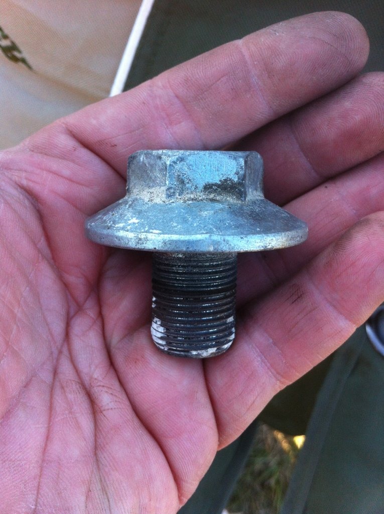

Bit of an urgent request. After our trail ride, Mead had some issues with his truck. Long story short, the bolt that holds the crank pulley in is gone and the pulley backed out about 2 inches. Anyone know the size of the bolt?

BOLT CRANKSHAFT PULLEY 7121021061/ 01-05-01
M20x1,5
The bolt appears to be special with a washer as part of the head. $40.35 for a new bolt ! :shock: Used is $19.50.

Thanks!!
After many sightings on the road, the elusive bolt was found in the road!!!
