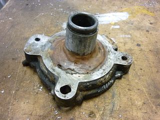

I haven't really posted much about my 718 but like most Malaysian Pinzgauers it required a massive ammount of work to get it back to anything even resembling a running vehicle let alone fully rebuilding it (alongside a donor vehicle......this is all to do with Australian Compliance/Registration) like I am, and converting it from an M to a K.
I've pretty much completed most of the rear driveline (although I haven't completed the portal hubs etc) but some time ago I decided to concentrate on the platform/body as my panel beater/painter is threatening to sell-up/retire in the near future so I want to get it to him and completed before he does so and also as it will be at his place for quite a while I can finish the chassis etc whilst the body is been sprayed
Most of the panels are made, although at the moment nearly all are temporarily held in place with Clecos, Wedgelocks and Peanuts....I hope to have a big "Spot Welding" weekend in a month or so :D
The ex Malaysian Pinny as I brought it....Generally
Hauling it into my workshop with my 712
Removing the body/platform
The interior condition of the backbone.
These teeth are typical of the condition of the transfer box.
Even the roller bearings had been "repaired" at some stage in it's previous life.

Thanks guys for all the kind words, but it's a relatively easy/joyful task when ones passions encompass everything that is involved in the rebuild.....Pinzgauer's, workshops, tools & machines, metalwork etc, etc.
Some say I spend WAY TOO MUCH time in the workshop but I'm afflicted , a fanatic! :-) .....what can I say :-)
...........or as a friend of mine says, I'm "focused".
Now that the bulk of the panels are made, I have to finish many of the smaller "detailing" tasks before I start welding all the panels in place.
I also now have a replacement transfer case and I have cleaned and painted the case as well as purchased replacement bearings etc, so as soon as the body is ready to go to the painter I'll get onto it.
I'll post more pics etc as work progresses.
