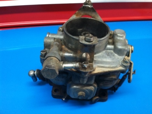

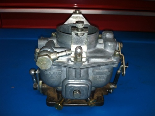

So I dedicated a few weekend hours to rebuilding my Zenith 32NDIX today. When I got my Hafi, the carb was loading up badly when the throttle was pressed. You could see fuel pour into the right side throat, and none in the left side.
So..
Disassembled, soaked all metal parts in a parts cleaner bath (20 mins per dip) and brushed and reassembled.
Used the Hafi NDIX rebuild kit sold by SAV, for what it's worth.
Things came apart OK, and went back as before. Bowls were a mess.
It's all clean now.
Before;
After;

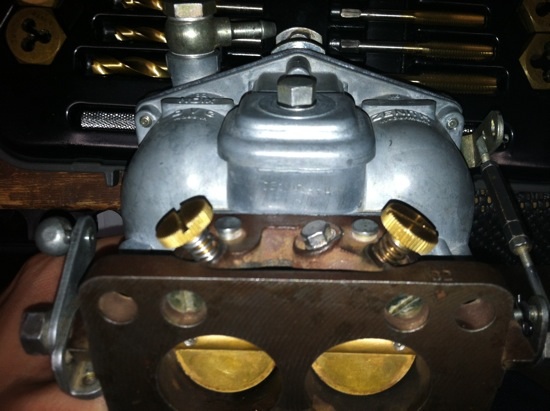

So here is my problem;
The carb had a mystery left volume control screw installed. Upon review, it looks like a Solex screw.
I have 2 new and correct volume control screws now.. and they were the last pieces installed.
Right side went in just fine, but the left side was apparently damaged by the incorrect threads on the bodge-job Solex screw. The new unit will NOT screw in.
Do you folks think a tap with the correct thread size (if you know this, please tell me) will do it, or do i need to Helicoil the thing to do it properly?

Jim, I noticed the same thing. I made a mild attempt with no luck on reassembly.
The threads are just too bunged up. I need to bring the base into my shop and tap it. I'm nervous, though, since the end tapers. I figure I just need a few threads to hold the screw, since the spring tension will keep is stable.
Also, the angle is key too, I don't want the screw to bottom out at a bad angle and let to much/little volume pass.
Ug.

Well.. After a frustrating trip to my local hardware emporium, I have to ask..
Does anyone know the size of the volume control screw on the carb?
I tried to measure it, and it appears to be an M5, but the threads are a mystery..
They do NOT appear to be 0.80. They appear to be a coarser thread/less thread per cm.
Does anyone know the thread gauge on these things?
I need to get this exact, since I'm going to threadchase the hole in the base (if the correct tap is even available).
Any help would be SOOOO appreciated.

Posted: Wed Sep 04, 2013 10:29 pm
by cascade.king
Success!
M5 x .9 is correct for the screw.
Got a cheap (but not TOO cheap) tap and chased the threads. The hole was really cross threaded, so I had to plunge the tap in a far as I could without bottoming out.
Please keep in mind that I did this with the base removed from the rest of the carb, so I could blow out the shavings.
Thanks to ALL who added info/input on this one.
I did NOT want to source a new part.
