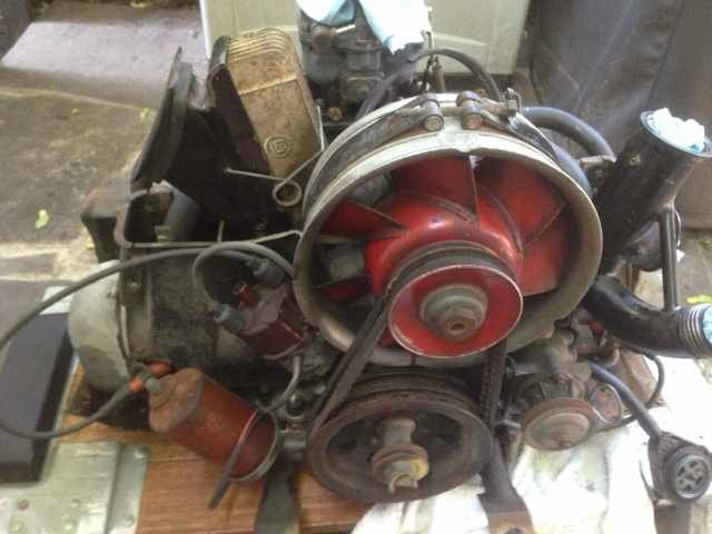

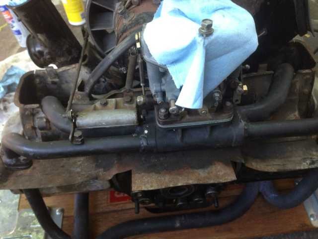

So every time I go to work on some thing 2-3+ new jobs come up and so now my Hafi is in many pieces and the Engine is semi disassembled (tin, manifolds and dyna etc).
So I figure I may as well start a thread to post pictures and progress as I go so it is all in one place.
I am no mechanic and no where near a body guy, this will just document things as I go.
The end goal is to have a mechanically solid Hafi (pretty much there thanks to all the work Jim L did to it after I purchased it (minor engine work, rebuilt tranny, rebuilt brakes etc etc) and one that looks original but still used (not used as in 1970's 'old' (that is what it looks like now :)) but just like it gets used for what it was meant to be used for but is only a few years old (not sure that makes any sense :)).
It will not be a frame off restoration or anything close to that but just a heavy cleaning so I can hopefully get it back on the road and useable as soon as possible.
Here is what I worked on today:
Hard to see the 1/4"+ thick mud and oil all over the tin!

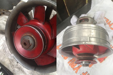

Haflinger - Fan.jpg (39.18 KiB) Viewed 14445 times

Wow the engine is nasty!
Still not done - I feel like once I fire it up oil is going to spray from every seal - not sure how so much oil got all over it!!
As for powder coating: thought about the Eastwood home kit but I may just spray tin with a 2 part black semi-gloss.
At least you will be able to find the leaks now!
What are you using to clean it?
I'm doing the same thing, but mine is so junked up I have a mind to attack it with brake cleaner/carb cleaner just to get some of the crud off..
I have been scrubbing with a brass "toothbrush" and all I do is spend dime trying to clean the crap out of the brush.
Simple Green ain't cutting it.
Posted: Tue Sep 03, 2013 10:57 am

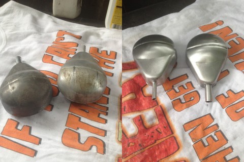

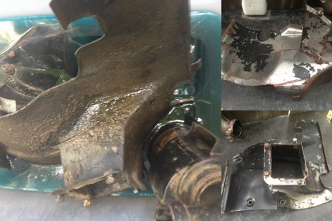

For the tin I soaked it in parts cleaner
For engine and other parts I can't submerge I started with a plastic scraper, then moved to a stiff nylon brush and shop vac (all the big thick stuff), then a brass brush and various tooth brushes (filed down to different sizes) and a pile of rags.
To clean, I sealed everything that I did not want cleaner to get on or in and I used Eastwoods PRE cleaner - similar to brake cleaner but it leaves no residue.
It is good you are doing yours too - as I am sure I will forget how to put mine back together :mrgreen:
